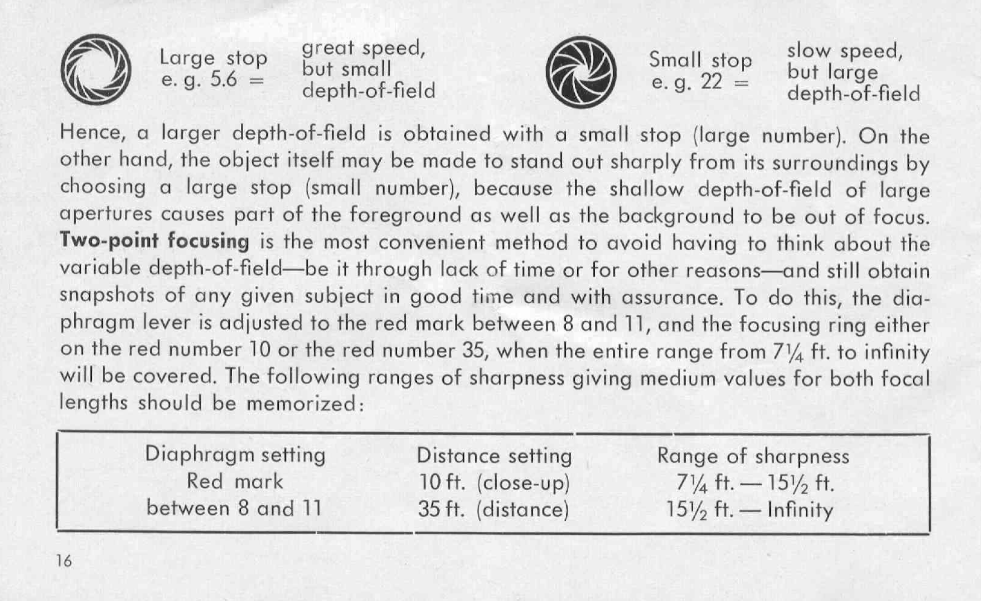

What got me wondering about it was an experiment: I reasoned that back in 1955, ASA 100 was pretty fast film, and cameras of that era always have red dots on the focal scale and the diaphragm. So I loaded a roll of FP4 into my Mess Ikonta 524/16, set the focus and diaphragm to the red dots, and shot a roll of cityscapes with subject distances of 25 feet to infinity, varying the exposure only with the shutter. The results were impressive. Everything was acceptably in focus so long as it was over 20 feet away. I repeated the experiment with HP5 but set the diaphragm to f/16, and the results were even better.
I remember from college that the math behind lens design was simpler with incoming rays assumed to be parallel; i.e. the subject at infinity. But my experiment made me wonder if the designers didn't actually use a closer subject range. They didn't have computers in the late 1800s when these lenses were designed; and the Tessar was originally designed at f/8, close to the "red dot" setting. And it's true that casual users were shooting mostly people pictures with the subjects 10-25 feet away.
So, to address the OP's question, the sharpest folder lens would be a 4 element design (Tessar, Solinar, etc.), with the lens either in excellent original condition, or CLA'd by a qualified technician. The biggest problem is the scale focusing - it's hard to set focus accurately closer than 20 feet!

From the Agfa Isolette II manual, mine is an Apotar ƒ/4.5/85
