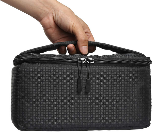

The BYOB 7 does fit my 3.5E without meter, but it is a bit snug. I need to unclip the strap. There is enough room to park my Gossen Luna Pro SBC on top of the camera. Filters fit in the zippered pocket. A Leica M is another suitable occupant.
A friend sent me this little 7. Nice little padded bag. Checking online, I was surprised how expensive they are. Really, it is not sophisticated technology or sewing.
Lots of inexpensive inserts on ebay; especially if you are willing to wait for shipment from China. I like using them for storage as well. When I want to use, I plop the insert into a unpadded messenger bag. But I like having enough room in the insert for a meter and a few rolls of film.

Update: No, do not try to fit a F model in this BYOB 7 bag. The plastic meter cover will be vulnerable to any external impact. Look at how snug the focus knob is on my 3.5E 'flex without a meter.
Decades ago, the Rollei case for my former 3.5F had a rigid leather cover for the meter. When I traveled, I just chucked the camera and case in a backpack, and it was more than adequately protected. Sometimes, I wrapped it with some clothing, as well.
I ended up with another one - it does fit the 3.5F and an additional, filters and hood. It's a perfect insert for my Domke F6 https://www.amazon.de/gp/product/B00L8MQK3A/ref=ppx_yo_dt_b_asin_title_o09_s00?ie=UTF8&th=1
