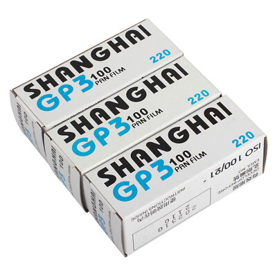

Shanghai GP3 100 220 - still an unfinished product?

220 Shanghai twenty rolls. by Nokton48, on Flickr
Firstly I purchased four rolls and liked the results. So I ordered and got another twenty rolls, to give it a good go. So far only one roll has jammed at about frame 19, I reloaded the roll in the camera, and was able to force it through and finish it.
I do like this film! So a month ago I ordered another twenty rolls, and recently asked for status. Due to Shanghai closing down during covid, long delays possible. I asked for a refund and got within ten minutes to the seller's credit. Unfortunate situation but not giving up
I have in the deep freeze 220 HP5+, Plus-X Professional, and Tri-X Professional. I tried to load up as 220 was being closed out and discontinued. I am saving this film for future and going with Shanghai for now

I see GP3 220 being sold on Ebay for $22 Canadian right now. I'm tempted to get a couple rolls. I've never shot 220 before. How is the quality control now on current fresh stock? Are people still seeing issues with it?
Just a heads up.
I bought 5 rolls of GP3 220 from Amazon and they arrived in one day with free Prime shipping. And to my surprise they are fresher than the eBay offerings at 01/24 vs 10/23 from eBay listing descriptions. Prices are more or less the same. Before I checked whether Amazon had any I ordered 10 rolls from a Chinese eBay seller and those will take a month to arrive. Meanwhile I am waiting for the A24 back from KEH and will shoot a test roll. I hope it doesn’t jam like some reviews say.
Only issue I have had, is one roll jammed at frame 19. I reloaded the roll in the dark, and finished the roll. But I am still going on with what I have, which is quite a bit
My twenty rolls from Ebay are moving along I see. I have enough on hand to last until it gets here. And Ebay and Paypal give me some help if any issues
Thirteen Bucks a roll is not bad for fresh 220 in my opinion. And I like the look of it in D23 1:1
$13/roll for 220 is an excellent price, no matter what. Let alone the fact they are the only ones making 220 film!
