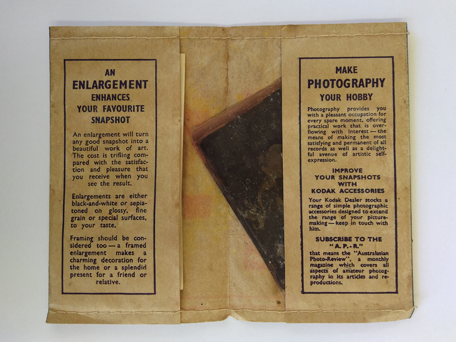

I don't know for sure where the images were taken. They are part of a family archive. The other negatives were in a much better condition. They were found in a Kodak print envelope stamped RIEFFENBERG(?) PHARMACY - KEMPSEY. Some images were indeed taken in Kempsey and have Macleay River Railway Bridge in the background. The photos appear to be taken in the 1950s.

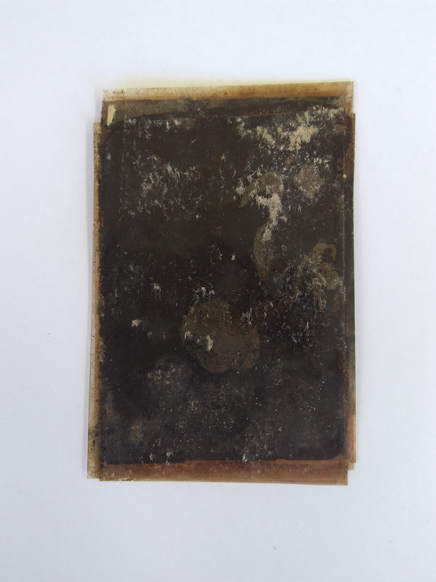

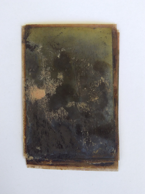

I used standard Photo Flo solution (1 + 200). The negatives were placed in a jar with the solution in an upright position. I let them soak for 2 or 3 days in the fridge. I changed the solution once or twice. The goal is to soften the emulsion enough to separate the sheets but not too much to lose adhesion to the substrate. There is no guarantee that this is always possible, but it worked for me to some extend.
The best advice I can give you is to be patient and handle the negatives very gently. It is very tempting to start separating them before they have soaked enough. This is how I ruined the first frame. Good luck and please share you experience in this thread.

Surprisingly, I had some success separating the negatives. I lost some emulsion at the edges of each frame but the rest was preserved. I did exactly what you suggested: left the stuck negatives in a photo flo solution for several days. We are heading into the summer in Australia with the daily temperatures above 30 oC so I put the negatives in a jar and kept it in the fridge for a couple of days agitating gently once or twice a day. (Disclaimer: My wife is a former chemist. Your mileage can differ significantly when you decide to put photographic chemicals in a family fridge). I left the negatives in the solution (still cold) and letting it slowly come to room temperature before hanging the negatives to dry. I'll post the pictures once they are dry and safe to scan.
Is there anything I can do at this stage to further preserve them? Would you harden them? I personally don't think it is necessary but I would like to hear your opinions.
