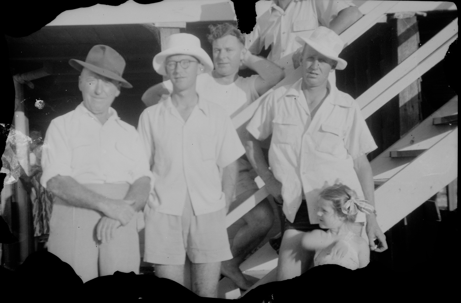

Surprisingly, I had some success separating the negatives. I lost some emulsion at the edges of each frame but the rest was preserved. I did exactly what you suggested: left the stuck negatives in a photo flo solution for several days. We are heading into the summer in Australia with the daily temperatures above 30 oC so I put the negatives in a jar and kept it in the fridge for a couple of days agitating gently once or twice a day. (Disclaimer: My wife is a former chemist. Your mileage can differ significantly when you decide to put photographic chemicals in a family fridge). I left the negatives in the solution (still cold) and letting it slowly come to room temperature before hanging the negatives to dry. I'll post the pictures once they are dry and safe to scan.

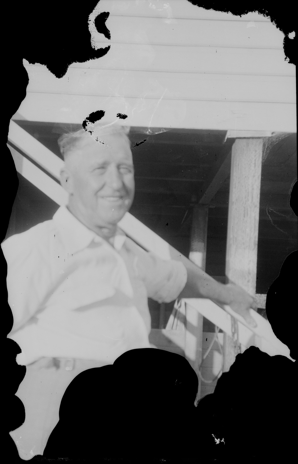

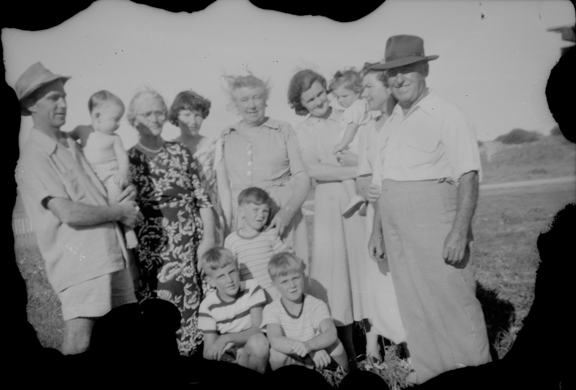

Here are some of the images that I recovered. Thanks again for your help.
If you ever have to do something similar my advice is to be patient. It takes several days for water / photo flo to penetrate between the negatives. It might be a good idea to keep the negatives cool while they are soaking. I changed the solution several times as some of the emulsion was dissolvingand I did not want it to re-deposit on the film.

Those are great images that were well worth the time and effort!
I am glad that we could help and that your well spent time and effort paid off.
Fantastic and an encouraging lesson for many who will have found themselves in similar position.

Great work, looks like they were taken in Queensland, judging by the house on stilts and the clothes......like that Nanna put on her pearls for the photo.
