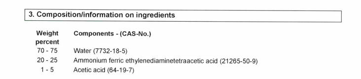

For the Kodak bleach fix replenisher I see ferric EDTA (bleach) in the SDS, which gets consumed:

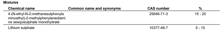

But for the developer replenisher I don't see any CD3 color developer:
Doesn't the CD3 get consumed?
You're only looking at part C. This particular replenisher is a 3-part replenisher. This is in the SDS for part A:
And here's the actual developer in part B:
