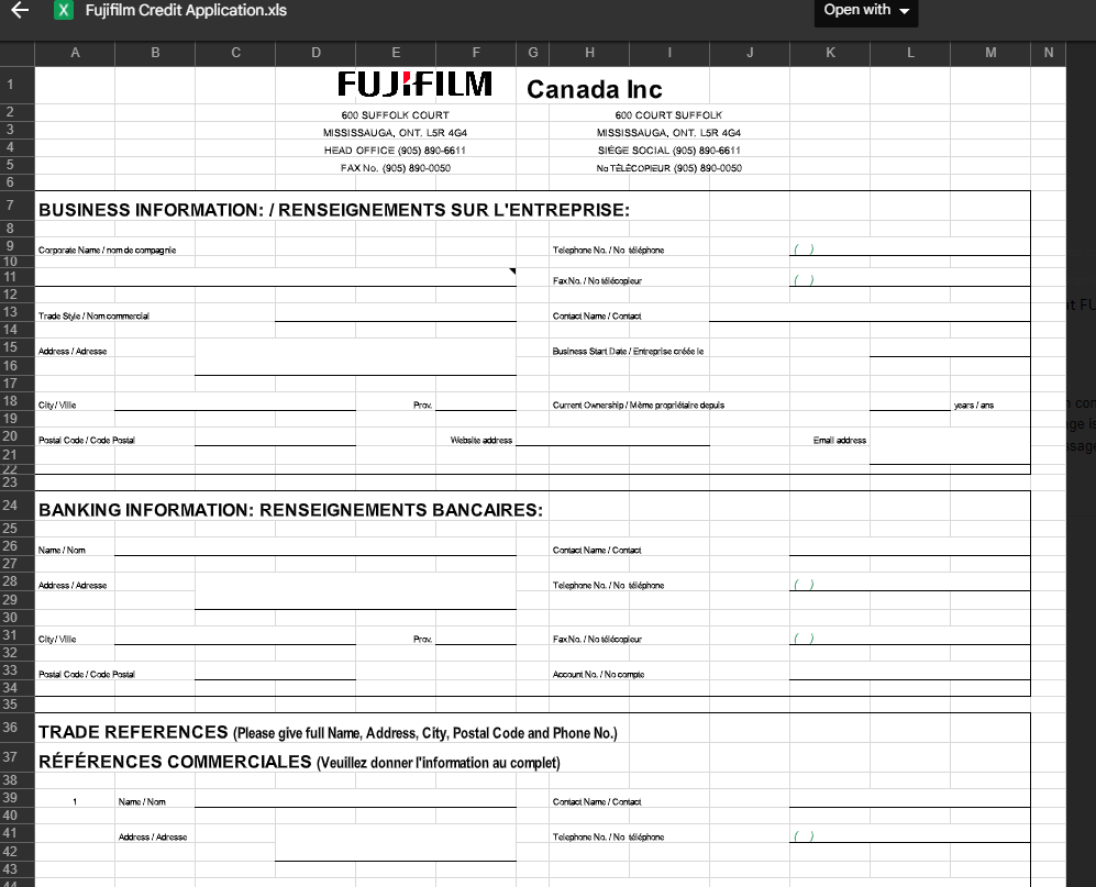

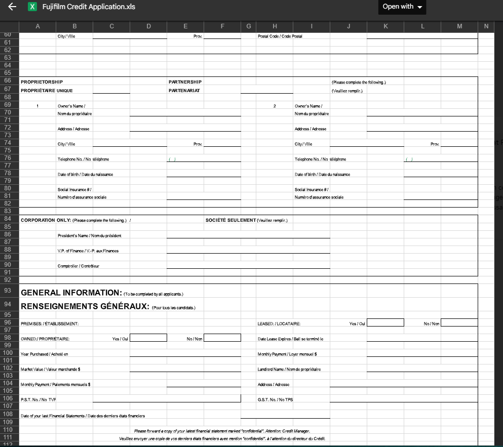

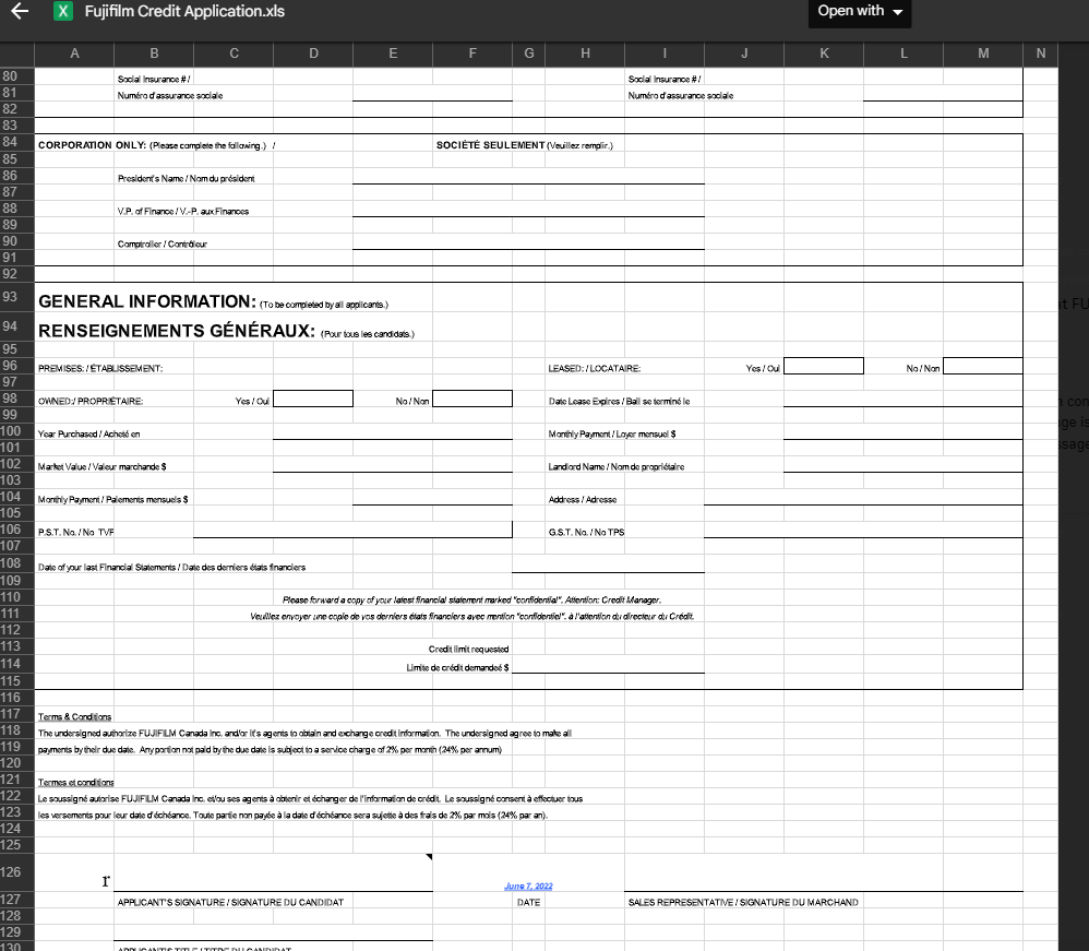

Update on the previous email:
Fuji just sent me a credit application form for purchasing anything from them. Reached out to some random technical support extension and a random guy sent me the form. But it needs a registered business #, business account credit statement, lease information, etc. I had a business bank account, tax registration number, etc previously. So I know how it's done. I have an acquaintance who leases a fairly big commercial place, and I could fake a sub-lease with their help, etc, etc. Maybe then I can set up a business account again and turn it into an official business and become a distributor for Fuji products...... OMG It's getting too deep just to buy some replenisher.
