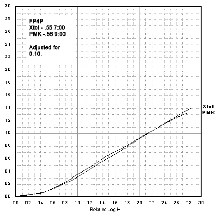

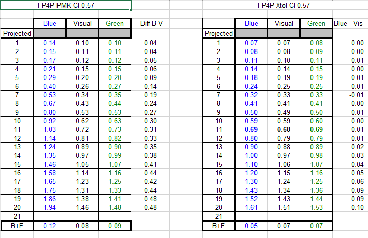

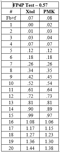

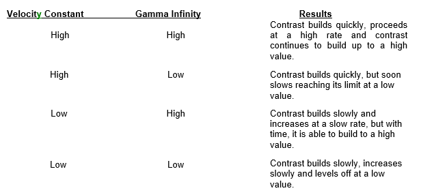

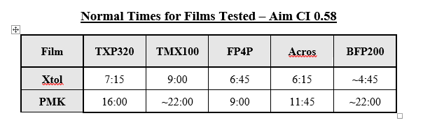

A long time ago, I teamed up with Kirk Keys over a similar question. He felt there was some special properties in staining and I believe it had more to do with the development velocity. We ran a bunch of film, but didn't get much past that stage. Below are the results for FP4P developed to a CI 0.56 in Xtol and PMK. Part of the print testing was going to determine which read densities best represented the results. If I remember correctly, I felt the Visual setting is most likely represent how the film would respond in an enlarger's light.
View attachment 413023 View attachment 413027
