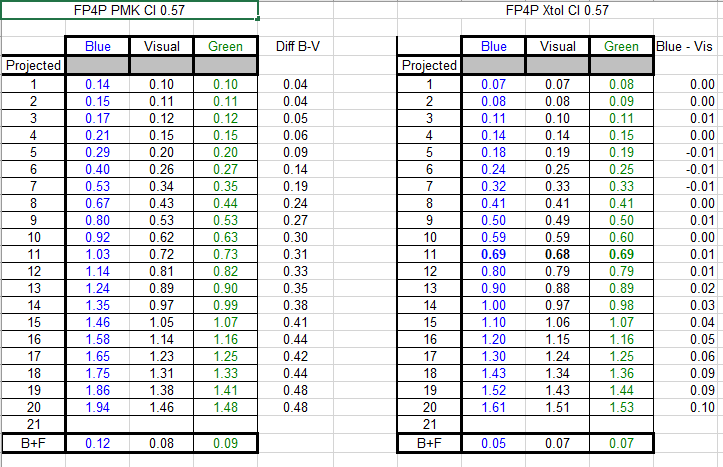

I've used Kodak wratten gel filters, a 47b B and a 58 filter. You have to recalibrate against the calibration strip with each filter, but that's pretty quick. I think it skewed a non stained test strip slightly, but not enough to worry about. Stained negs seemed to give credible results
It is on the vergess of the spectral curve for the device though, so it's definitely a compromise option
Edit: make sure you've got the transmission light on the brightest setting

Like @tcolgate, I use a #47 Dark Blue gel and, as mentioned, it's a compromise but comes close enough that I can "adjust" from there.

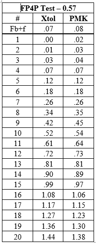

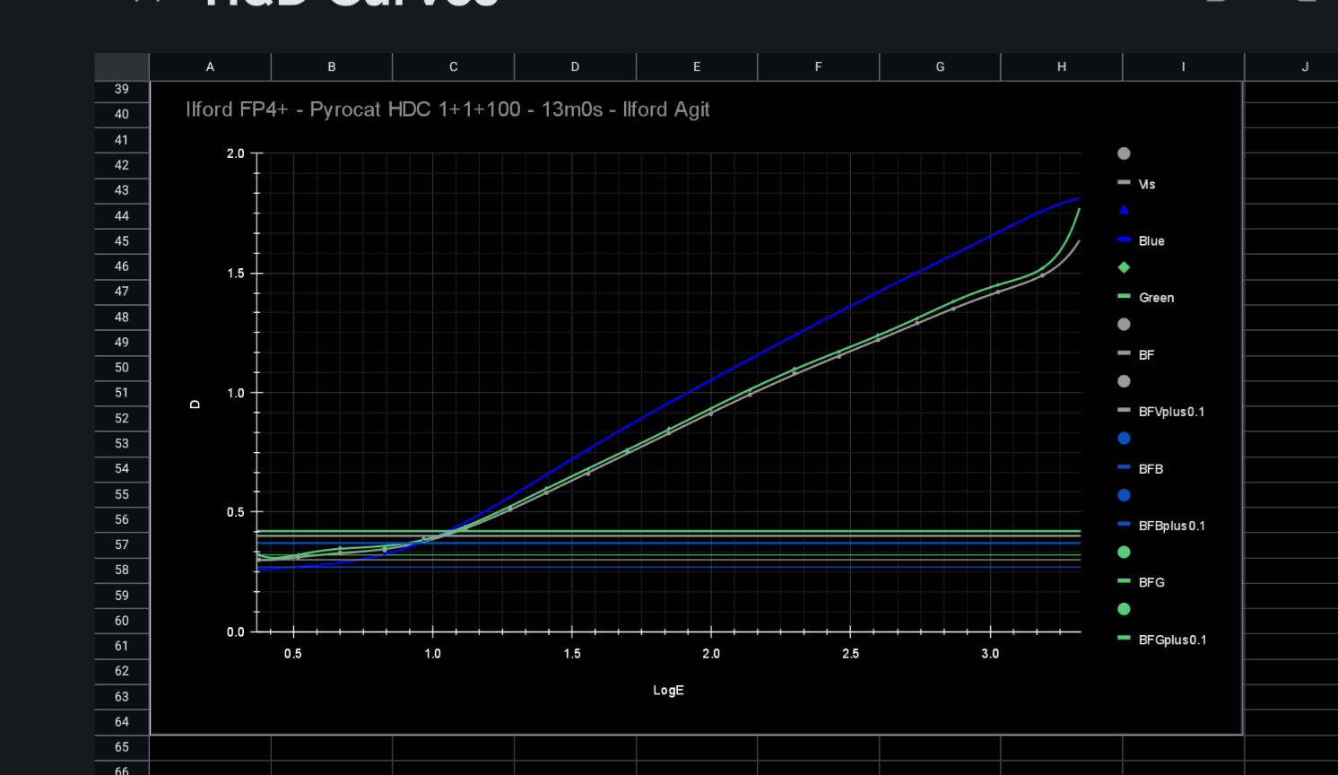

By was of an example. The green curve seems to always be very close to the white light, probably not worth the effort, but the blue consistently shows extra density with my pyrocat negs. (days here got a bit skewed as I misread my lux for the neg exposure) The tick up on the end is likely an artefact of Google Sheets plotting

That makes sense and I have found the same generally when doing this sort of approximate densitometry with stained negatives - although you can occasionally see similar results with some non-staining developers as well.
The blue light and green / white curves are reasonable approximations as "bookends".
View attachment 412988By was of an example. The green curve seems to always be very close to the white light, probably not worth the effort, but the blue consistently shows extra density with my pyrocat negs. (days here got a bit skewed as I misread my lux for the neg exposure) The tick up on the end is likely an artefact of Google Sheets plotting
