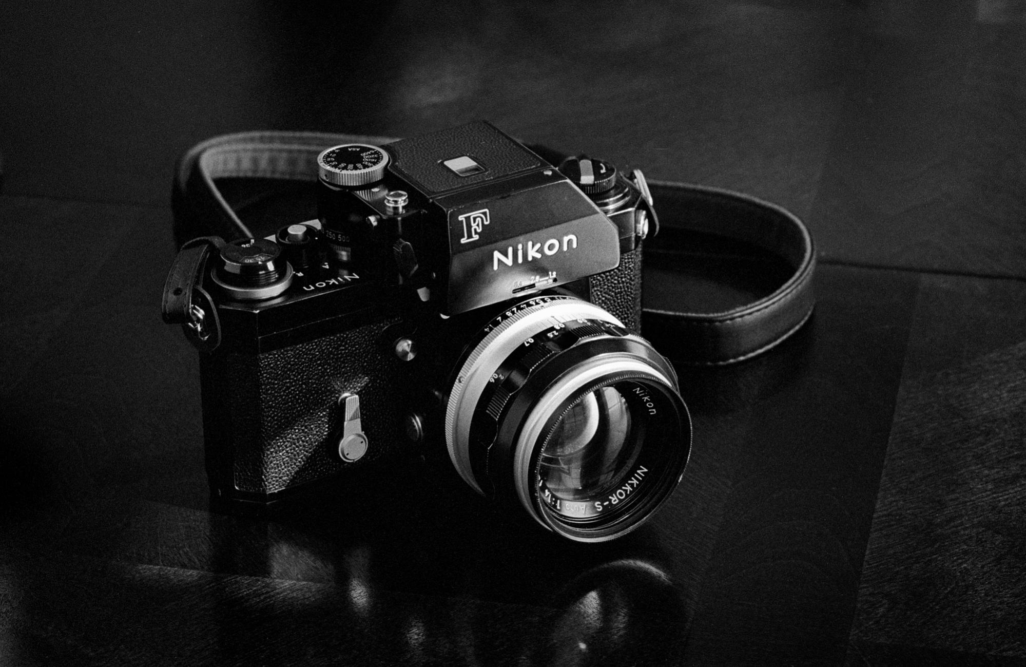

I just had Sover CLA the FTN finder below and calibrate for 1.5v so I can use PX625A / LR44 / SR44 / 357 batteries (with holders). Works great. I don't think he has replacements parts for the FTN's like he does for F2 finders so repairs maybe limited. E-mail him to find out what he can do.
I don't know if Sover Wong works with the FTN's or not. He's primarily an F2 man but definitely the best there is.
I bought that F2A from a collector and it looks just like the photo. There was never a roll of film through it until I got it.
