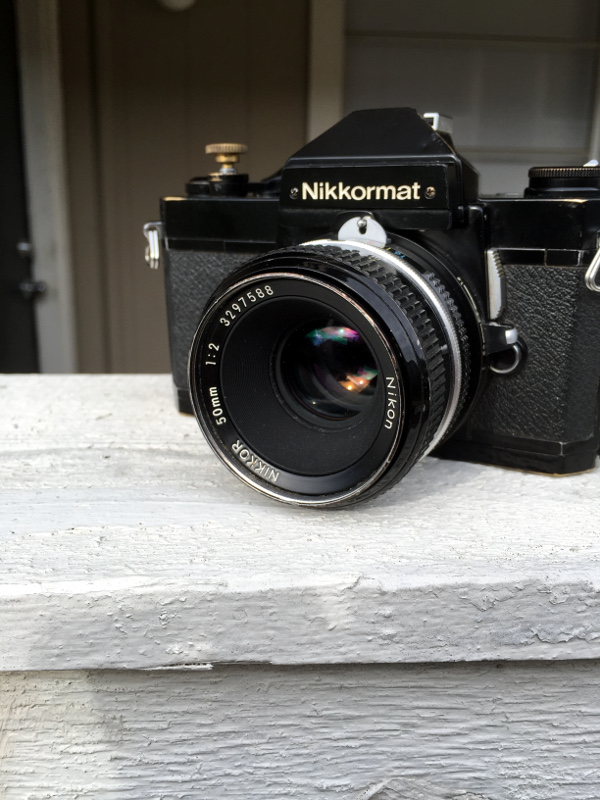

I have a FT-2 that does open aperture metering with both non-Ai and Ai lens. It does not however do it with series E and autofocus lens. As long as the lens has the metering rabbit ears it will couple to the meter for open aperture metering...

Interesting...

That is correct.
Many AI lens came with the rabbit ears.
Many working photographers when transitioning to the F3 removed the rabbit ears as they weren't needed any more.
One has to be careful when buying AI lenses for a Pre-AI camera. I only have one AI lens that still has the rabbit ears.
You can still get new old stock ears and salve damaged screw holes. But they will be the new fangled AIs pattern.
You can upgrade some lenses with micro drill and thread tap, but some don't have enough plastic on the aperture ring to make an easy job.
