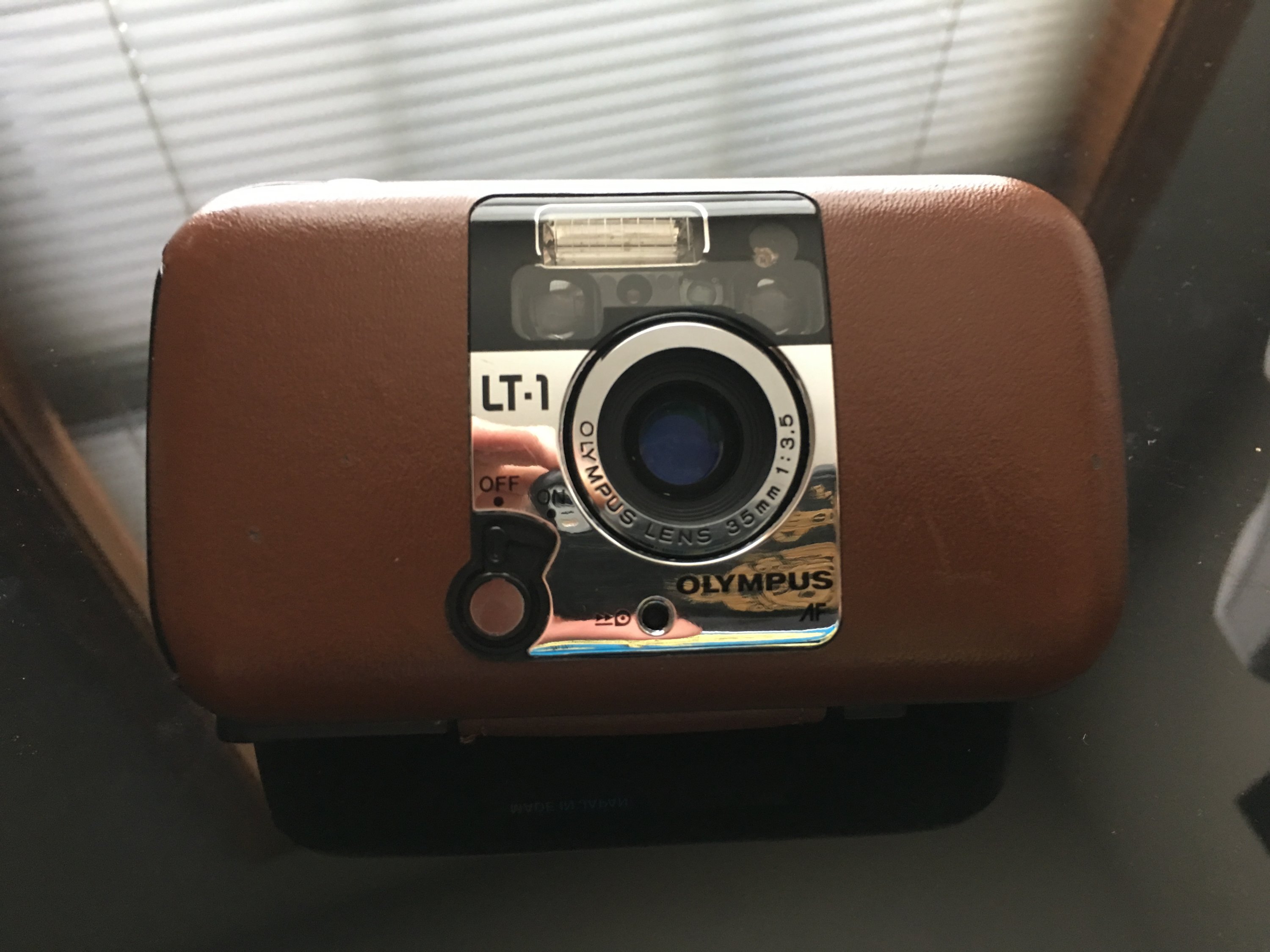

So, I took everything everyone said into account, and decided to go with.... DRUMROLL....
The Olympus LT-1 QD! Basically, its the same camera as the Mju 1, but with a sweet little leather wallet body and built in cover. :smile:
It does up to ISO3200 (DX only), has a 35mm f3.5 lens, and shutter speeds from 1/15 to 1/500th. So, while it gives me pretty much no control, I think I might be able to pull off some nice snapshots with it. Got it on eBay for $50! Seems like it works great! :D
Thanks for all the input on options everyone. I ended up not getting anything we talked about (well, I guess we kind of did since its a Mju 1) but I saw it and thought this was a great deal! :D

Nice. Security will just see a glasses case.
Are you planning to hack the dx code or just use flash?
Yup! Very stealthy. I think I'll probably scratch the DX code off and shoot at either 1600 or 3200. What would you do? Should I go all the way to 3200? And how do you think I should process it? I'm not sure what might be best.

What would you do?
As mentioned, I'd shoot (whatever film) with the flash, but I'd be shooting around the event (not specifically the performance). I'd not really be interested in documenting the performance — there will be a pro with pro equipment and access pass better able to do that.
You can push Cinestill 800 two or even three stops. It can look quite soft (pehaps due to lack of anti-halination layer) from what I've seen.

Nice camera, should be fun. I just gave a Mju I to a friend who has just started down the path of film after a few years of DSLR use and he loves the little Olympus.

The LT-1/Mju 1 seems really nice! I'm looking forward to trying it out! :D
