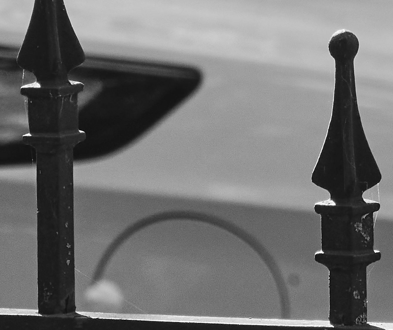

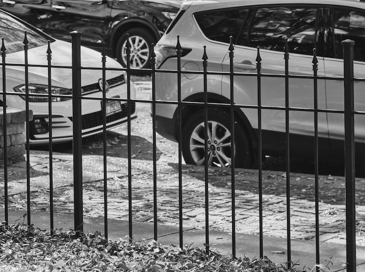

Using the GClaron 240mm - on a 2x3 view camera, and even more oddly, with a digital back... you get a cheap tele, and work always in the sweet spot of the lens. Did some test shots - here is the full frame (compressed so doesn't look sharp), and the 100% crop - which is sharp, can see the spider web....
JW, I've used the 150/210/240/305 G Clarons and never failed to get really fine results.

After seeing some of your work, I trust what you say. If I can't get good results, it's either a faulty lens or me. Looking at GG12's photo above and seeing those spider webs on the wrought iron fence convinces me of exactly what the 240mm G-Claron is capable of. I might even look at a 150mm G-Claron for my 4X5 outfit?
