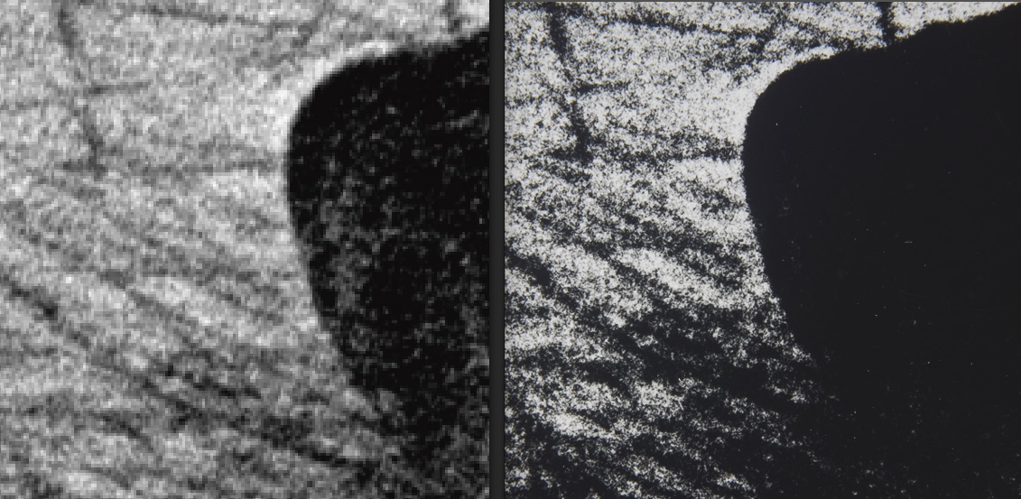

From the tests I have done, there is quite a difference between a scan and a print, although it doesn't really show up until you print larger. Scanners do not image the grain in spite of what everyone blathers on about on the interwebs. I chuckle when people say that their Epson scans the grain. Ain't even close.
Here is an image of a scan from a Nikon 4000 at 4000 dpi compared to a scan of a print matched for size. You can clearly see the difference. Of course this would be something like a 26 or so inch print, but you can clearly see how a darkroom print done right looks like. I think this is a 400 speed film IIRC, so something with less grain would be even more dramatic I think.
Again though, it just depends how big you are going to go whether or not you will actually see a difference. I can't really talk about color prints, although I've seen some extraordinary Cibachromes and I haven't seen a digital print that was the same. I couldn't qualify why though since I am not experienced with color printing in the darkroom and it has been a while. I suppose it would be similar to black and white. If you ever get the chance, look at a Christopher Burkett print.
Here is the comparison image. Neither side is sharpened or manipulated. If you download this image and shrink it in Photoshop you will see that at a certain point it won't matter-

yeah .. you are right, patrick's demonstration have pretty much blown me away ... basically for a
scanner to actually show film grain it would have to be like resolution of like a zillion.. :blink: ( its mind boggling! )

Yep, you're exactly right about the actual physical differences between scanning a negative + printing and proper analog printing. That being said, the enlargements that you show are equivalent to a person sticking their nose right up against a poster sized print in a gallery and then enhancing that view with a high powered magnifying glass. Hardly a typical viewing experience. If I were a photographer (and actually... I am) and wanted people to appreciate my idea of artistic expression, I would be perfectly happy with the viewer sitting on one of those nice wooden benches 10 feet from my well light inkjet renditions of a fine film negative.
That image is a 35mm neg, so technically you would see a difference without a magnifying glass. If I wasn't lazy, I do the experiment myself, but I frankly don't care. Lol. Just based off of general experience, and as a half-a$$ed guess, I'd say at around 11x14 a reasonable difference would start to show without pressing one's nose to the glass for someone that can see it.
