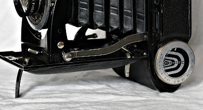

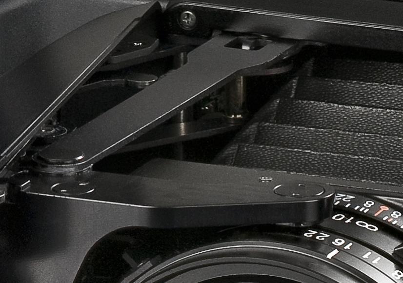

Now what I wonder about is how the focus and rangefinder coupling all work. There is a focus lever on the lens, if I'm not mistaken. The Bessa II has a knob on the body to move the front standard back and forth, and this is mechanically coupled to the rangefinder. This camera seems to have a very different arrangement.
that's exactly right. This is a section of my RF Bessa.
for more detail click here.
I noticed also that the Bessa III camera seems to have an entirely different mechanism. As pure speculation, I have a suspicion that it uses an electronic stepper system to couple focus and rangefinder. This would require less precision in the mechanical design and perhaps be easily sourced form existing components. A vernier arrangement printed on the lens and an optical system such as the old mouse mechanism (see here) to measure both could provide very high accuracy.
It would of course mean that the system would use power on focusing, but may mean that you could still focus without battery (based on scale) and not have coupled rangefinder. I wonder it if takes an AAA? I don't see any sign of a battery compartment.
Compared with a mechanical system like the RF it would also allow the folding frame to be more rigid (and not have any slop) and (fantasy) make it easier to make models with different lenses (wouldn't a 50mm be nice).
There is a battery compartment on the bottom plate which looks the same as on my 35mm Bessa R3M, suggesting button batteries. I think the rf/focusing will be mechanical. Looking in close up there is a linkage system inside the front cover.

spotted it! Ok ... well just chatting with a mate about stepper motors, they are very low current, perhaps less than even the aperture diaphragm operation
Andy
...I think the rf/focusing will be mechanical. Looking in close up there is a linkage system inside the front cover.
yep, spotted that earlier. Still ... my Bessa I (front lens turns) has a similar appearing mechanism to that, but it is only for support and facilitating folding. I'm uncertain if the structure in the images looks like a structure item or a focus item.
There has to be some electronic coupling between the lens (electronic shutter) and the camera as the dial is there, might be simpler to have an electronic movement of the prism in the rangefinder. Stepper motors are accurate to stuff like 177 positions withing a degree.
still, I have no idea (I'm just speculating)
