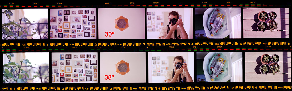

I got streaking when developing 4x5" negative film (well, only with Ektar) in my Jobo drum at 38ºC, so I wanted to know what would the results be at lower temps (where I got no streaking) compared to standard processing. First I did it at 30ºC (8min). I didn't like that the shift was quite big so I didn't try even lower temps. At the time I decided that I'd rather shoot Portra 160 than compromise the results. Although I believe I could match the scans in post-processing, I always feared that negatives would have problems with wet printing. Now that I finally can do RA-4 prints I might try to print a pair of negatives and see what I get.
Anyway, here are both strips (developed at 38ºC and 30ºC) that were scanned side by side on a Epson 4990 flatbed with quick invert to get a reasonable results from 38ºC negative:
A pair of those scanned on a Minolta 5400 with the same inversion for both:

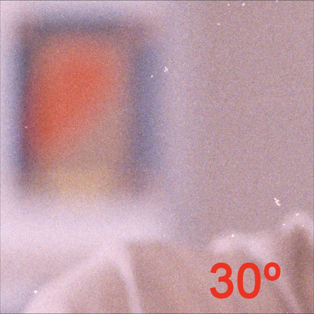

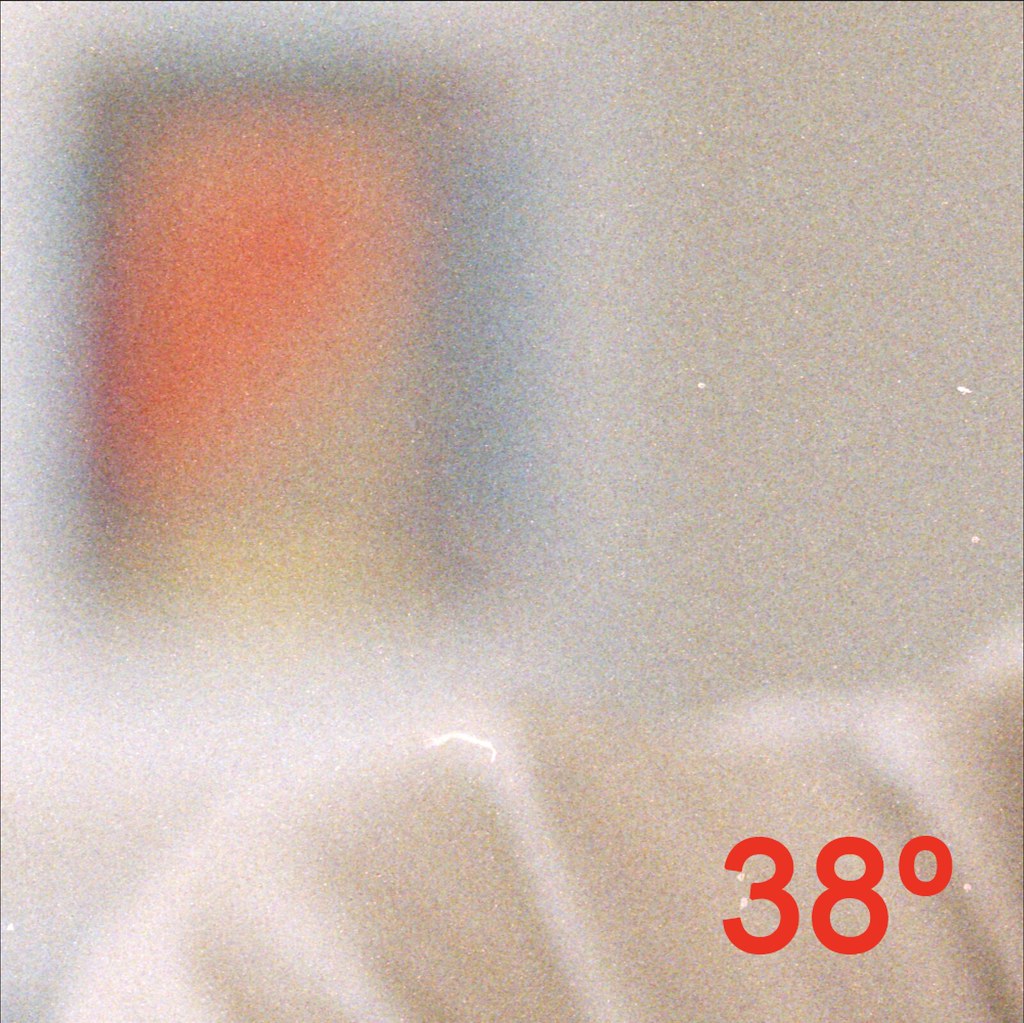

200% crop to show the grain:
Those negative strips look as if the 30 degree set got a little less total development -- that is, time compensation might have been insufficient. That might then account for the color shift.
Well there is a slight but distinct magenta cast in the 30C negs compared to the 38C but as the slight cast seems to be uniform, it begs the question of whether in optical exposure and RA4 printing this might be easily corrected?

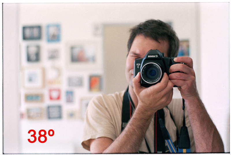

Finally had the time to print and scan. Those two are from the same two rolls that the examples in my previous post are from, Fuji Color 200 shot side-by-side.
I didn't spend any time on the 38º print, just to get a reasonable balance and then tried to match that with a 30º negative. As you can see there is a cross-over and you can't match both, light and dark, parts of the image.
Yes. We've seen here negatives with "alternative" processing that look far worse and people still claiming they work perfectly for them.
I see a 1/3 to 2/3 speed loss in the 30C negative, relative to the 38C -- but I see a green shift, rather than a crossover, in the 30C (I don't see crossover well for some reason, even when I'm specifically looking for it).

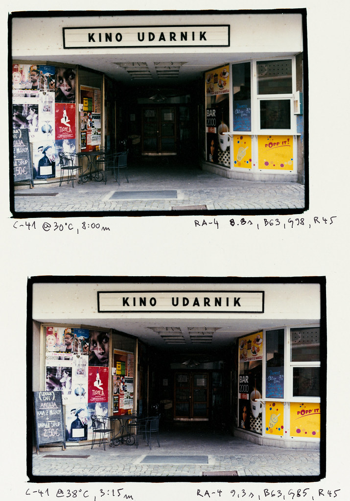

I thought it was a perfect example (well, from the ones I could pick from, obviously). It's got a transition from light to dark part and the pavement is generally a close proximate to neutral grey and so a known starting point. I don't know how a certain single hue could reveal any crossover. I think that for an evenly lit portrait shot you could probably balance the filtration for skin alone and get away with it even with a negative that was far more out of the specs than what I have here with 30ºC processing.

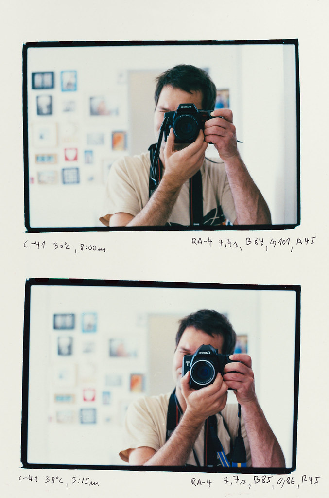

But, ok, let's try this (this is as much skin I have on that roll). The lighting is poor and Fuji C200 is far from the best choice for skin tone. Both are balanced for a general feel (and I didn't do more than two test prints) and not for same skin tone, I could probably match the skin tone in both and then we would be again looking for any evidence of crossover in dark and light parts of the image and not in skin tones.

Thanks,both of these look as identical enough to me as not to matter but what isn't clear is what if anything did you have to do in one of the scans to make it identical in the other i.e. did you alter or is it even possible to alter one part of a scan to alter one part of the picture to correct a problem which is not possible with optical enlargement.
Not sure I understand the question.
My post #79 contains scans of the negatives. The 30ºC images have a strong magenta cast because they were inverted exactly the same as the 38ºC (think of it like optically printing both negatives with the same filtration and the filtration based on 38ºC negative).
Posts #82 and #91 are scans of optical prints. Both negatives, 30ºC and 38ºC, exposed subsequently on the same sheet of paper (I use different exposure times and filtration to match them) so they get exactly the same processing.
What I gather from this exercise is that 30ºC negatives go slightly green in shadows where 38ºC stays more or less neutral - crossover. Of course, maybe going slightly green might be preferable to some or even more to the specs. I have never processed control strips to actually verify that my C-41 process at 38ºC is actually good.
Thanks brbo I had not noticed that on #91 these were scans of optical prints but if I had read your post more slowly then this was clear. I am never sure when I see scans of negatives inverted to positives if they fully represent what I would see if it was a RA4 print.
So it now definitely looks to me that the slight magenta cast in the 30C processed negative can be corrected in optical printing as you have done. If skin tones are best at revealing colour crossover then as far as I can see there is no crossover there.
Yes there may be the slightest sign of a change to a greenish shadow in the shop doorway in the 30C example but I wonder if I now see something that I think is there because others have seen it. Koraks statement in # 83 sums things up for me
The transition was perfect, but pavement often surprises one with slight traces of variations in colour that are somewhat unexpected.

There is a small bit of crossover in the 30C version of the people pictures - more of a cyan cast in the highlighted background when the skin tones are well balanced - but you only see it clearly if you pull the digital image into an editor and increase the saturation.
