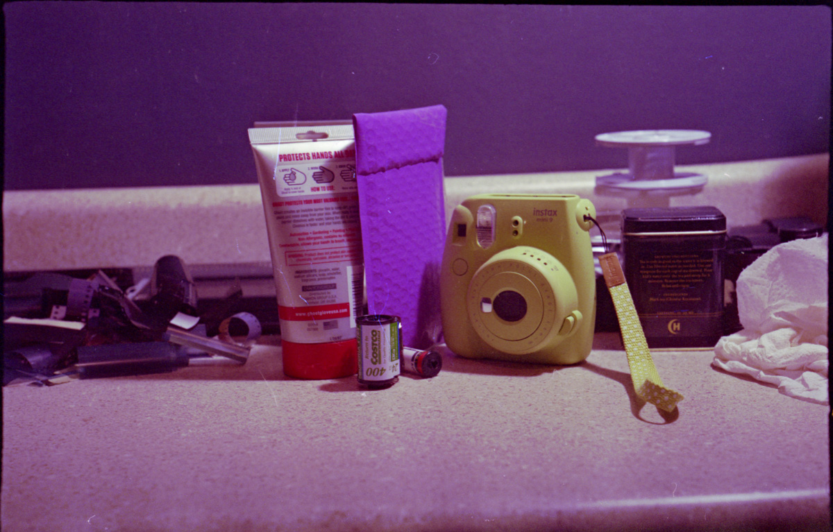

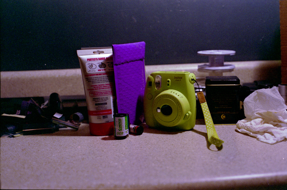

Okay, here we go. My editing sucks, I tried to make the positives look alike, but without being able to adjust them while viewing side by side, I could literally spend all day at it. For those who want to look at it themselves, here are the appr. 31 MP raw negative scans in my Dropbox. Crop 1 -- stand Crop 2 -- normal These were cropped from a single 0.9 gigapixel scanned image covering two negative strips in the carrier. I don't have a storage location with enough space to even temporarily offer the full two-strip scan; it's 5.6 gigabytes. I probably won't even keep it long on my hard disk (in favor of scanning the frames as uncorrected raw slides, which will save two or three GB, and which I can and will offer for those interested once done).
And here are the as-metered frames inverted with negadoctor in Darktable.
Stand developed (Kiev 4, Jupiter-8 50mm f/2, Superia X-Tra 400, Flexicolor chemistry)
Normal process, 100F (Ricoh Singlex II, Super Takumar 50mm f/1.4, Super X-Tra 400, Flexicolor chemistry).
Both were exposed at f/8 1/25-1/30 under a reflector lamp with a 13W household LED bulb about 65 cm from the subjects, and the room light, a ceiling fixture with 60W incandescent close to two meters away (white textured ceiling) acting as fill.
The stand developed strip has higher density, both in the frames and in the rebate; this suggests some level of fog induced by the process. Color saturation and contrast looks a little higher in stand, though that could be due to a problem with my inversion -- Darktable automatically applied the same settings, but I had to adjust the exposures individually due to the different densities of the strips.

The normally processed film looks better IMHO. Looking at the table, the stand developed one has a strange transition from yellow to magenta, whereas the normal one looks... normal. The paper on the right also looks more reasonable.
MattKing
Apr 24, 2005
54,733
Delta, BC Canada
Yep.
A perfect example of crossover!

@Donald Qualls thanks for doing the hard work! I agree with others, the normal development shot looks better. Also, it just occurred to me that you could have saved yourself a lot of trouble by scanning at a low DPI setting, since we only care about colors here and the resolution supported by direct uploads on photrio is very low anyway.

OK I took the two "Raw" scans, sampled the tiny bit of rebate showing to do my normal inversion using: the mask divided layer removal process, inverted, clipped the white points in each of the three channels using warnings in curves and did no other color corrections. This process normally will get me very close to a correct looking color image if the lighting temp is correct for the film. As you can see, this done to the normal processed looks like it probably matches the colors in the scene fairly closely, the same inversion process done to the stand developed negative is a hot mess. I'm sure with enough editing you can get the colors to look better, but there is clearly crossover and other problems. I had hopes this would have done better as it would make processing color negs easier, but IMHO it's not really even usable.
This is the normal processed neg.
This is the stand developed neg
If anyone is interested in trying this inversion technique in photoshop, this is a repost I cut and pasted off this forum.
"The key step is pretty simple to do in Photoshop: sample the colour of the un-inverted negative rebate, make a new layer, fill the layer with the sampled colour, set blend mode to divide, flatten the layers, invert the image, clip RGB black & white points using warnings. Then fine colour adjustments & tonal balancing. The divide blending mode is essential - the mask is not a global colour - it's a mask that's formed inversely proportional to exposure & must be removed as such. If you do so, you're well on your way to manually matching how an optical print responds.
It takes considerably more time to describe than do! Main area of trouble people tend to have is judging how far to clip the individual black/ white points in each of the RGB channels in curves. Best solution I've found is to clip the black point till the rebate has a good black, and the white until just before it starts to clip in the image area. Other important thing is that black points must be set first. Far too often, the preset driven programmes are excessively aggressive with bp/ wp settings when compared to manual controls. In comparison, the Fuji Frontier (for example) tends to clip 'white' to outright white, then adjust the output back to an L of 95 amongst a whole series of other oddities that rather stifle the range of many films. It makes sense in the context of that sort of minilab, but if you want something more akin to what an optical print might deliver, I've found manual clipping to be significantly better."

@StepheKoontz I started to type that I'm not seeing the crossover (I don't have much experience looking for that), but now I realize that the greenish glow around the center grouping isn't scatter light from the Instax, it's green highlight against the magenta (even though more open) shadows around the film cassette and Instax.
Sigh. Apparently, auto-levels scanning in Vuescan does a pretty fair job of covering this up, or it mainly occurs at certain exposures (I may have selected the +1 stop frame by mistake on the stand example) -- my initial roll had very natural looking colors, but was mostly shot in "available light" (= barely enough light) conditions. Either way, it doesn't really save any time compared to my usual water bath prewarm time and 20+ minutes actual process. Maybe as a time saver I should concentrate instead on making a thermostatically controlled warming cabinet to keep my color chemicals at 102F all the time, so I can just load the film and pour the developer.

A lot of scanning software tries to auto correct color and can cover up problem processing. This manual method I did, using the rebate color to remove the mask, shows all :tongue: It's really a hot mess unfortunately. I had hoped it would work well myself.

Good job, Donald, this is already quite valuable. And indeed, the result doesn't look very encouraging for stand development. Of course a properly daylight-lit scene might have been a better starting point; the normally developed shot doesn't look quite right to me either, and led lighting may throw things off a bit depending on the properties of the light source. But the difference between normal and stand development is in any case very pronounced. I don't hold much hope for getting it to work well, based what we see here. You might try developing shorter, but I don't think it'll work very well.

It's possible that the darker mask, as seen on the rebate, is contributing to the problem as this darker mask is across the whole frame. That said, the mask is removed evenly by the divide layer process, so there are underlying crossover issues as well. It is possible that shorter timing on the stand development might produce better results? If I was going to experiment, I would next time exposed the film in normal daylight to eliminate the artificial, mixed lighting variable. Thanks again for sharing with us!

@StepheKoontz If the darker mask is fog, however, it won't have the same imagewise distribution as the orange mask normally does -- fog induced by development is generally uniformly distributed, and the mask is not (what I've read is that the mask forms a weak positive image in the yellow and magenta layers). Worth note in this context, Vuescan uses a film profile to remove the mask, and I selected the Vuescan film profile I use for Superia X-Tra 400 (the one marked for NHG 160) on the basis of appearance (since for some reason the authors of Vuescan don't provide profiles for current films -- must remember to e-mail and ask about that, or how to save a new film profile).
I'm going to try the mask removal using the mask from the "normal" development strip on the stand frames and see if it produces a result more like what I got from Vuescan on the previous test roll. Then, in a few weeks, I should be able to attempt optical prints. I expect they'll need significantly different filtration (the fog is probably not neutral gray), but that'll be the real, final test of crossover or no.
