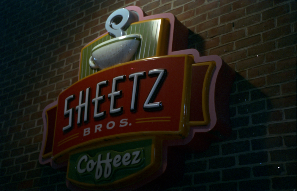

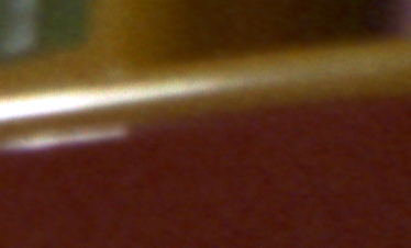

I'm halfway through scanning the film now. Aside from dust and hairs due to dropping the film on the floor while trying to hang it... :whistling: ...the colors look excellent, nothing I can identify as crossover even when specifically looking for it, no significant cast (probably none at all, my scanner software doesn't have a film profile for Superia X-Tra 400 and certainly not for 10 years expired). Grain is no worse than I'm used to for this film in the same kind of light (i.e. dark areas get a little grainy if I try to use the brightness setting to pull the image up out of the dark).
Kiev 4 (#2), Jupiter-8 50mm f/2, Superia X-Tra 400, Flexicolor (room temperature stand).
4800 ppi 1:1 crop from the above negative.

That's pretty good. Amazing how robust the process is. Grain looks non-existent.

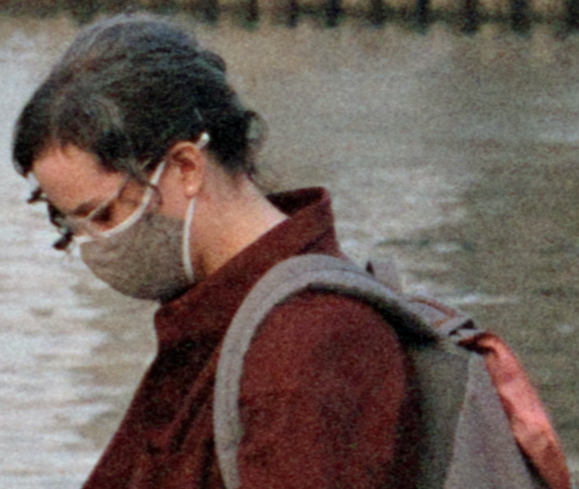

This is crazy. No grain! Either you're getting better-than-normal results, or you're losing a lot of resolution during scanning, i.e. the grain is not getting resolved. I hope it's the former.
Here's how Superia 400 looks like for me (Plustek 120 Pro, approx 3800ppi):
100% Crop:
Flatbed scanners are very low resolving, something on the order of 1600 dpi.

@russell_w_b As Athiril just reminded us, flatbed scanners are notorious for not living up to their resolution claims. Then again, Epson flatbeds with wet mounting are said to be the best you can get for medium format short of a drum scanner (of course, that's for the newer models that claim 6400 ppi, and I don't have wet scanning capability). This is no more visibly grainy than the same film in standard C-41, maybe less.
I plan to run a test soon: one film of a test subject, bracketed exposure, and cut in half, one strip in standard process, the other in stand, then scan both. That takes out a lot of variables -- same camera and lens, same light, same subject, same film (same factory cassette!) -- and after establishing the scanner settings with auto levels, change to manual so I can lock them for other frames and second strip.
That should tell us everything we need to know, within the limits of ten year old Epson technology...
