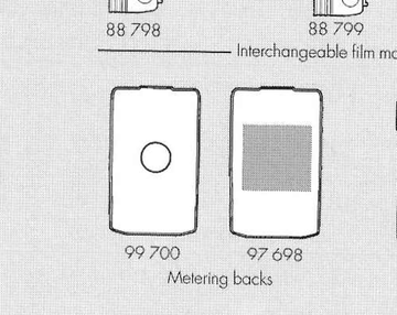

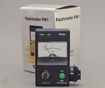

They did have this older flash meter for metering TTL off these 'film backs' with patterns on them. It is a null-meter; one would adjust aperture or flash duration to null the meter (after setting the ISO on the meter).
Alternatively one could make a metering back oneself, for the Gossen Profiselect TTL, even with a ground glass for positioning the probe.
View attachment 255293 View attachment 255294
That meter only works with the 6008 Professional, I think. I have one of those & the meter...do you have a manual for the meter?
