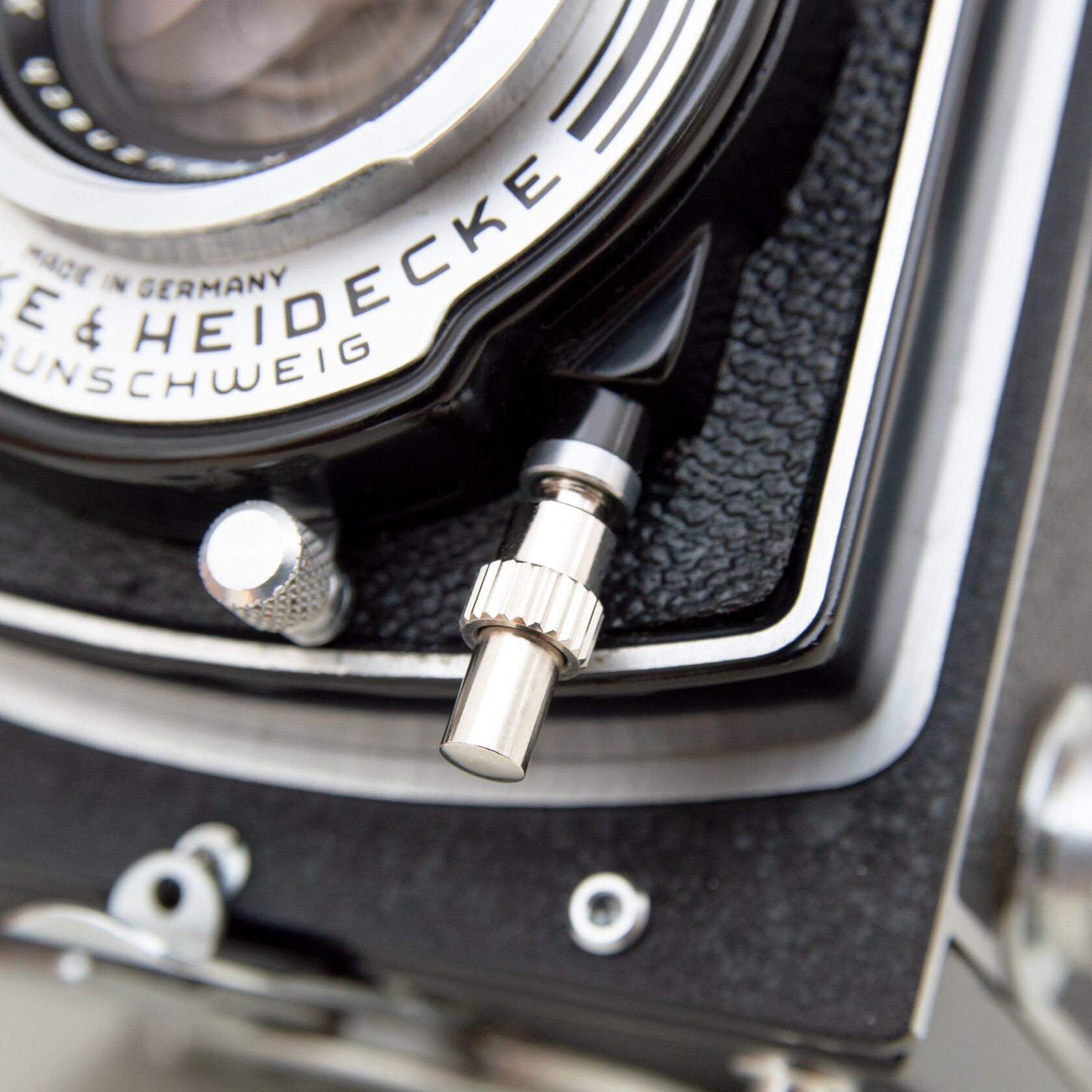

The type of sprung shutter release button/plunger you can use with the Rolleicord. It's best to wait for a seller who wants less for it, though. I have seen new cheap ones made in China, and they should work just as well.
@MattKing, I’m sure you are right and the operation of the camera will not be too much of a problem, despite my missing fingertip. It’s not like I am a candidate for the paraolympics ;-)
@JPD, thanks for that. I have never seen one of those little spring-loaded cable release button thingies and was not aware they existed.
@JPD, I have never seen one of those little spring-loaded cable release button thingies and was not aware they existed.
[/QUOTE]
When I bought my used Rolleicord V it came with that release. Apparently they are quite rare (and originals are now expensive!) as many were undoubtedly lost over the years- it’s nice someone made some new ones, I always use mine.
I have one that came with a now sold Rolleicord III or V, and I'm saving it for a future Rolleicord V/Va/Vb.
It's one of the accessories I like that a Chinese manufacturer started reproducing, and I hope they make more of them. A downside is that they are unmarked, so a seller could easily take $10 more for one without stating that it's a reproduction.
