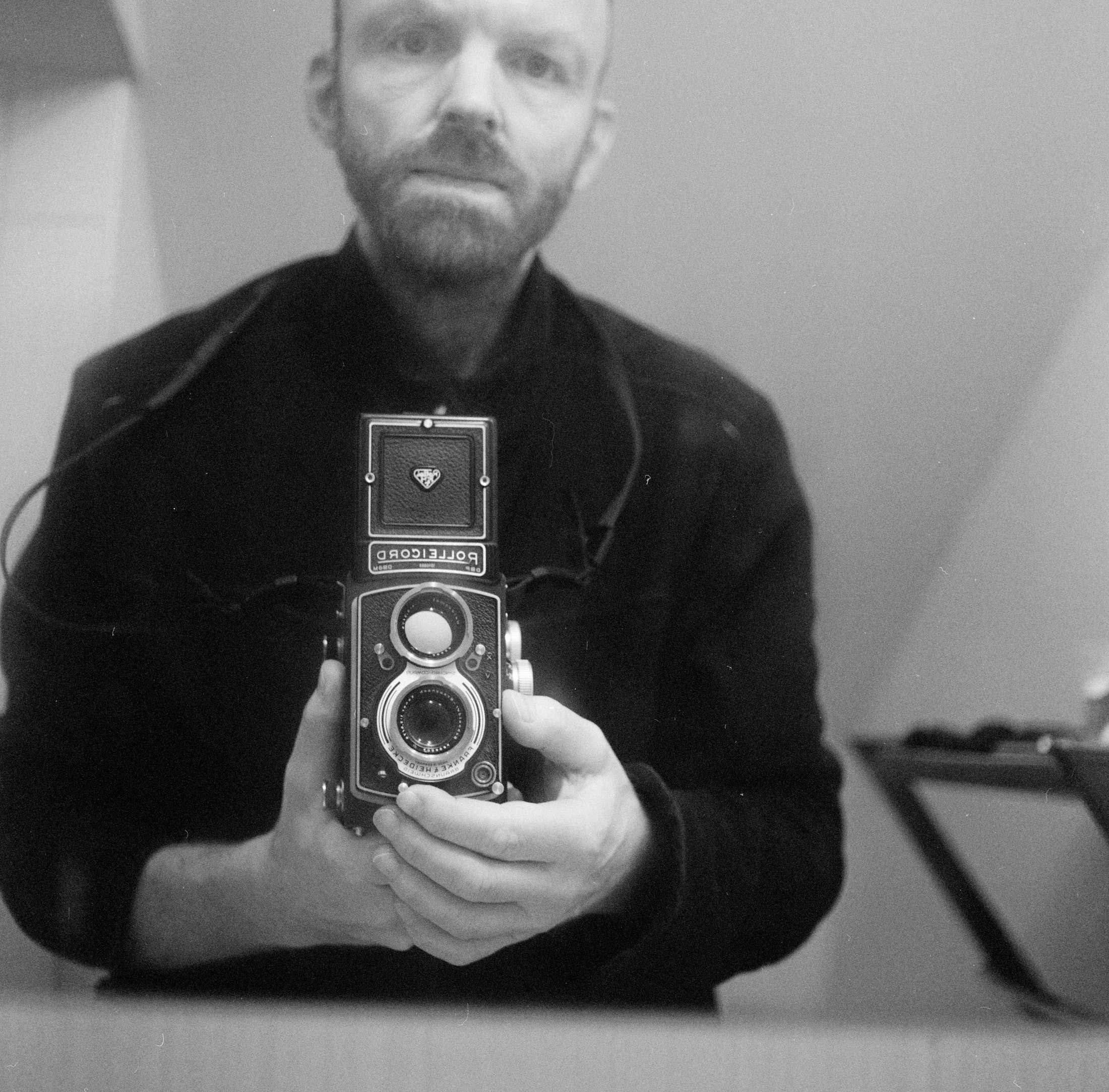

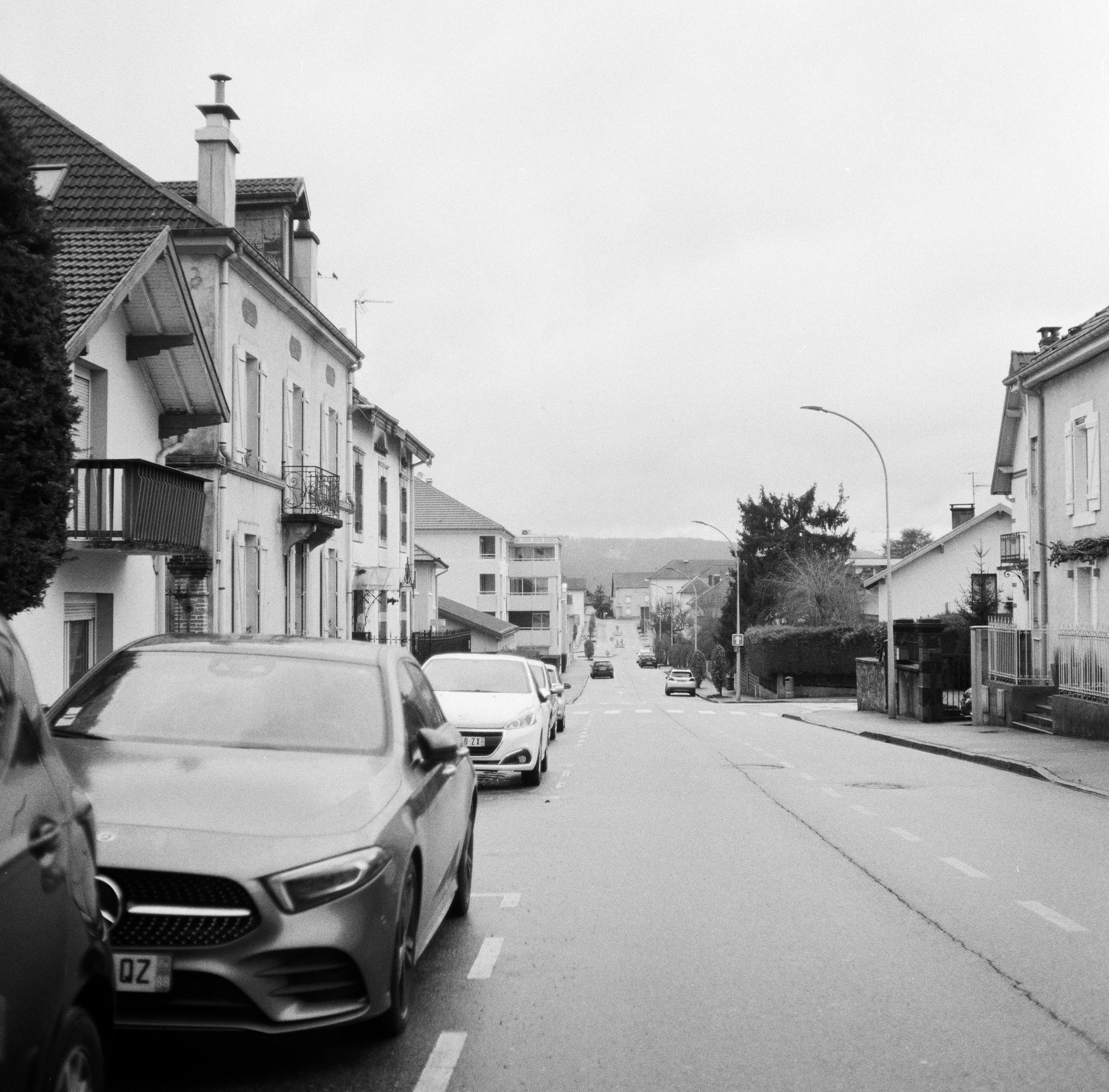

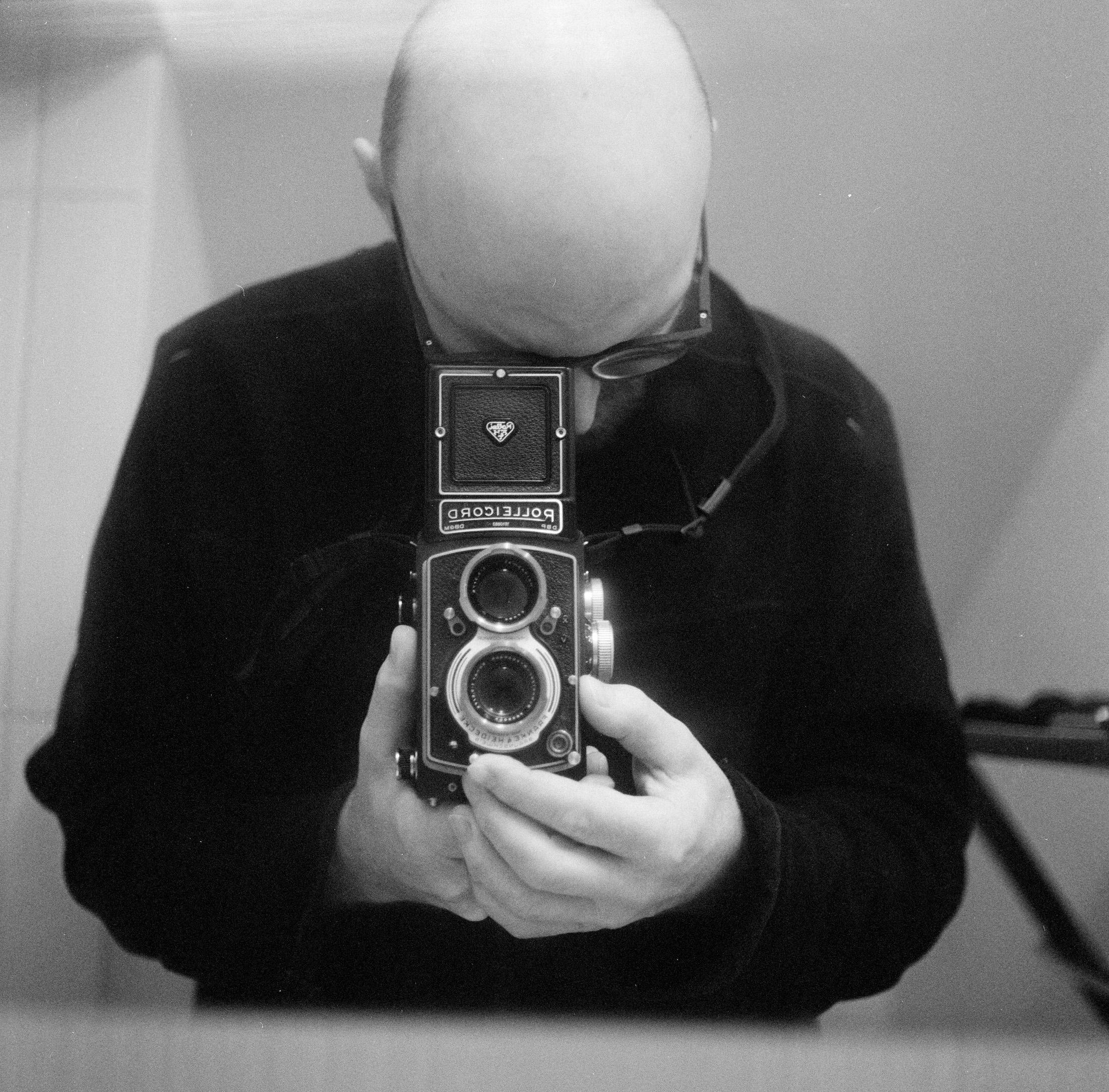

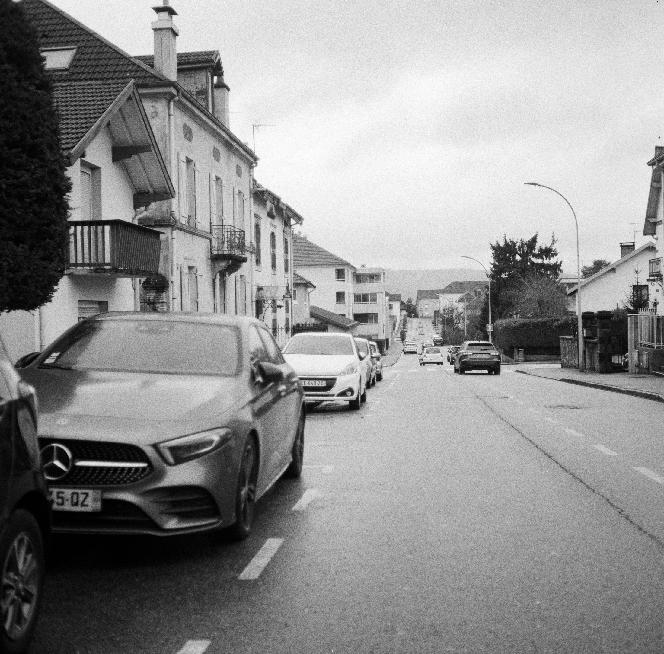

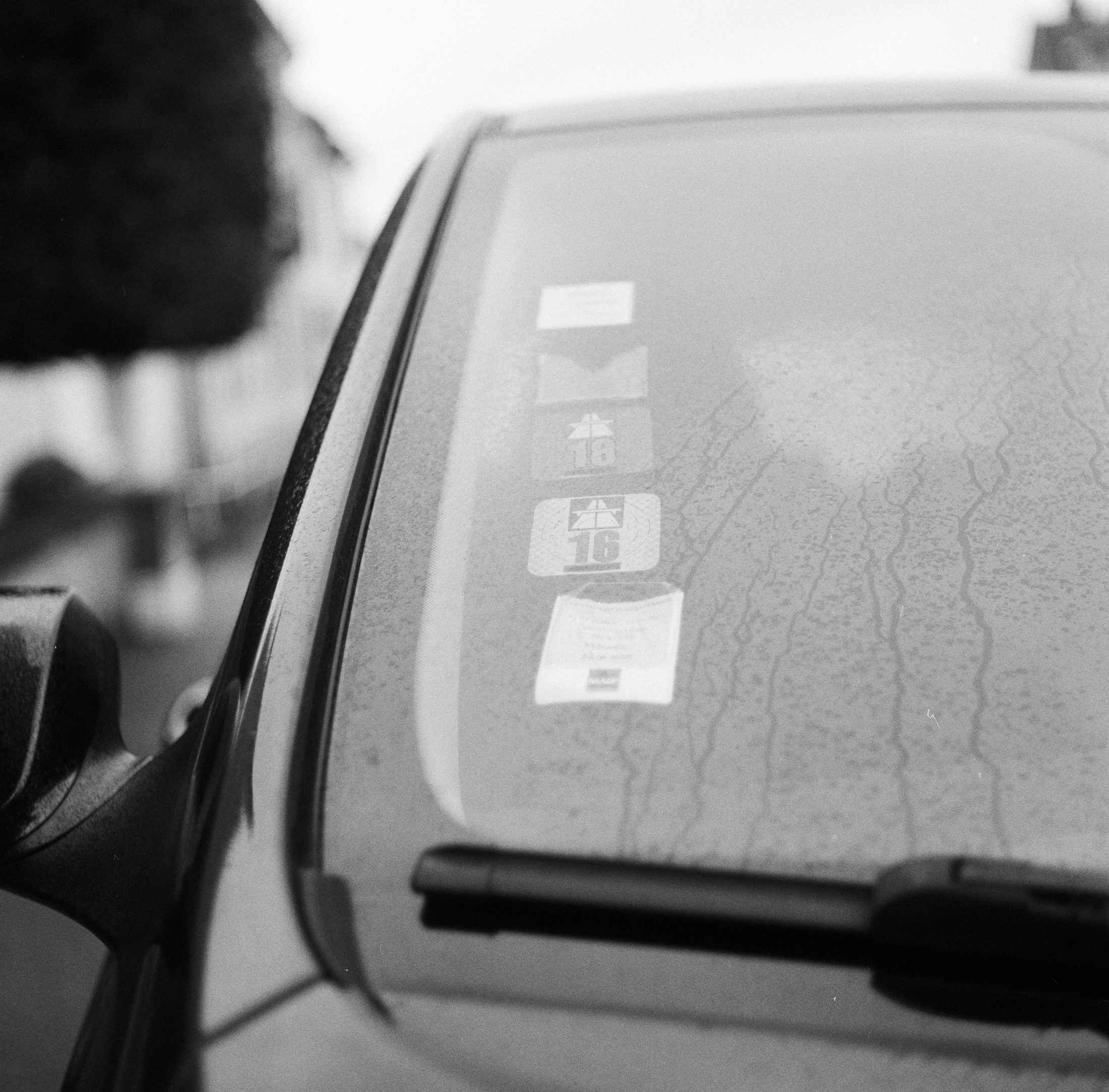

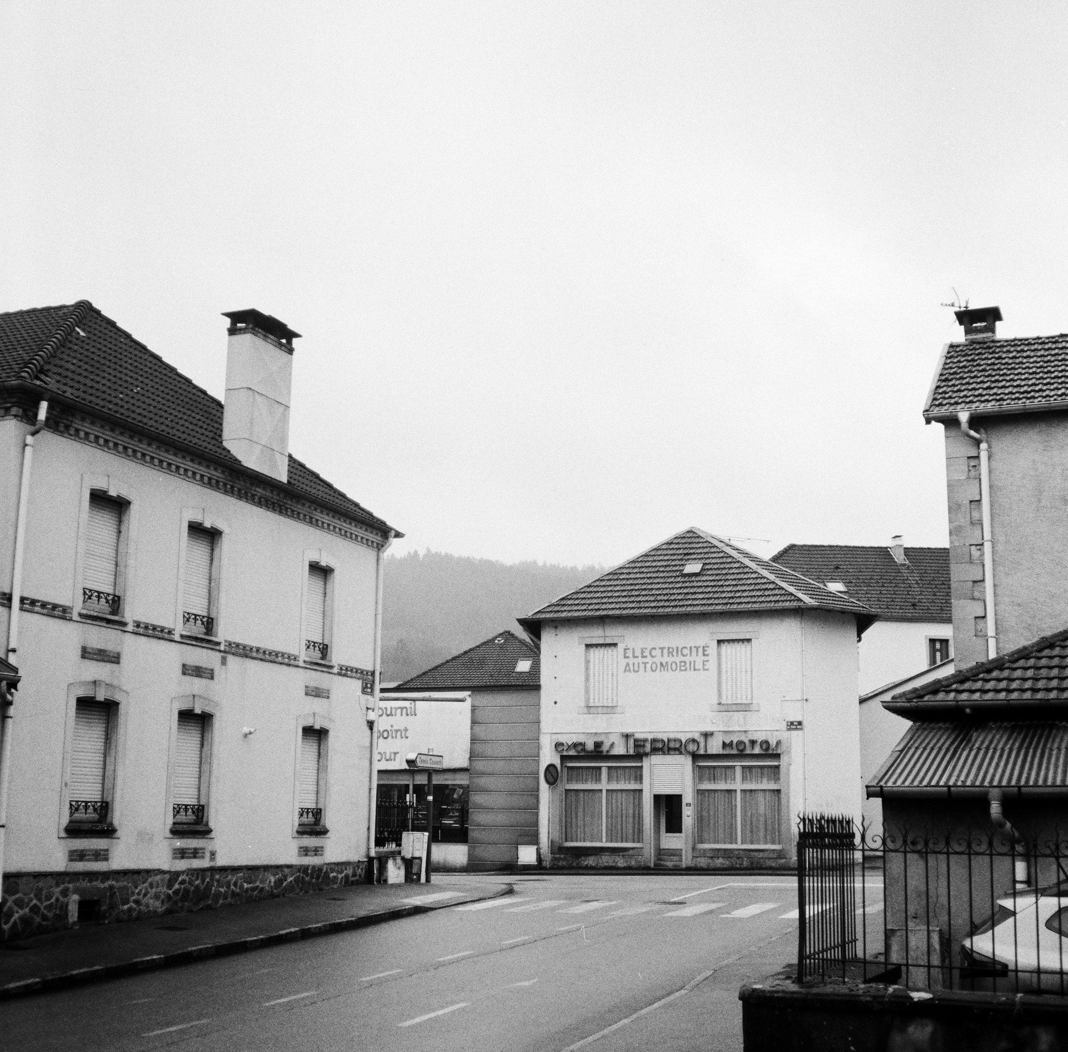

So, the scans are here, and the results are... not good. At least, to my eye. This is HP5 @800, developped by the lab in some Bellini product, then scanned by them on a Noritsu without adjustments. I only adjusted for the black and white points, no sharpening.
1) For the selfies, I focused on the Rolleicord letters, at minimum focus distance : they look... ok-ish, I guess, but definitely not tack sharp.
2) The 3 shots on the street were focused at infinity, on the roof of the most distant houses down the street : nothing appears in focus to me, neither near nor far. I think the closer one (with "automobile" written on it) was also at infinity, and it looks ok to me.
3) For the windshield, I focused on the 16, minimum focus distance. It doesn't look that sharp to me, but I'm not sure.
Anyway. Maybe it's the grain, maybe I moved when I clicked the shutter, maybe it's the scan, or maybe the screen really effed up the focus, I can't really tell... But I'm fearing it's the screen, because my older roll looked very sharp in comparison.

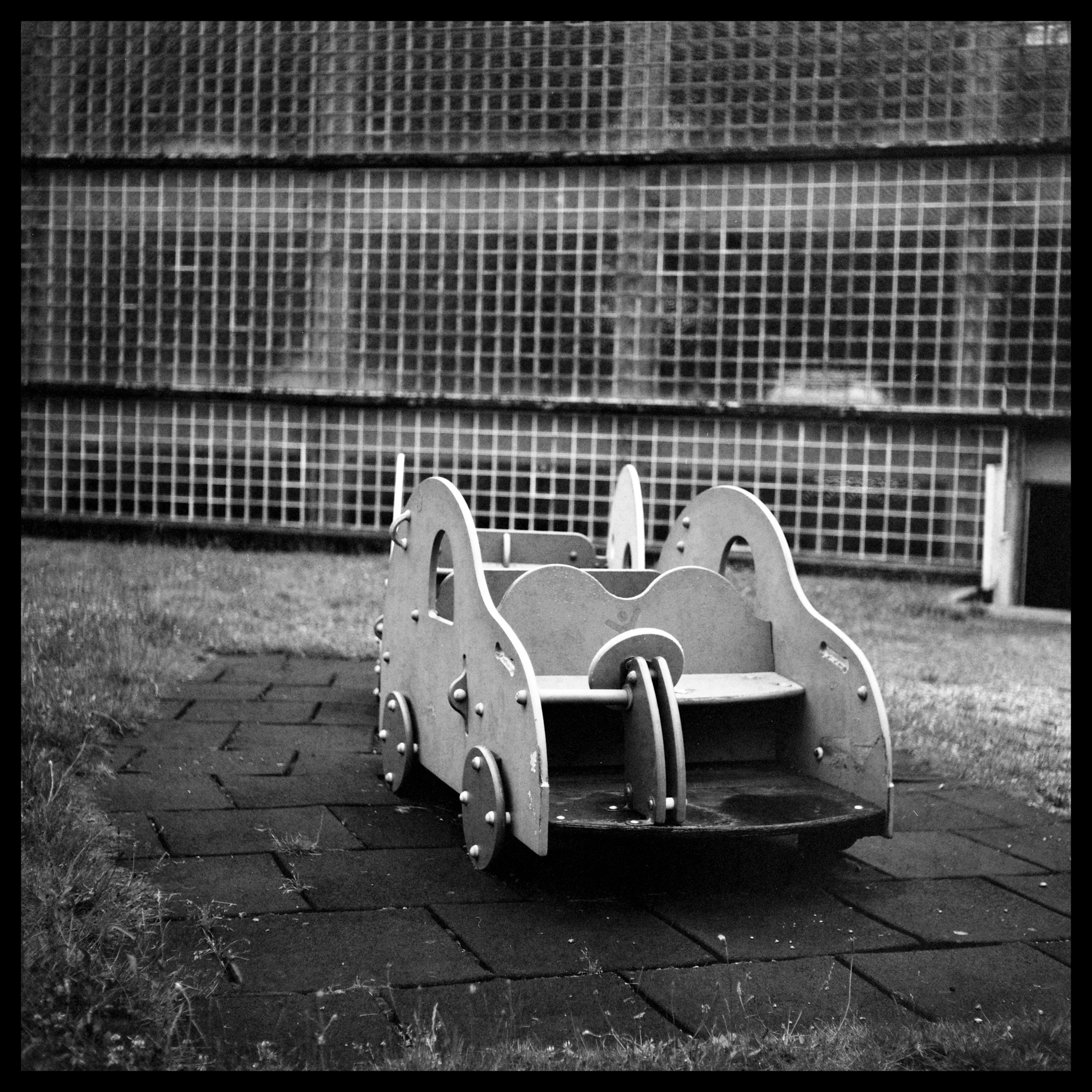

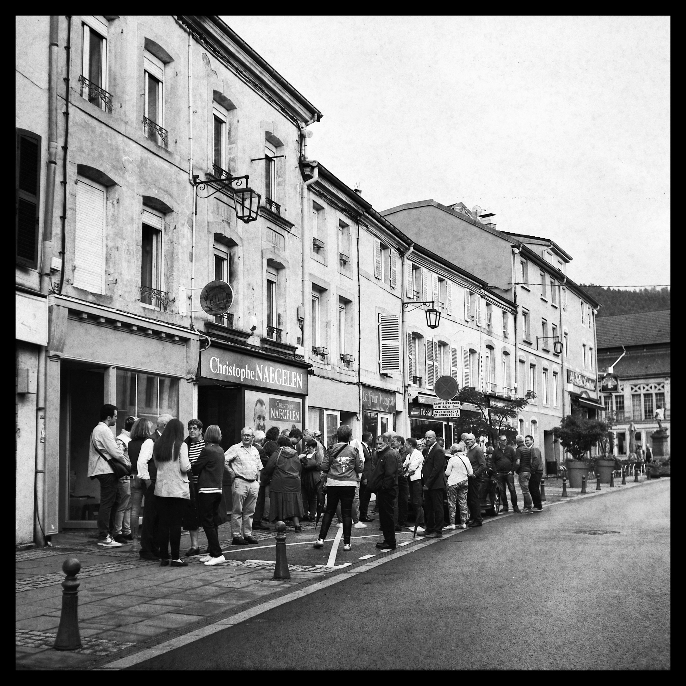

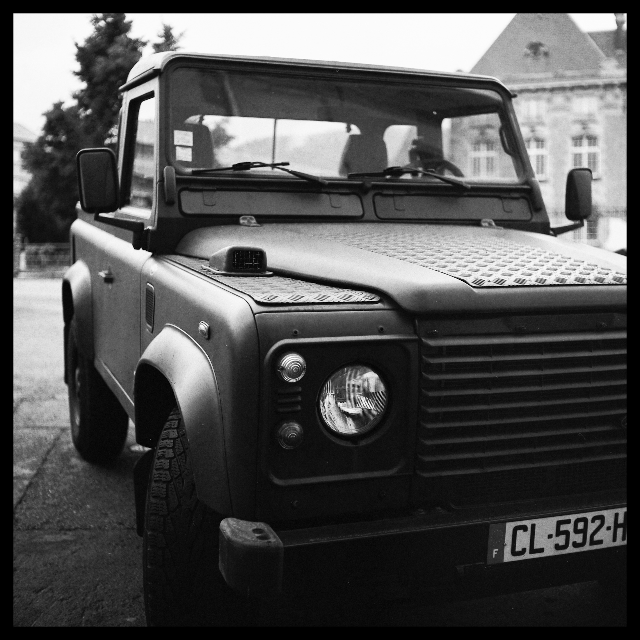

For comparison, here are 3 shots I took with the original Rollei ground glass. Shot on Rollei Retro 400, expired. They look a lot sharper to my eye.
Those photos look correctly focused to me. I think the softness originates from the wide-open aperture, which I suppose wasn't used on the Rollei 400 shots.

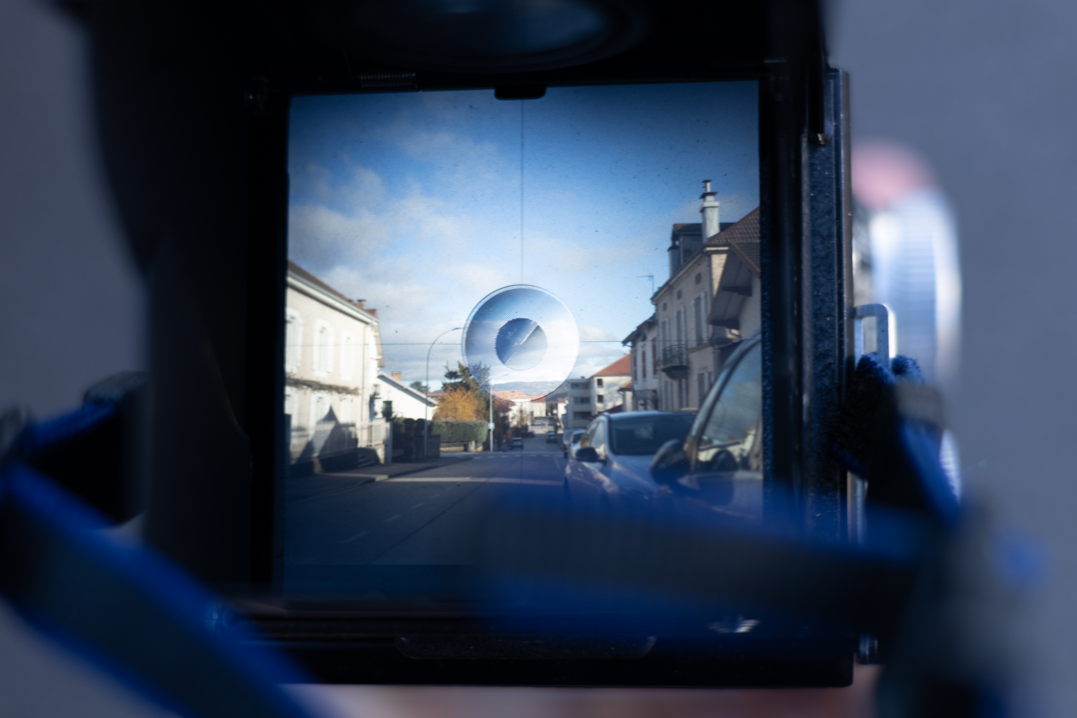

Do you have a digital camera with a long-ish lens? If so you can make a collimator of sorts, which is very useful for calibrating a TLR.

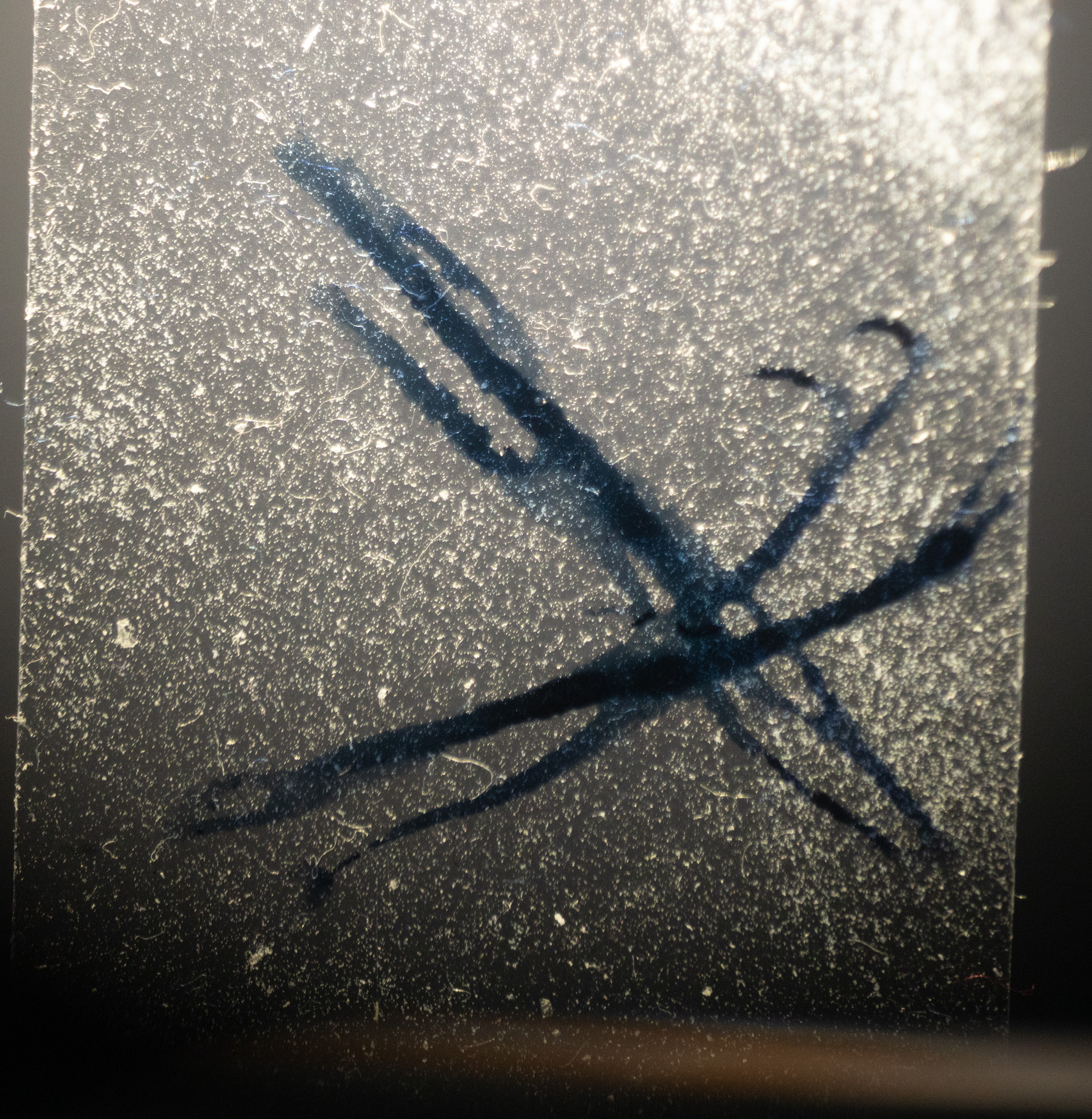

I looked online what that collimator test was, because I had no idea, and so I did it today, with my RF 85mm macro. The result is as I feared : the taking lens is calibrated properly at infinity, as you can see in that awful X on the tape that I shot, but when I look in the viewfinder, it's not sharp. And I think that what threw me off when I did the test roll is that dang split rangefinder in the middle. You can't see anything clearly in that thing (that's my bad for buying it). So I looked at the microprism instead, and it's very clear (no pun intended) : I have to roll the focusing knob back to achieve infinity in the VF, otherwise the image looks soft in the VF if I put the knob at infinity (I tried to take a picture, but I'm not sure you can really see what I mean). I have to set it somewhere between 60 feet and infinity on the scale.
So now, I'm just gonna have to sell the Rollei (too dark with the original screen), sell the Oleson screen, and get something else instead... I'm quite angry at Brightscreen for not mentioning anywhere on their website, in clear letters, that the products they manufacture are not matching the camera you order them for... Actually, it's worse than that, it's false advertisement : "We are equipped with an in-house CNC milling machine that allows us to machine a perfect replacement focusing screen for your camera".
Anyway, moving on. Thank you for that tip about the collimator, it was incredibly helpful !

@Yaeli laying scotch tape might not be very accurate. It's better to find a flat piece of glass or plastic. In addition, you can also look through the viewing lens with the collimator. You should see the magnified texture of the bottom of the screen, or the intersection of the split prism.
You also need to be dead sure that your collimator lens is at infinity. Not using the digital scale but by confirming the focus of a distant subject. Theses lenses will focus past infinity.
It's also a possibility that the viewing and taking lenses were out of phase since the beginning.
If you are going to swap the screens again, measure their thicknesses precisely.

I didn't have any piece of glass or plastic to use instead, so I did the "next best thing" - I really tried to make it very, very flat and perfectly positioned between the inner rails.
I used the autofocus on the EOS R on the clouds, and made sure it was in focus and locked afterwards.

@Yaeli A few things can go wrong in an improvised collimator. In your photo of the scotch tape, the top right appears quite blurry where it shouldn't. Finding infinity on clouds can trick the AF and it's hard to confirm on the photo; a higher contrast & detailed target like a distant building is better.
If you want to get to the bottom of this, measure the thickness of the screens. Halfway to 60 feet is approx. 50m/160ft or a 0.1mm extension from infinity. That can be adjusted.
