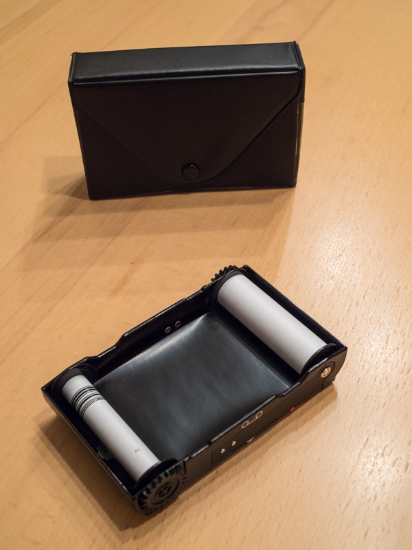

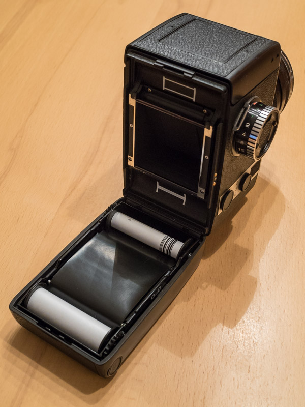

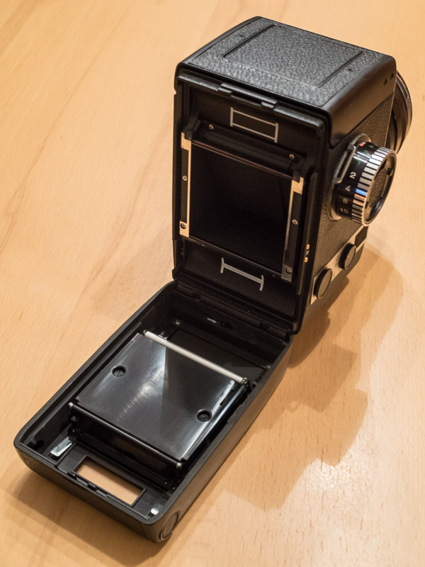

Yes, the back stays on. You flip it open, take out the insert and replace it with a pre loaded insert. The exposed film can stay on the insert and go into the pouch. The inserts are designed to keep the finished roll from 'unrolling'. But I haven't really done it yet, I only know that the rolls look stable as I take them out. I guess next time I shoot Fomapan (PET base) I'll have to try and see what happens when the film is in there for hours with all the vibration and shocks.
I have five inserts. One in each camera without a pouch for it, and three spares in a pouch each. Of course that takes a lot more space than taking a JCH 120 5x film case with you and load on scene.
I took some pictures, maybe that will help:
Insert with pouch. I put in a dummy film (Disclaimer: that is backing paper only, no film was harmed or tortured for this). The start line is visible on the other side right in the middle by the markings on the insert. Second picture is the open back without insert, third with insert. The insert is symmetrical, so that you can keep the empty spool in place. Just place a new film in the empty position and replace the insert such that the the fresh film will be in the top position. Close the back and hit the shutter, usually twice, and the camera will forward to the first frame.
