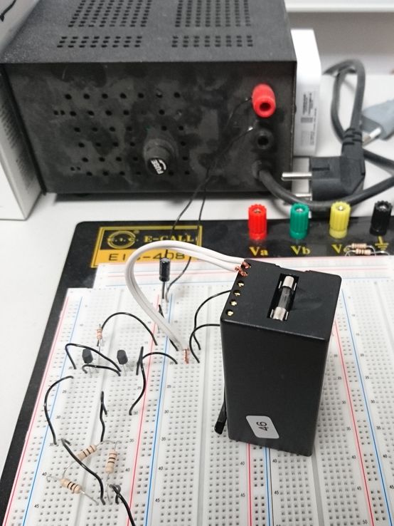

It's true that (defective) battery packs are quite expensive on Ebay. My first SLX came with two, one dead the other an original Rollei spare, once bought by the previous owner. Probably still NiCd, but in working condition. I rebuild the other myself. A suitable cell pack is ~€25 from a small business on Ebay.
I bought a second SLX which came as a complete set in a Rollei leather case. There were two or three dead battery packs in there. I'll rebuild one more and convert the other into an adapter for external power, in case I ever visit Antarctica.
A charged pack will last months for me. I just charged both packs, just in case, as I'll go on two weeks photo holiday in East Asia next week. The original packs supposedly last 1000 frames. The modern NiMH cells have much higher nominal capacity (in mAh).

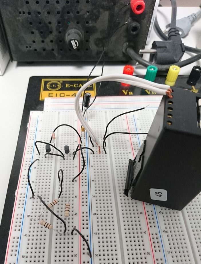

The real problem with lies with the charger. I only have the primitive SLX chargers which didn't charge. I opened the first and I'm glad it didn't work. The input voltage selector is quite interesting and resulted in an open circuit when I moved it. Its difficult to describe the design, but it has zoo much play.
Unless you have a more modern 600x with proper charger I recommend you use something else. Perhaps a semiprofessional NiMH quick charger for cell packs.
I jury rigged a slow charger for first use and I've been using it ever since. Its on my desk at work. I use an ancient 1960s lab PSU (13.8V/6.5A) and put together a constant current source on a bread board. It's charging with ~115mA. Charge for a work day and perhaps a few more hours the next day and its good for a few more months. Given the voltage drop at the transistor the 13.8V of the PSU are maybe a tiny bit too low to get to a full charge, but that doesntt really matter to me. Here's what it looks like.
Your right about how long the battery lasts, my 6008 came with a freshly rebuilt battery block, it lasts months at a time which is impressive given what it has to power, probably only recharged it twice this year. I have to say it did put me off before purchase but now I don't really think about it except for the fact that its driving me towards buying another 6008, a spare system seems to be the most cost effective way of having any of the items as back ups, spare batteries and chargers are ludicrously expensive.
I just noticed that the board software converted all my tilde characters into dashes. Those dashes are meant to mean 'approx'.
I forgot to write why I don't wish to use the charger, even with working input voltage selector. The design of this model is extremely primitive. It consists of the transformer, a rectifier, a resistor and a lamp (which acts as another resistor). The resistors get the charging voltage roughly to where it should be. But there is no capacitor to be seen. That means that the battery is exposed to a pulsating voltage and current, which the cells are not supposed to enjoy very much. At least to my knowledge.
I looked at the PCB and there are lots of copper paths and through holes that are unused. I take it that they could actually produce a proper charger by adding components. But mine is the low budget version.
