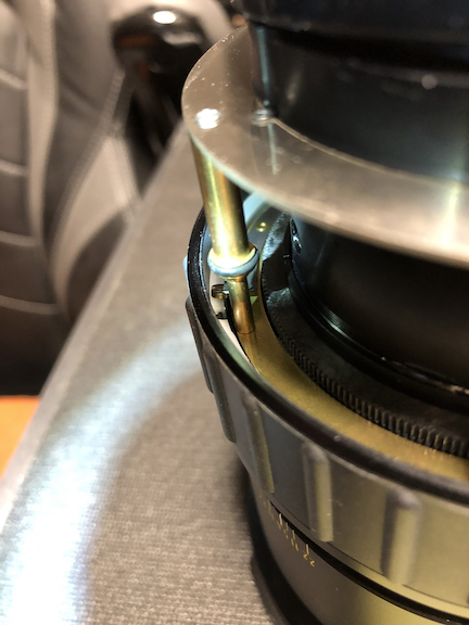

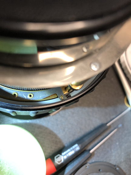

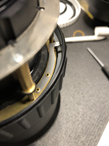

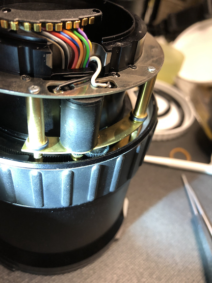

A few years age, I had the same problem - the focus ring was intermittently stiff at a couple of positions, it quickly got worse to the point where I couldn't even move the focus ring by hand.
Not finding a good place to repair it, i decided to remove the outer shell and take a look.
There is a white plastic ring deep inside that a couple of metal pieces rub along.
It was broken in a couple of places so the rotating action was no longer smooth.
As I moved it back and forth to see if it would loosen up, it developed a couple more breaks. The plastic had turned brittle. Unfortunately some plastics turn brittle with age and crack.
The lens has been sitting in pieces since.
I can't say if your problem is the same, but it sounds like it could be.
