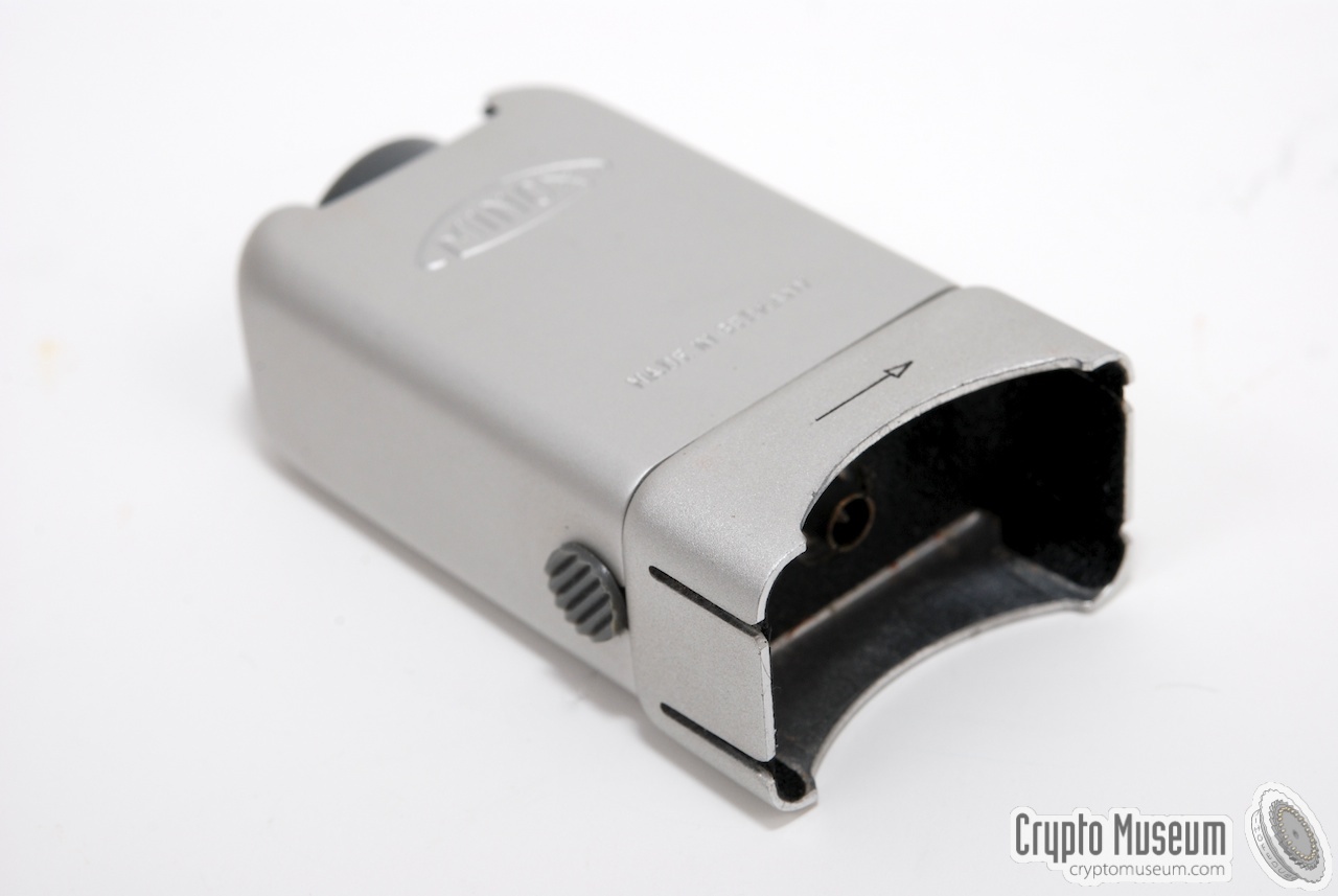

The interesting thing with the model 110 adapter for flashcubes is that it got a shield at the photographers side.
So far I a have not seen such at any flashcube appliance.
But with Rollei A/E 110 cameras the flash is at eyelevel, unlike most larger cameras. Maybe at Rollei there was fear that, by whatever circumstance, the rear bulb could fire (too).
The shield is just the lid to protect the contacts of the flash unit when there is no cube. It has to go somewhere when the unit is opened, to the rear seems logical.
Flashcubes usually contain ordinary AG-1 bulbs which have 2 contacts. So there is only one bulb connected. Rotating the flashcube brings the next 2 contacts in place. So it's impossible that the rear buld could flash.
As said, Magicubes won't work.
But no camera or cube flash with such protecting cap I remember.
A rear bulb could be ignited if the reflector, which just is a piece of vacuumfornmed foil (as in sweets boxed) is faulty or missing.
I once bough a great lot of flashcubes NOS, that all got their caps and thus their reflectors not fixed. No idea whether at Rollei they thought of such.

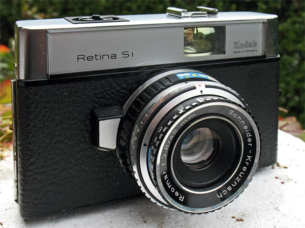

If you like flashcubes:
Mid to late 1960s, and it and the meter equipped S2 are the last of the Retina line.
It suffers in comparison to the other Retinas, but I used one for years during my youth, and was very happy with my Kodachrome slides.
Both offer a choice of flashcubes or electronic flash via the hot shoe, and the scale focus was coupled with the aperture for flash use - you could set the guide number of the flash on the camera.
