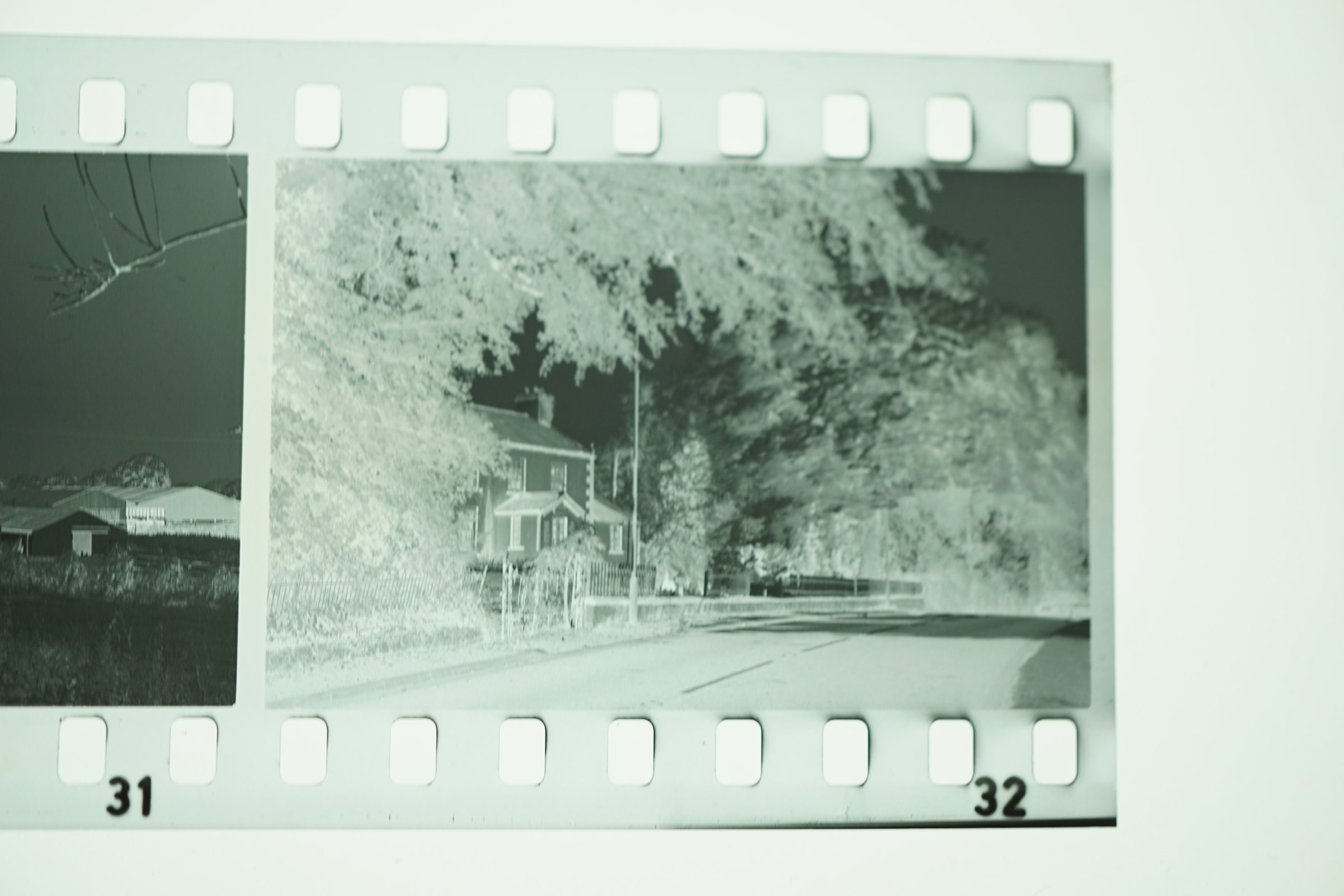

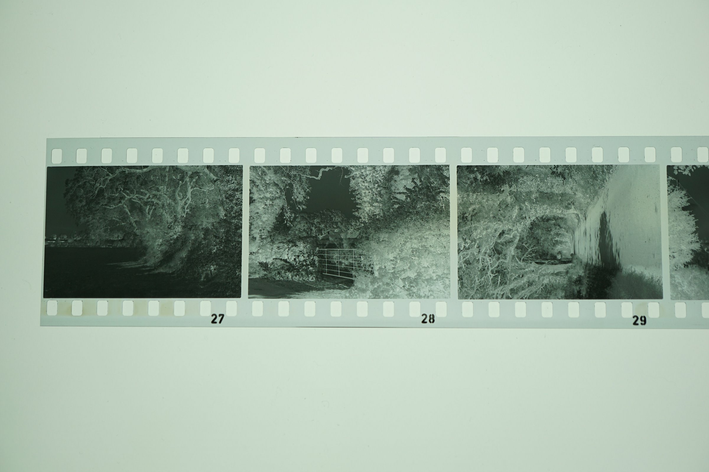

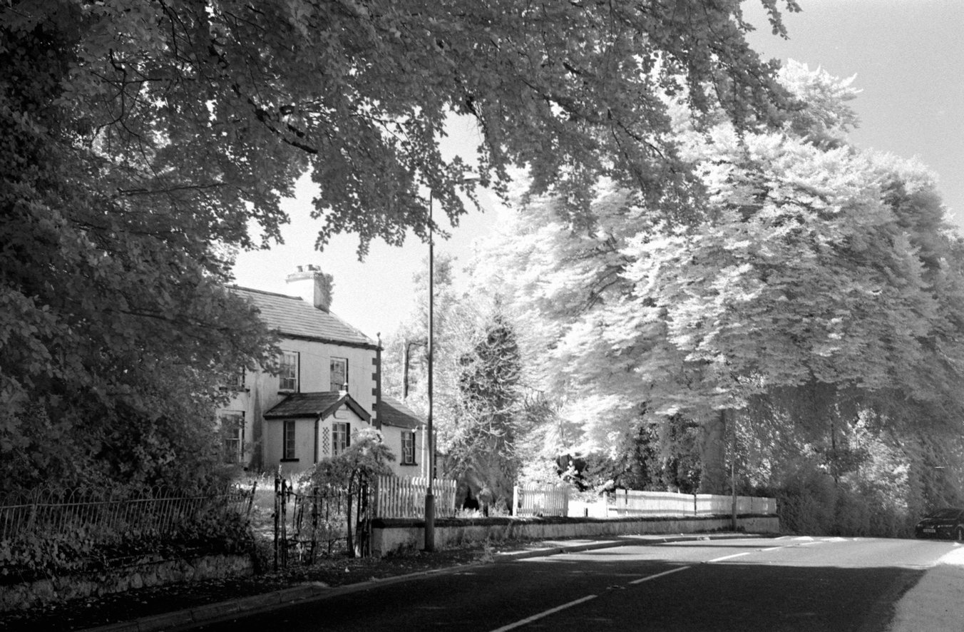

Back on the question of the film's speed, I've been going more or less by the book, treating it as ISO 400 and applying a filter factor around 8 with three different Leica filters - an A36 IR, an E39 IR and a Summitar Rd (dark red). Visual comparison of the filters shows differences, the Summitar being the most opaque. But they are all fairly old and can have altered over the years.
As the "maker" suggests 5 minutes in HC-110 dilution B, I began with Ilfotec HC 1+31; but then a dealer introduced me to Bellini's Euro HC, which I really like and use at 1+31. It's a doddle to mix as it's very fluid.
This seems to me to produce acceptable results; so here are photos of a strip and a single frame on a light panel, plus a straight scan of the single frame. The panel photos are shaky - forgive my elderly handholding. This roll was exposed with the Summitar.
There are always so many birds here that that is never a problem, beside the discussion is about the Wood effect with IR film and not wildlife photography.
A bird in a tree with a 135mm looks nice in IR. So insects.
This seems to me to produce acceptable results; so here are photos of a strip and a single frame on a light panel, plus a straight scan of the single frame. The panel photos are shaky - forgive my elderly handholding. This roll was exposed with the Summitar.View attachment 350538View attachment 350539View attachment 350540
Which filter did you use for house and tree photo? The strongest one?
