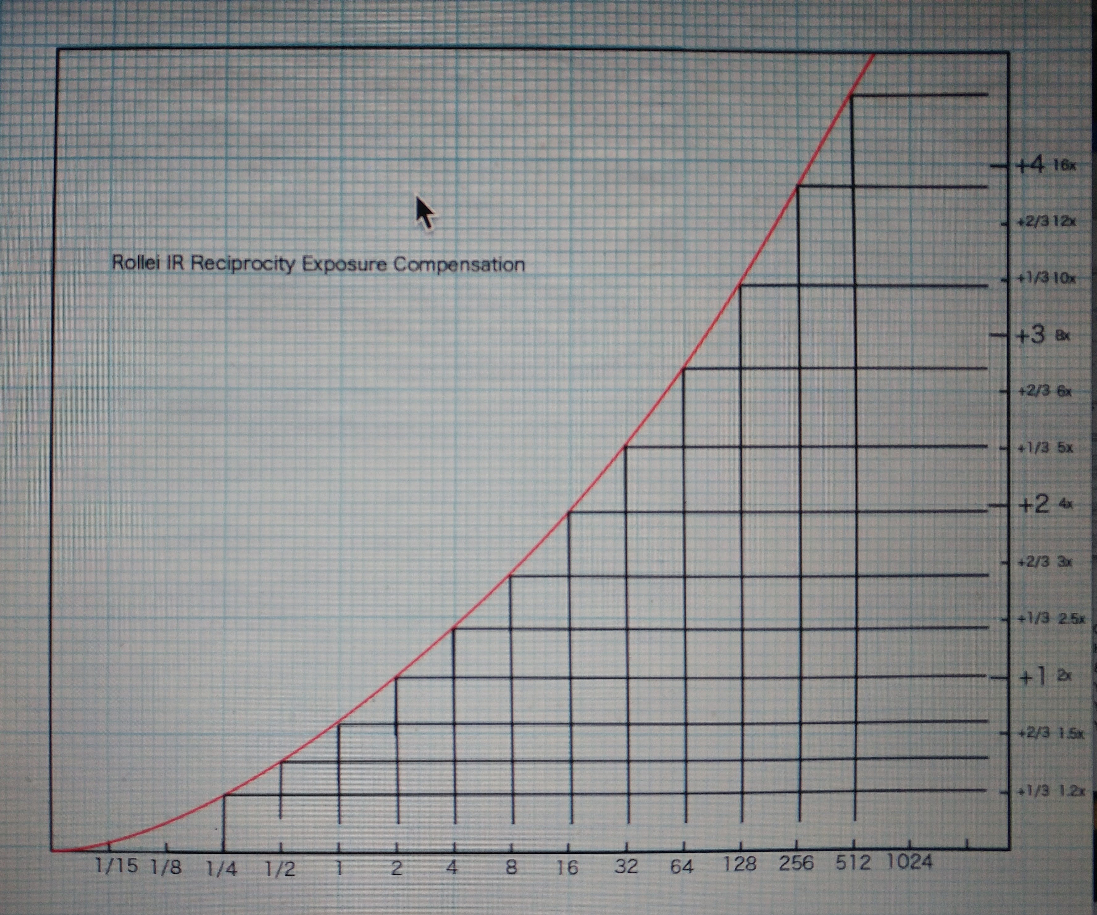

Yes. At least have been for years. I have data that I generated several years ago, and have tested in the field. Here is my compensation chart:
(metred on the bottom, correction on the right)
Thanks Andy! That's a big help and saves me time digging around. I'll buy you a donut when we meet.
