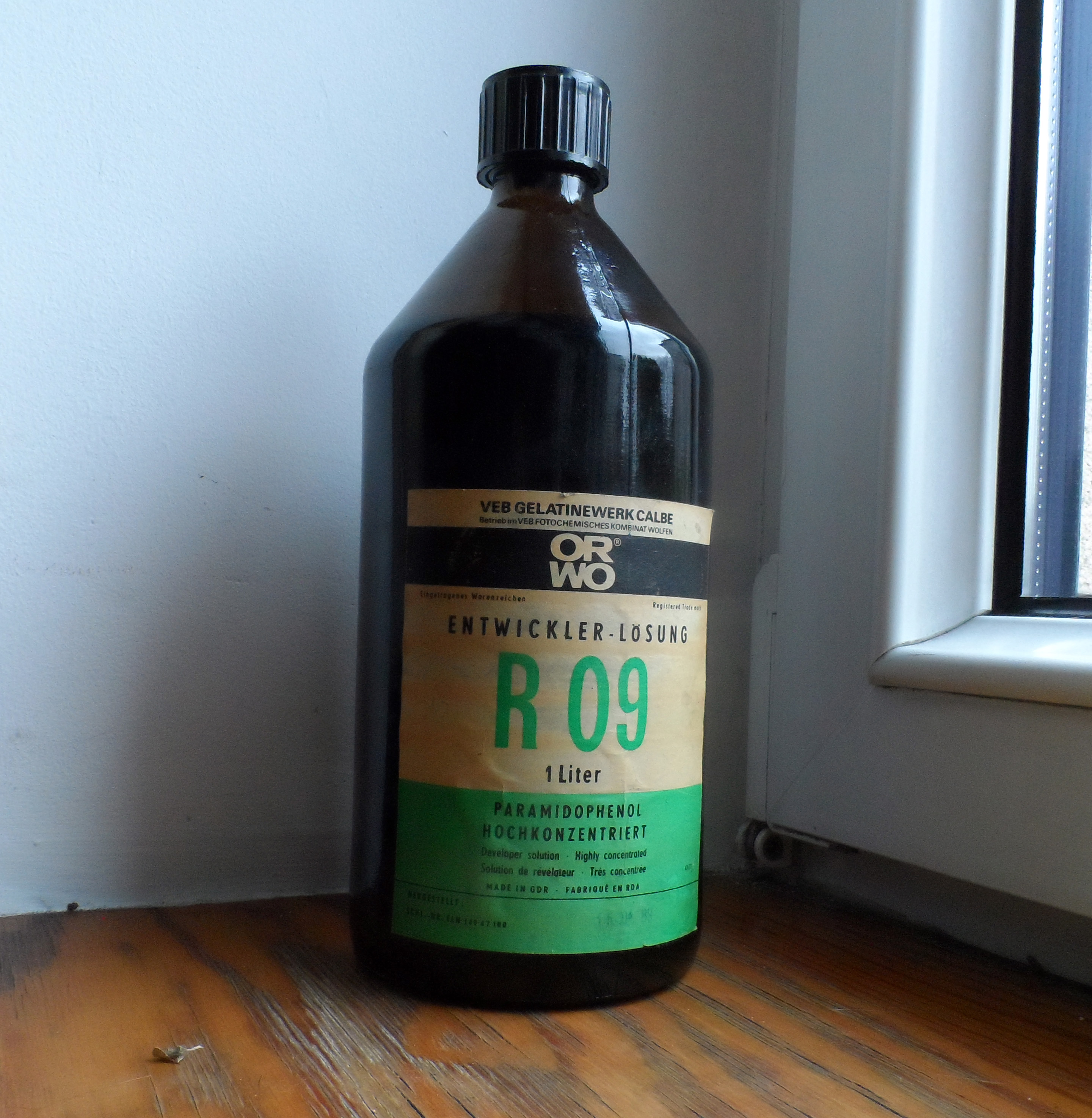

Last year I found a bottle of ORWO R09 (the East German equivalent) from the 80s among my dad's old photo things. It sat in the attic for over 30 years, under an uninsulated roof which means it got cold in the winter and hot in the summer which I'd expect would be more likely to kill it than just the passage of time. But it works perfectly fine. It's very dark but doesn't even have any crystals or sediment on the bottom. Indestructible stuff.
