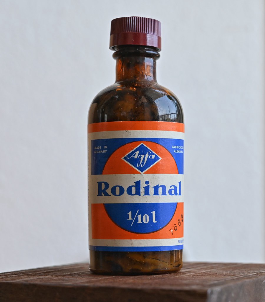

Unopened.
Unknown age (but pre Gevaert fusion).
Brown glass bottle with a beautiful bakelite cap. The cap was shrink wrapped in some “cellophane” like material which crumbled to dust when I touched it.
The content is completely crystallized.

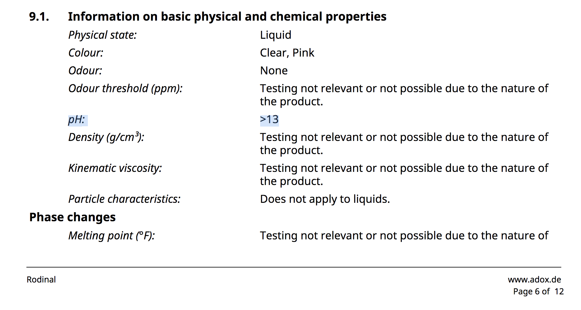

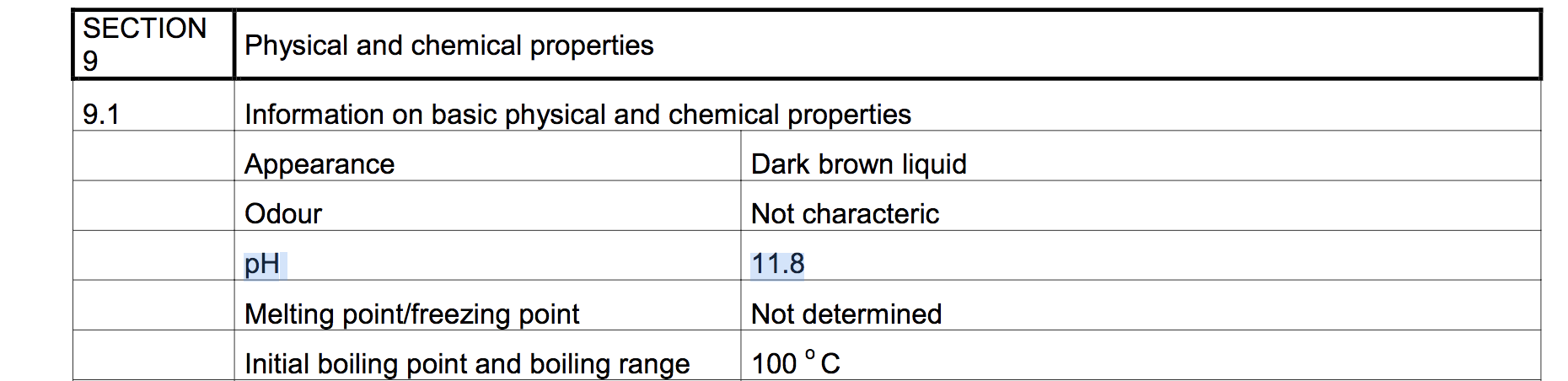

I also want to add that Fomadon R09 has a pH of 11.8 whereas Adox Rodinal/Adonal has a pH of >13. I bet the higher pH/higher hydroxide content in Adox's version allows it to keep better.

I really doubt that; I'd expect the opposite. Higher pH means in principle there's more opportunity for the developing agent to oxidize and be rendered inactive. In rodinal, a copious amount of sulfite is present to provent this from happening.
The hydroxide content will need to be set such that the target pH of the working strength developer is met; this by necessity will have to be the same pH for the foma and the adox product; both are supposed to Rodinal variants/clones, after all, so logically the working strength solution will need to be equivalent. Both are based on potassium hydroxide so we can quite safely assume that the amount of hydroxide in both these products will be roughly the same.
The difference in pH is likely due to the effect of adjuvants (note e.g. the zinc powder) in the bottled mix; I personally wouldn't pay much attention to the pH of a rodinal concentrate since it can be qualified in any case as "godawful high". In the end, it doesn't really matter whether it's nearly 12 or over 13; either way it's as alkaline as things can realistically get.
pH of zinc will not get to that high. pH of hydroxide will, since well, it's literally OH- that raises the pH level. We are not talking about working strength solution pH but stock solution pH. So if everything else in Rodinal is exactly the same for both Foma and Adox products, then the only reasonable ingredient that can raise it's pH from 11.8 to 13 has to be more hydroxide.
Just do the math using different concentrations of NaOH with these pH numbers. You'll realize that there has to be more going on and that a difference in NaOH concentration cannot be the full story. Keep also the w/v percentage of NaOH listed in the SDS in mind.
