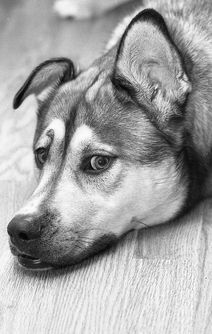

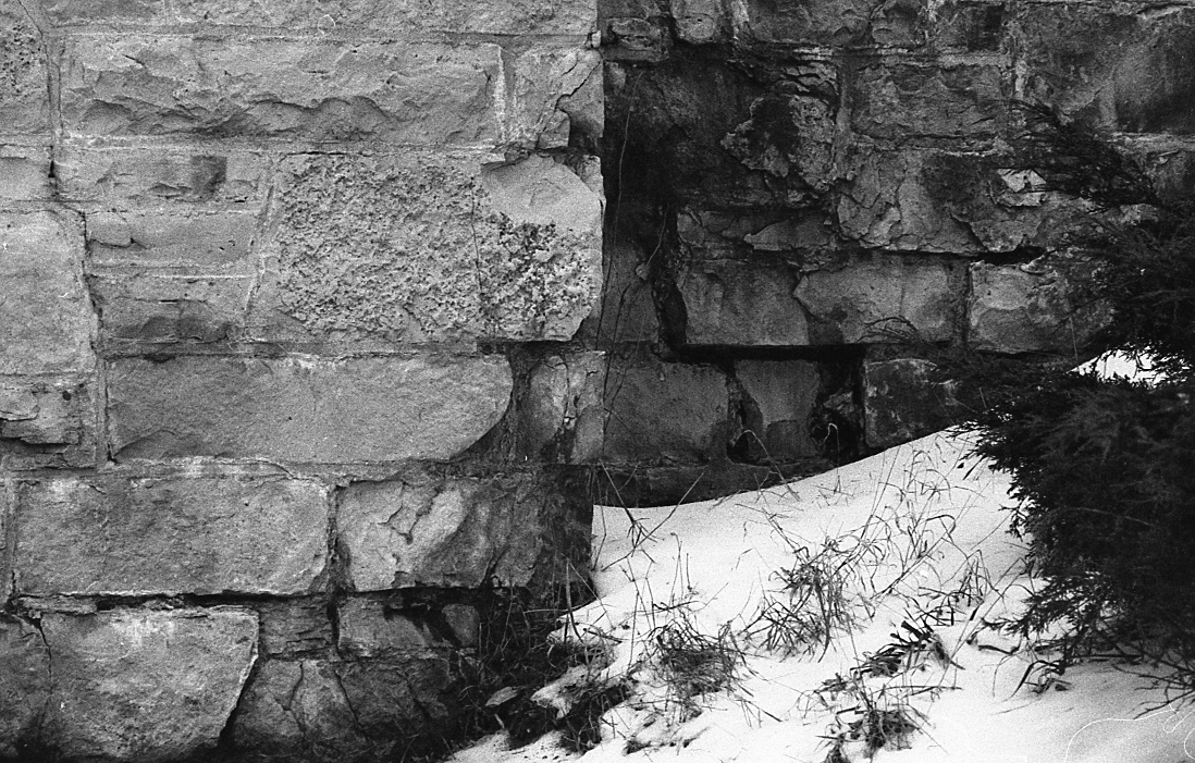

Here's a couple of goof off test shots to compare if you'd like. The dog is Kentmere 100, the wall/bush is Kentmere 400. Stand dev in Rodinal 1:100 for one hour, 10 sec agi every 20 min.
I was just shooting whatever I came across for testing purposes.
Maybe not the greatest film/developer combo, but I think it's pretty good, especially given the cost.
Scanned with an Epson Perfection V500, which I'm borrowing from a friend, and still fiddling with. No digital ICE, or processing - just straight out of the scanner. They could be cleaned up and made to look better I'm sure.
Wow very sharp and lovely contrast on the dog!

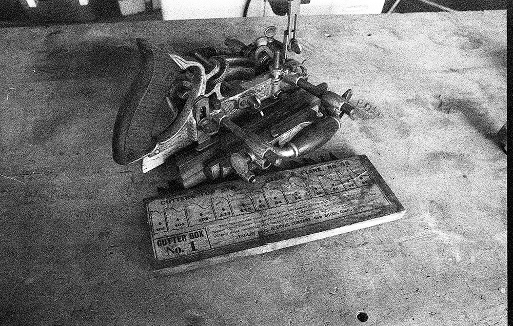

I knew I'd tested some HP5 + using the same stand method I mentioned before, but I couldn't seem to find the negs before I made my post. Of course I'd been looking without seeing...
I bought a bulk loader on the bay a while back and it came with some HP5+...old stuff based on the seller's remarks.
I chalked the results up to it just being old, but I wonder how it compares to what you've gotten?
Nowhere near that bad, it just seems to be a lessening of "resolution" rather than graininess. I'll try and find an example, Fomapan when zoomed in too closely can appear like a turtleshell, weird I know I'll find a scan at home.
