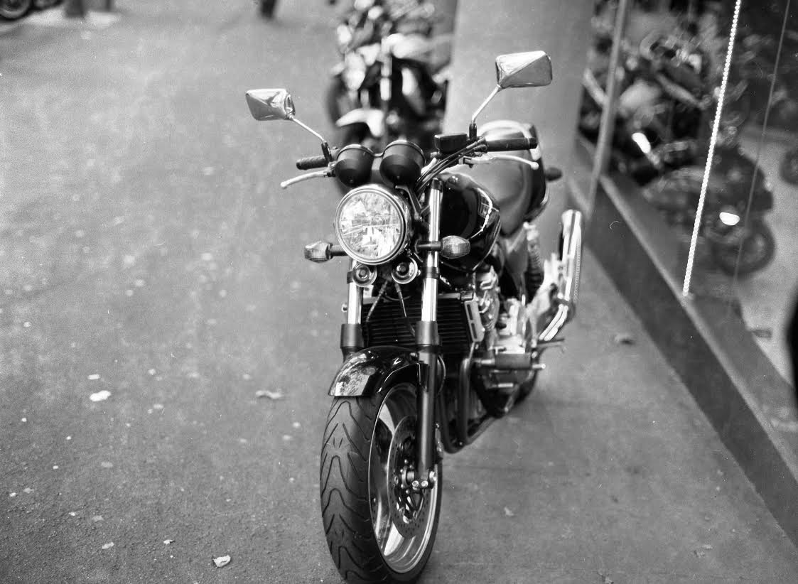

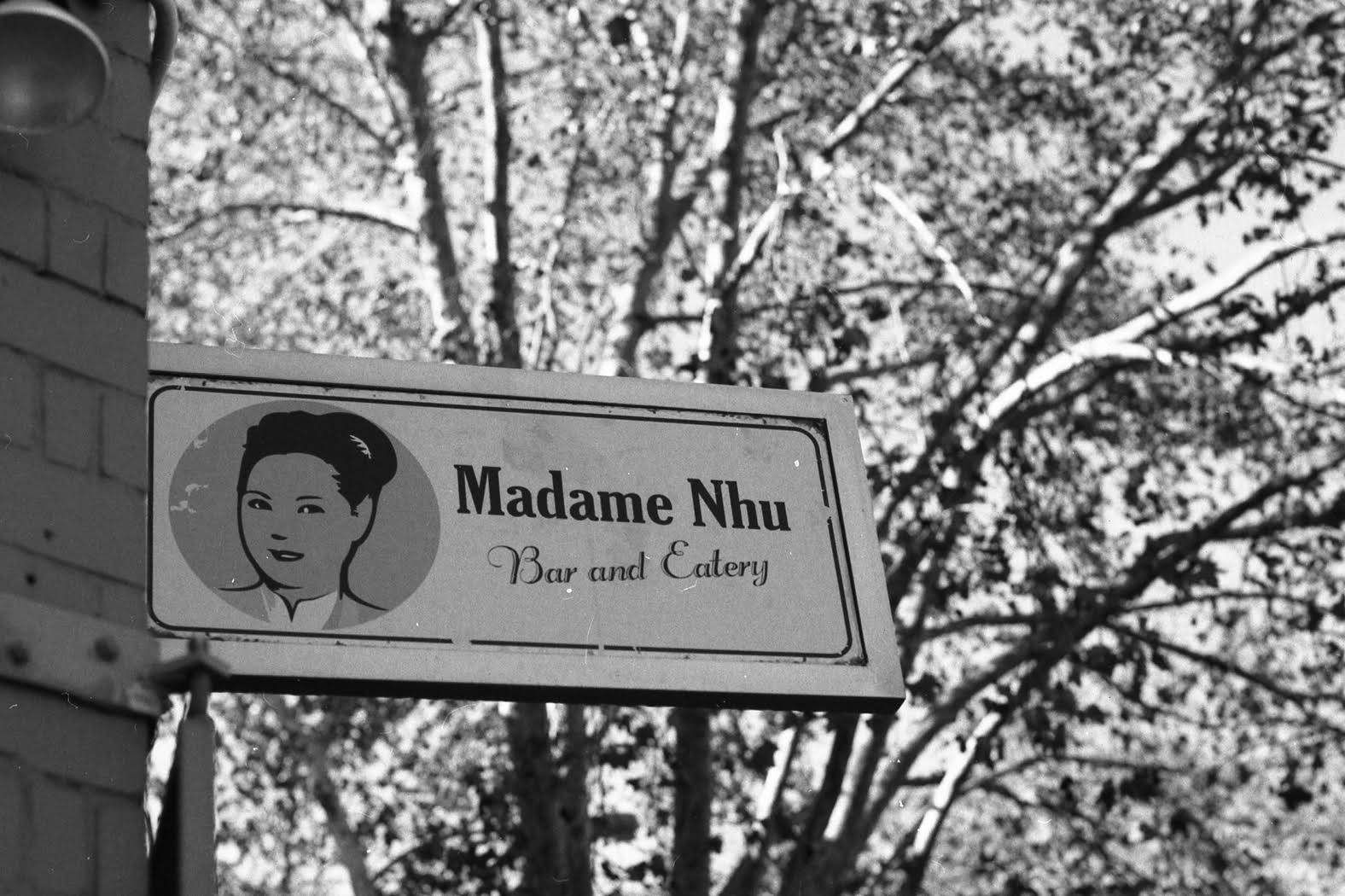

Thanks everyone. I've got back and found some scans and also shot a new roll of HP5+ with a new (old) RB6x7 I recently acquired (Side note it's a really nice machine).
I scratched the film up to buggery trying to get it onto a patterson reel that's probably older (it had no trouble with GP3 or Fomapan), the Ilford film was very smooth, and didn't gain appropriate friction (and my reel didn't stick exactly right) lessons learnt, use my newer reel for Ilford.
Here's a rundown:
Box of film: HP5+ Rodinal 1+25 6 minutes [RB67]
Sign: Fomapan 200 - Stand developed [M656 PRO]
motor cycle: GP3 100 Stand developed [M645 PRO]
attachment.php
attachment.php
attachment.php
I really have only good things to say about resolution (and even perhaps grain) of GP3. Sure it curls like a piece of fruit in the sun and the blue anti-halation needs to be washed out thoroughly or it may leak/stick.
I've been disappointed resolution wise by Fomapan - Should I switch to the 100 and it would look as good as GP3? I've been told the 200 is 'creative', I'm not 100% sure I like it that much.
Rodinal + HP5 gives a salt/peppery look (given results I've seen Fuji Pro 400H come out like and that's a colour film I feel its safe to say its not optimal?)

HP5+ or Kentmere 400 may be better 1:100 20C full stand 50-60 minutes.

What's kentmere? I've heard it mentioned but it seems to have never been available in Australia.

Your have exposed the sign which is in the shade.
- It may need bit more exposure to have certain brilliance.
- Remember Foma films builds contrast rather very fast, which is obvious in the case presented.
- Test all films with same scene and with similar lighting conditions.
Fomapan 200 is very good film.
Expose at E.I. 100 and develop 20% less with Rodinal.

Thanks, I will try it more, and keep that in mind.
I like Foma, or I am trying to as I learn more about it.
It seems to have great potential at a very good price point (even cheaper if I get the purported arista version), I just realised GP3 has been discontinued!
