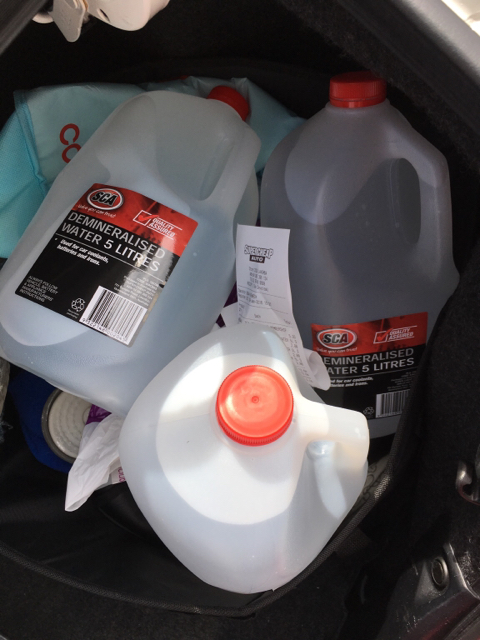

I just grabbed 15 litres of distilled water so I'm going to give it a go, using it for the final bath in Photoflo should be enough?
I imagine I'd use a lot if I have to use it for the developer too, at least fixer and stop bath are reused.
FYI anyone in Australia it's currently on sale at SCA for $2.88 per 5 litres.
FWIW, those labels say demineralized water, not distilled water.
Two similar but different things.
Demineralized may, however, meet your needs.
Thanks, you're right. If my understanding is correct it would solve the mineral deposit issues, but not any PH concerns (which I don't think there are)
