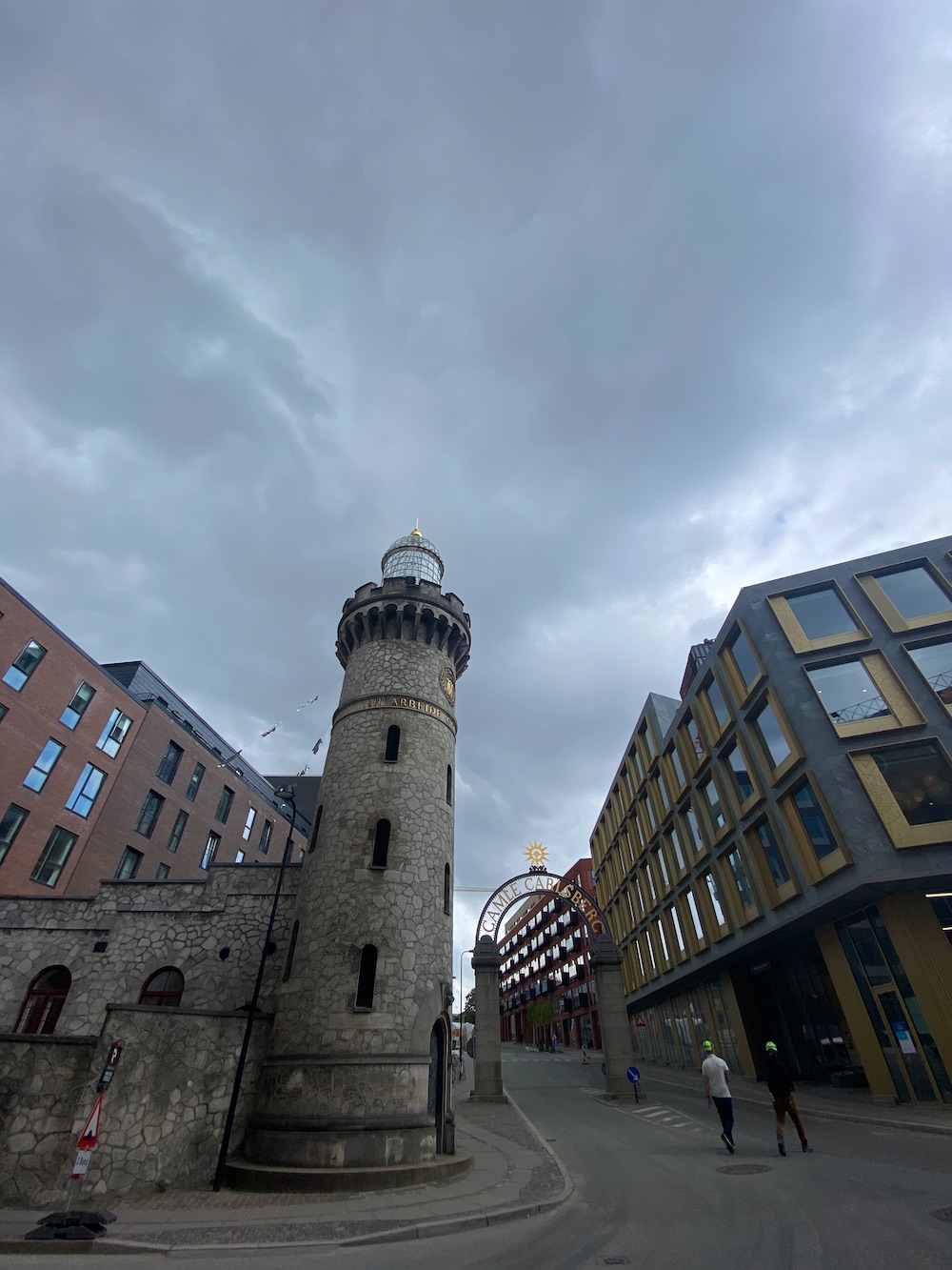

In case anyone is really in doubt. Simple shots from a wide iPhone camera.
The first one is equivalent to what you do with shift (I imagine) expect the bottom of the projection would be cut off by the film plane.
Shot straight on with a lot of "distortion" or elongated perspective at the top.
This one has the top of the tower in the middle and is how a human would perceive the structure if free to look around. But of course the structure appears to be tilting away from you, something we are familiar with through vision, but that is again corrected by the fact that we are scanning with our eyes and head and not analysing stills.
The last one has the lens looking down to get sort of the opposite effect of the previous one, of the tower leaning towards you.
My original question is: Does shift as it is used on LF and other shift lenses, use this effect (for lack of better term) to correct converging lines?
Namely mostly the effect in the first photo where the "film plane" is parallel to the vertical structure? But the same basic principal goes for the all of them.
All 135 shift lenses are some kind of wide. That would support what I'm thinking?
So yes, it is in essence perspective I'm talking about. Namely near vanishing point perspective. Or wide perspective if you will.
