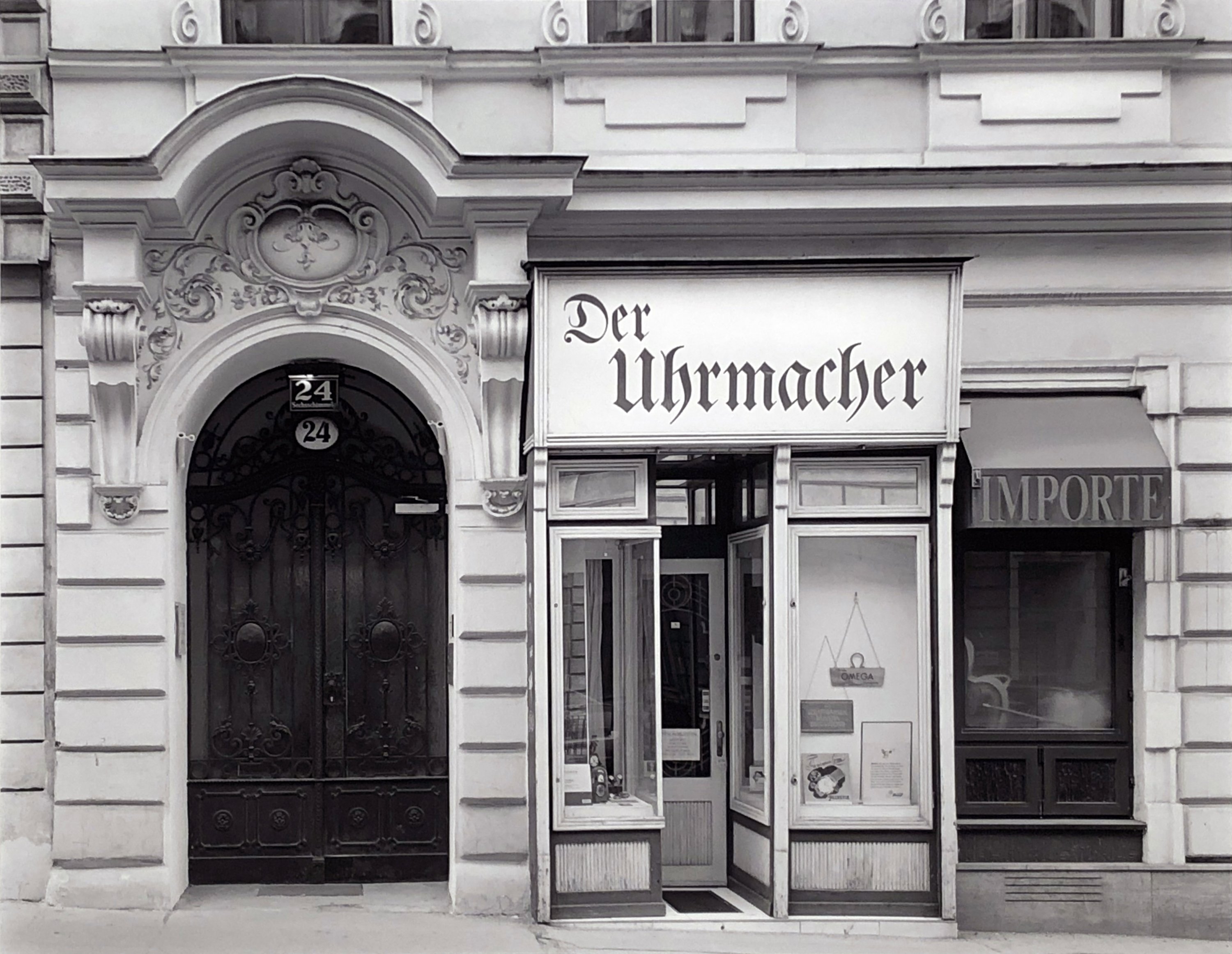

Deciding on the position of the optical center of the image, as you and David discuss, is often an image-making goal in itself, but often ends up being a side effect of correcting convergence. Anytime we use rise or shift, we end up displacing the lens axis from the center of the image, thus moving the "optical center" of the image away from the actual center of the frame.
Here's an image where I intentionally used shift to keep the left arched doorway on the lens axis. Note the "straight-on" viewpoint of the door compared to the obvious side view of the middle door. The result is an intentional "distortion," if you will, which gives the rendering a more geometric-drawing feeling than a straight-on image would.
The same thing happens when using rise, just displaced 90°; the "optical center of such images is always lower than the center of the image. This is the main difference between using front rise as opposed to just moving the whole camera up to frame the image while keeping the verticals parallel.
