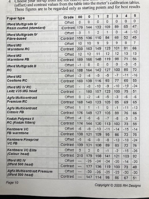

The standard used was MG IV so the offset would be all 0's and I guess they still ship with that standard preset. You listed the settings for MG V in first post: "On the RH Designs website the following settings are listed for MGRC V : Offset -1, -8, -4, -2, -3, -4," which would be an update from original production I guess.
Image from original calibration Manual 2005.
Here is a PDF of 2005 Calibration Manual if anyone is interested.
  • AP Cal Man.pdf

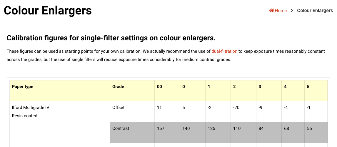

Yes I see that in the manual. However I was looking at the RH Designs website for colour enlargers (I have a Durst M670)
From the simplified calibration guide on the RH Designs web site.
The analyser’s default settings are based on Ilford MG1V RC deluxe, with under the lens
contrast filters. If you use, as I do, a dichro colour head, all the settings will require
recalibration
I switched from an enlarger with above the lens Ilford filters to an LPL with dichroic color head and my previous calibration was way off for my new enlarger.
