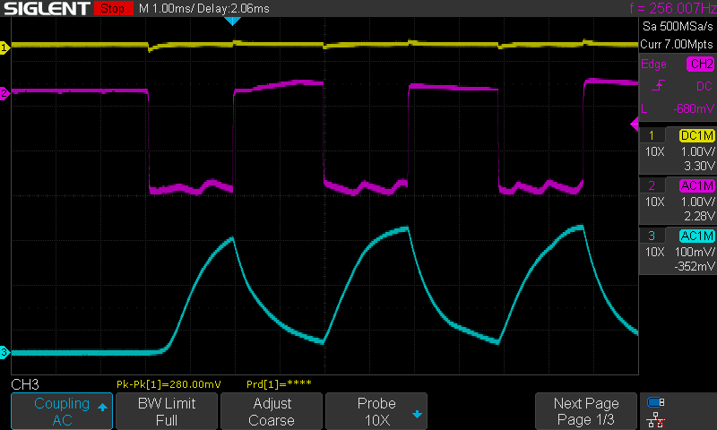

Per Koraks' suggestion, here are the oscilloscope traces of the + and - inputs
Well, to be honest, I never suggested this particular measurement, but a voltage trace across a small value resistor in series with the LEDs. What voltage the LEDs see isn't particularly interesting due to its non-linear relationship with light output. It would be much more interesting to see the correct that goes through them. My expectation is that the 0-signal 4 to 2.8V output doesn't do anything in terms of current (and it may or may not be due to an output filter cap; it's a buck topology driver so it may just be driving the switching FET just below the set current threshold) and that the rounded corner on the onset of the duty cycle will be there in a current measurement and not be (purely) due to LED V/I characteristics. As you see, an actual current measurement takes away much of the guesswork, which is why I recommended it before as well.
Are you planning to use a LUT for color as well? That sounds like a big table; see my earlier remark on this.
I'd be wary of a 10% deviation for color printing, but maybe it isn't half as bad in reality as it would seem in my head!
albada
Apr 10, 2008
2,175
Escondido, C
I'm slow on the uptake, but I see now why a current measurement is better. It's below. The top two traces are both sides of a 3-ohm power-resistor, and the bottom trace is the phototransistor.
Now it's clear that I goofed (which koraks probably suspected the whole time 🙂). Mean Well is outputting approximate square waves, yet the scope is seeing RC smoothing of them. A calculation tells me the 20 pF capacitance in the probes can't do that, so it must be that the phototransistor (Vishay TEPT5700) responds slowly. Its datasheet says it's for measuring ambient light, and it makes no claims about response time/frequency. I should have known better.
For each color, I use a LUT to convert the attenuation of that LED-chain into its PWM. Attenuations (i.e., stops of dimming) are in the range 0.0 to 6.0 (in steps of .1), so that's 61 entries. Three colors means that these three calibration-tables consume 183 entries, which is small. The theoretical curve is PWM = 4096 / 2atten, and my calibrated-values in the LUTs don't stray by more than 10% from that formula.
I calibrate a color using the easel-meter by Darkroom Automation. After calibrating an entry, with the LED on, I calibrate the next entry by reducing PWM (using the rotary encoder) until the meter shows exactly 0.10 stops less light. Calibrating all 183 entries takes 30-45 minutes, which is tedious, but it's only done once.
So I don't have a big color-table. Rather, I have three small tables that ensure attenuations are accurately converted into PWM values.

Thanks for the follow up, this is very clear and looks much more sensible indeed :smile:
I indeed sort of evaded the issue of your sensing circuit because I knew a direct measurement of current would eliminate this variable. Anyway, you now have a pretty decent way to determine actual LED current.

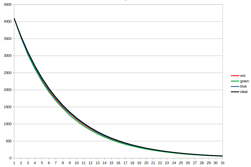

Now you could (if you're interested) check the linearity of your LUT tables by comparing the LED duty cycles to the color values reported by your meter. The reasoning behind this is that non-linearity of overall LED output will be pretty much insignificant above a certain threshold PWM value (very short pulses tend to suffer from issues depending on the driver and PWM frequency).
It would be interesting to see if there's a non-linear relationship between the actual duty cycle and the light levels reported by your meter. If so, this would present an interesting puzzle, let's put it that way :wink:
albada
Apr 10, 2008
2,175
Escondido, C
Sure; I'm up for a challenge 🙂. Here's the plot of my three attenuation-to-PWM tables (which are actually calibration tables):
The black line is the theoretical ideal (PWM = 4096/2atten). As you can see, green strays the farthest from the ideal curve, but even it's no further than 10% off. BTW, the table goes up to 31 instead of 61 because I deleted the odd entries and interpolated them, to reduce EEPROM usage.
Staggering. I recommend that the colors turn-on staggered within the first PWM-period to avoid voltage-sag in the power-supply that might occur if all colors were to turn on at the same instant.
Yeah, looks pretty good and I'd be tempted to think that this 10% deviation is more of a measurement problem than an actual light output reality.
Or just add a somewhat larger output capacitor on the power supply. The response of a decent SMPS is pretty quick, so you only have to bridge that initial rising slope with it. You could run the numbers on it, but the outcome would be that you don't need all that much capacitance for it, really.

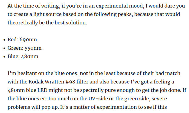

In his article, @koraks wrote:
Has @koraks or anyone else tested a 480-490 nm LED for blue? I measured the curves in his article with a ruler, and found the peak to be at 487 nm, not that it makes any difference. I ask because the gap between the blue and green curves is greatest there, so it seems to me that 480-490 would yield the most saturated yellow.
Also, I sure would like to know the wavelengths of the lasers in the commercial RA-4 printers.

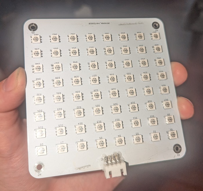

So I'm a little late to this game, but I've spent the last two years designing an LED light for scanning film, which is actually this same problem just in reverse. You need LEDs that emit specific wavelengths, you need a good power output, a linear response and in my case I also needed very high resolution and frequency PWM. One problem I also had that I believe you will run into is that it's very hard to diffuse an array of LEDs composed of different color emitters rather than an array of RGB emitters.
I initially pursued the same approach you tried here, attempting to source commercial LEDs that fit my requirements. However, after running into some serious issues with diffusion, I contacted a Chinese company (http://www.bestsmd.com) that manufactures custom RGB LED emitters, and sourced a few hundred of them for ~$200. There are order size limits that apply to certain wavelengths, but if you're willing to hit their minimum order quantities you can configure an emitter with any wavelengths you want on it. You can even have more than three colors, so that if you need warm ore blue than the other colors for instance, you can add an additional blue emitter. For this use case you'll probably want their high output emitters, which consume about 1W per RGB emitter.
Having done a lot of investigation into how film dyes work in various photographic emulsions (I highly recommend Digital Color Management Encoding Solutions, by Giorgianni and Madden if you interested in how exactly it all works) I don't see any reason you can't make this work with LEDs. The fact that LEDs emit narrow wavelengths is actually an advantage rather than a drawback, the fact that the dyes in RA-4 paper have sensitivity curves that aren't linear was actually a problem to be combatted, and using narrow band light sources makes the process a lot easier. As for light output and efficiency, LED are radically more efficient than anything than anything that would have been used in a traditional enlarger. The reason LEDs need thermal control is not because they are inefficient, but rather because if you heat up an LED it will start to draw more current, which makes it even hotter, and if this process isn't curtailed you encounter a thermal runaway condition that will exceed the maximum operating temperature of the emitter. To get the kind of output you need for an enlarger you'll likely need a beefy heatsink with a couple of fans.
I also noted that you're manufacturing boards at home for your emitters, which implies you have at least some familiarity with PCB design. I would highly recommend checking out JLCPCB.com. They will build you 5 boards for < $40 shipped, and that included aluminum substrate boards which are perfect for LEDs since they act as a heatsink. This is the board I designed for my light with the custom RGB emitters soldered on:

There are a couple of advantages. The first is that you can customize the color output profile to an extent that would be difficult with individual emitters. Like I said before, you can add an additional emitter in a specific color for more output, you can choose exactly the wavelengths you want, you can add a white emitter for focussing, etc. As you noted, RA4 paper needs some extra red relative to the blue and green. Maybe just add another red emitter to your custom chip.
Also, as you noted diffusion is a compromise with power. You can pack a lot more emitters on the board and the individual emitters on each chip are very close together so you can get away with a lot less diffusion and realize more light output.
Finally, and in some ways more importantly the big problem is heat distribution. I note you have already encountered this problem, and designed that op-amp heat sensor setup. I had similar problems, I had a series parallel layout, and some strings would heat up more than others. You can get discrete components that are designed to balance out the current in parallel LED strings, but I wanted to keep my design as simple as possible, and the RGB emitters pretty much entirely eliminated the heat distribution problems. The density of the emitters means that one strand is a lot less likely to get hotter than the other strands, and as long as the heat on the board is distributed _evenly_ you can rely on dumb cooling.

@koraks : I re-read your article, and this statement stood out:
Experimentally I found that royal blue LEDs with a peak emission closer to 450nm work better than regular blue ones with a peak around 460-465nm, and also better than shorter-wavelength LEDs.​
We can phrase that mathematically as follows, where 'quality' is a function yielding visual quality (mostly hue purity).
quality(shortWaveLength) < quality(450)​
quality(465) < quality(450)​
These imply that royal blue (450) is optimal, or close thereto, because moving either direction away from 450 reduces quality. This reasoning assumes the quality function has only one peak, and not another around 485. Furthermore, you have made many prints using 450, and they look fine.
My question is: Is the second inequality (quality(465) < quality(450)) an error?
As wavelength increases, the B-G difference between the curves increases, which should improve purity, especially of yellow. Should the quality of 465 (regular blue) be re-checked?

Further reading of @koraks article might have answered my question above. He states that Kodak uses a Wratten #98 for blue, and he shows its graph, which has a minimum at 425 nm. We must remember that tungsten's spectrum is roughly an angled line through blue, so those two spectral curves should be multiplied together (actually added because they are logarithms). Then a weighted centroid of the resultant curve must be computed, and I believe that both computations will shift the minimum rightward, making it land near 450 nm, which is the royal blue that @koraks recommends.
But why would 450 nm give better results than longer wavelengths in which the blue-green spread is larger? I'll guess the answer is in the thresholds of green and blue. In black and white paper, the green emulsion has low sensitivity and some threshold; blue has high sensitivity and a different threshold (i.e., it needs a different amount of light than green to produce a tone). In color paper, I suspect that the emulsion-thresholds were chosen to make 450 nm work well.
I was thinking of buying some regular blue LEDs, but Kodak's use of Wratten #98 made me think of the multiplication/threshold/centroid ideas, and made me decide that royal blue (450 nm) is probably best after all.

Quite recently, I followed up on this with the (for now) most recent version of my system: https://tinker.koraks.nl/photograph...gly-rgb-led-head-for-color-printing-revision/
This version is a lot more compact (and a little less powerful) than the previous version I used. The concept is still very much the same and since I first posted about this, I've made many hundreds of perfectly fine prints from negatives ranging from 35mm up to 4x5" with this setup, both in color and B&W.
