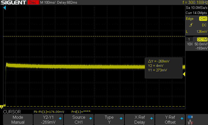

256 Hz, and 50% is showing a slow rise/fall.
To be brutally honest, if that's an accurate measurement of light intensity, this is an exceptionally poor PWM performance. I'd be seriously concerned about this.
fuzz around the line -- that's 100 kHz ripple that I'd like to remove.
Do you mean the small-amplitude 'heavy' fuzz (2.5mV amplitude if I read correctly), or the much lighter fuzz that's apparently not there most/some of the time and only sporadically at some points of the period (the 15-20mV amplitude fuzz)? The latter looks like an oscillation; I'd be tempted to scope out the actual current through the LEDs to see if it's there, or if you're picking up a spurious effect in your phototransistor detector circuit.
I think the phototransistor is useful for determining thermal degradation effects, but perhaps less so for measuring PWM performance. To that end, I'd directly measure LED current instead.

I fixed a mistake: The power-supply for the phototransistor circuit had some noise, and adding a cap eliminated that.
Second, my cheap scope has much A2D noise at 5 mv/div, and that's the uniform band around all lines. The taller spikes are ripple from the Mean Well driver.

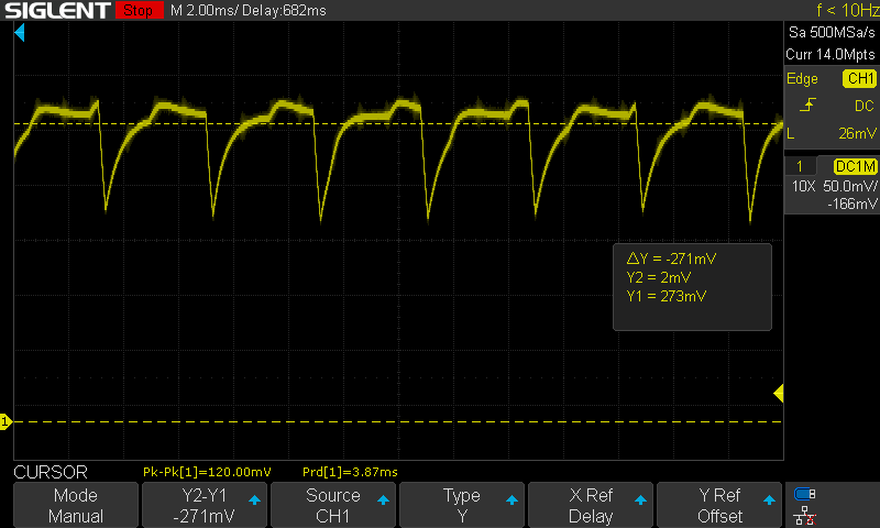

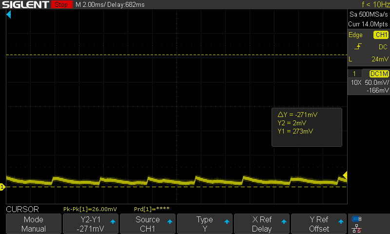

But here's an interesting discovery that is probably the cause of the bad PWM performance koraks observed: The Mean Well driver performs some RC smoothing of the PWM input, which the datasheet didn't mention. In fact, the datasheet has a graph showing the output PWM is identical to the input. Here's a trace of 1/16th duty-cycle at 256 Hz:
At 1/64th duty-cycle, the output is a nearly flat line.

I think you're mixing up two things here, but correct me if I'm wrong.
One concern is high-intensity, short duration reciprocity failure. The kind of effect you might run into when using flash photography with a very short thyristor-truncated flash pulse of let's say 1/10,000 second. While film generally doesn't suffer from this down to about 1/1000 second (1 millisecond), I don't know about paper. My experience so far suggests it's not much of a concern, however. To the best of my knowledge, no test results have ever been released to the general public reporting about rapidly repeated short pulsed exposure like we have in PWM!
The other concern is how your PWM circuitry handles very short duty cycles. In the example you've shown, you encounter the problem that very short pulses actually don't make it to the LEDs at all! That has nothing to do with reciprocity effects, but it's just a fundamental shortcoming of the Meanwell LED driver you're using. It implies that if you somehow end up using very short duty cycles with that setup, you won't expose the paper at all, or only much less so than you anticipated. This is the issue I brought to the fore in my previous post and that would concern me.
Mind you, at some point you pretty much always run into very short duty cycles blending to a flat line. However, I had this happen at something like 0.5% duty cycles at 10kHz (beyond this everything seemed linear enough), not at 1.5% duty cycles at 256Hz. The latter might actually become problematic for split grade printing where you try to mix in relatively small amounts of blue with green to create the lower grades around 1 or so. You could solve this to an extent by using a non-linear relationship between grade and blue channel PWM duty cycle, but if the effect is bad enough, you'll effectively lose a part of the contrast range between grade 00 and grade 1.5 or so.

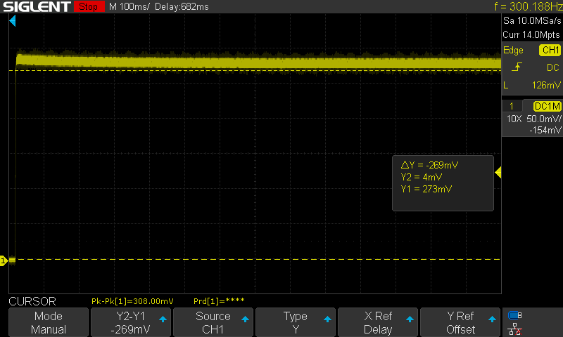

I improved the phototransistor circuit, eliminating almost all noise, which let me make two discoveries of interest to anyone building a LED lamp.
Since you have set up the measurement (kudos!) could you report what happens also on longer timescales, say from 1 to 100 seconds.
From a prior posting, the longer times show a drop of red intensity of 0.01 stops.
However, the improved circuit yielded the following start-up trace for green over the first 1.4 seconds:
We see that green at full power declines for about 0.4 seconds after turn-on. I estimate the loss at 0.04 or 0.05 stops. Red is similar. Blue shows no loss at all. Based on the thermal curve for green in the datasheet, I estimate that the junction's temperature rose about 20 degrees C. You might notice a hint more density in a print if your exposure is under one second.
For the record, here is red:

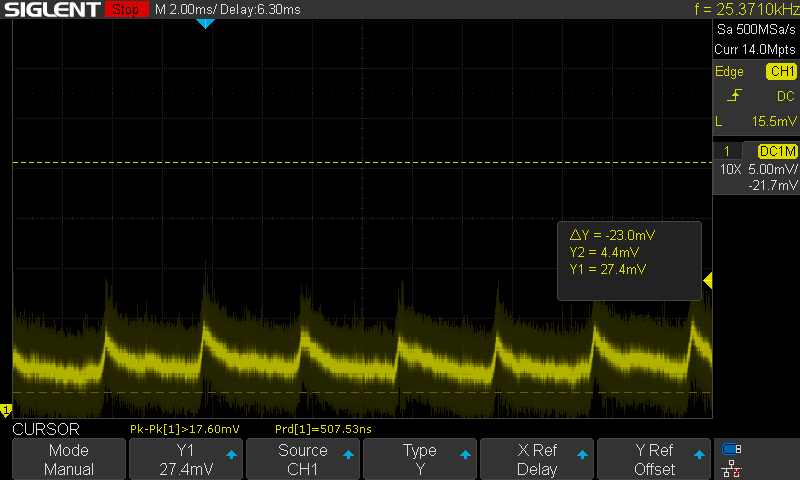

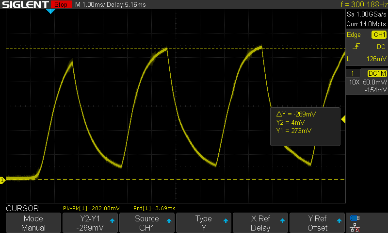

The second discovery is that the Mean Well controller partially averages the PWM signal. At very low duty cycles, the output signal is close to its DC equivalent:
The dashed yellow line at the bottom is for no light. Koraks, the low signal is not being snapped to zero. Rather, it is low-pass filtered, so that the power being output is the same. My reciprocity remark was based on my suspicion that paper might respond differently to pulsed light than to nearly continuous light as graphed above. Manufacturers surely tested with tungsten, but pulsed? We don't know, as you pointed out. Here's a very high duty-cycle that's only 0.1 stop below max:
I talked with an EE at work today about this; he had an idea that makes me wonder if this smoothing was done to reduce EMI (Electro-Magnetic Interference). EMI is an important problem in electronics, and Mean Well would be motivated to reduce it by low-pass filtering their output. I just wish they had described feature this in their datasheet.
Here's the trace for 50% duty cycle:
The absence of sudden transitions (vertical lines) means this will emit low EMI.

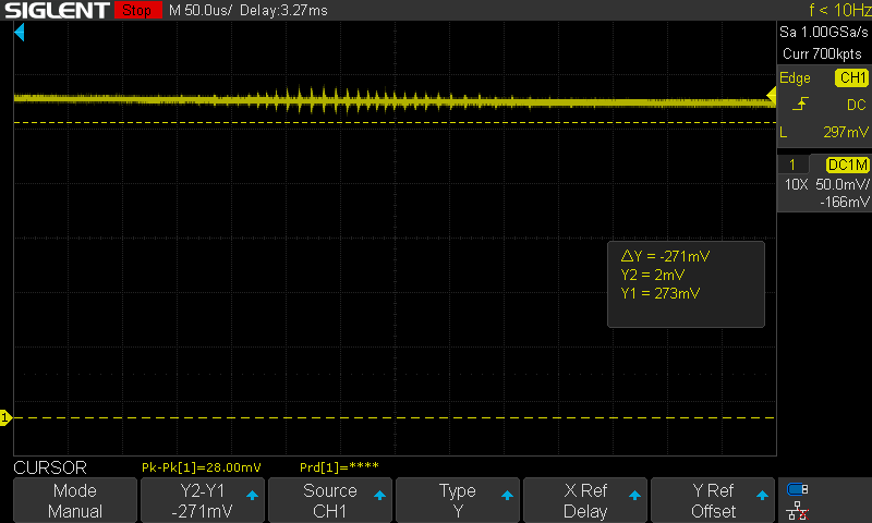

I still see some overshoots or ringing periodically at 100 kHz:
Any idea what is causing this? I'm hoping a small capacitor across the Mean Well output-pins will smooth it out of existence.
As I said before, to determine the actual behavior of the meanwell supply, scope the actual LED current instead of the phototransistor output. The latter can be subject to all kinds of effects through which rapid transients change shape.
That's very well possible and I agree with your colleague it could be there to suppress EMI. Easy enough to figure out; just open up the box and poke around!
On the Mean Well driver, Out- is not connected to ground, which would force me to scope Out+ and Out- on two scope channels, and mentally subtract the two traces. It makes me wish I had a differential probe. But you're right; it wouldn't hurt to do it anyway to see what's there.
You could just include a series pass resistor of let's say 0.1R and probe across that, no? Or is there a limitation in your scope that prevents this?

Ahhh, I see. Yeah, that makes it difficult to look into the package. You could try and directly measure capacitance across the output pins; if it's higher than let's say 10nF I'd expect an actual cap to be there. Otherwise you should only measure parasitic capacitances which should be in the pF to single-digit nF range.

A simple series resistor is perfectly adequate for scoping current transients and has unlimited bandwidth. A scope, even a cheap one, has far better signal conditioning than 50 cent sot23 device.

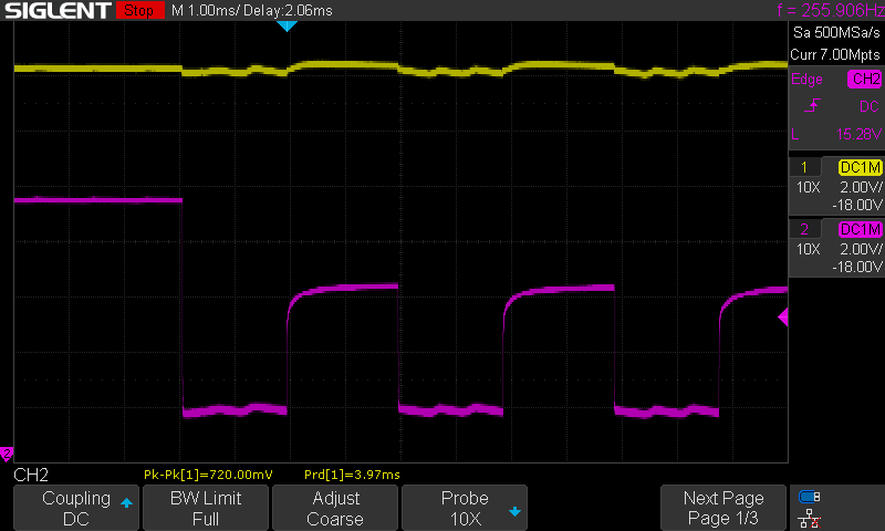

Per Koraks' suggestion, here are the oscilloscope traces of the + and - inputs to the LED-chain at 50% duty-cycle:
I'll guess that LED+ is connected to the sense-resistor on the high side, and that LED- is the drain of the MOSFET. Even when off, there is some voltage between the outputs, as seen on the left end of the scope trace. My multimeter measured 4.something volts, which declined to 1.8V in a few seconds, so I suspect that is residual charge in an EMI-suppression capacitor. We see the rounded corners in the lower trace, which I suppose are exaggerated by the LED's nonlinear V-to-I function. Any comments on these traces? Do they make you want to buy Mean Well LED-drivers? 🙂
