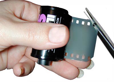

Just a FYI, I went to JoboUSA website it tells you to remove the film from the taped end, take fingernail clippers and nip 3mm off the corners, load film.

I always snip. Plus I aggressively reverse straighten (or kink) the same end of the film prior to reeling. Some films can get stubborn due to humidity or aging issues, but this always seems to work for me with the Jobo reel.
I never snipped in my whole life. :D
I bend the corners the other way, but only for Kodak films, which have more problems to load...
Snip is the only way !!
Ok I know it's 35mm but the same applies to 120 and I do it in the darkbox. If having problems with the snip then just swap ends and fold the tape as Sirius Glass suggested.
I have a snipper in house that cuts round corners and use it on paper and thin cardboard for esthetic reasons or in cases where definitely no angular corner of any kind may be. Though with film I did not foresee any benefit over a 45° straight cut and thus never tried it.
As Jobo mentions in their instructions , (which I can find on JoboUSA site, thanks CatLABS ), don't over snip. If you do it makes matters worse for 120. Even my old standby Paterson reels I've always been careful to not leave a open sprocket hole when I trimmed the film.

I've tried, and the taped end, even without tape has much less of a curl. I have been snipping with Kadomaru trimmer, on the taped end, leaving the tape on the film and I've never had it easier.
Make sure you use the smallest setting on this little machine, the larger radius settings make matters worse.

TWO TAKEAWAYS FOR ME. START WITH TAPED END, SNIP THE CORNERS ROUND.
...The other thing may be my wierd method of always starting with the un-taped end. This maybe the root cause. Correct me if I'm wrong, but the un-taped end is closer to the spool and probably has more of a set, (curvature) of the film....
The taped end will be towards the outer spiral of unexposed roll but towards the inner spiral after exposure. So if you assume it sat unexposed for a longer time than exposed, the taped end should have less of a curve.
