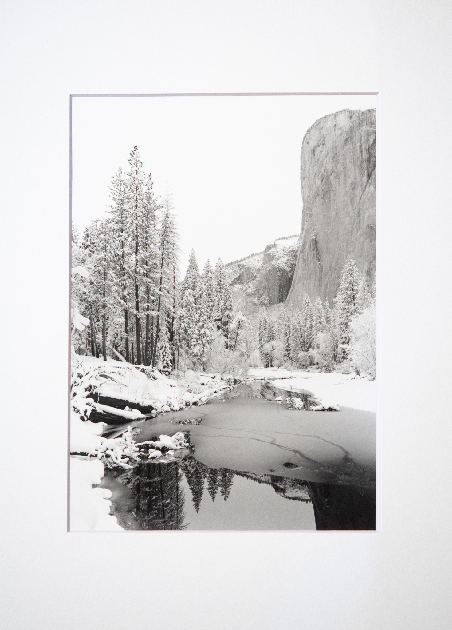

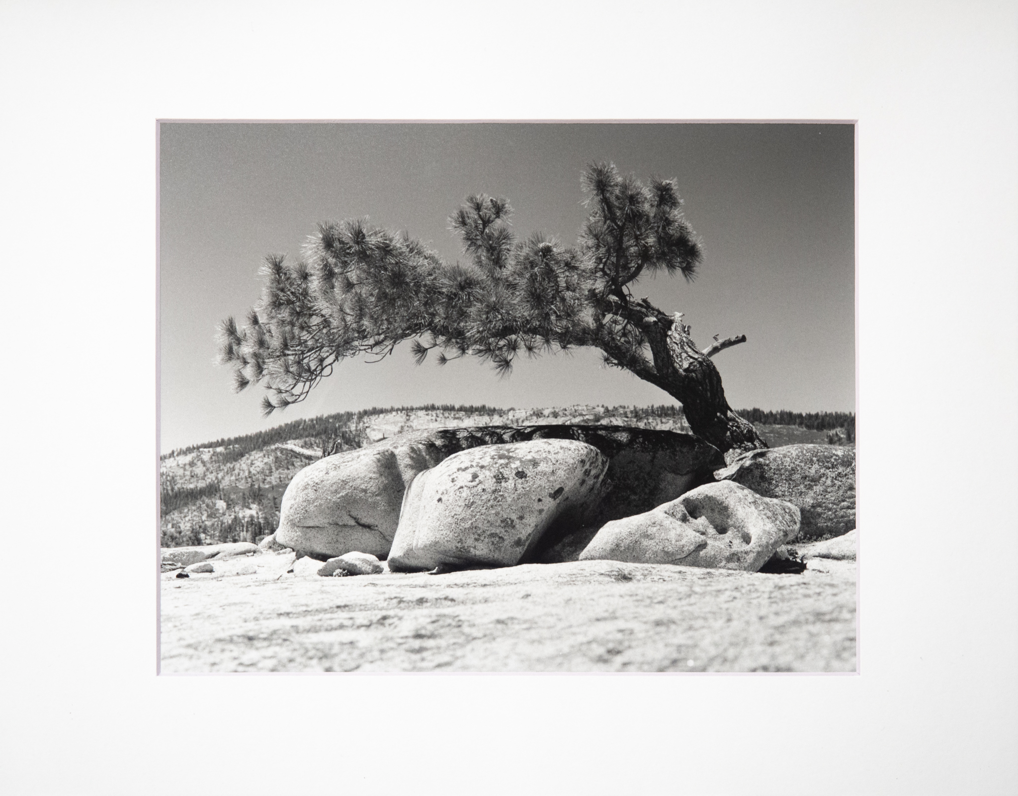

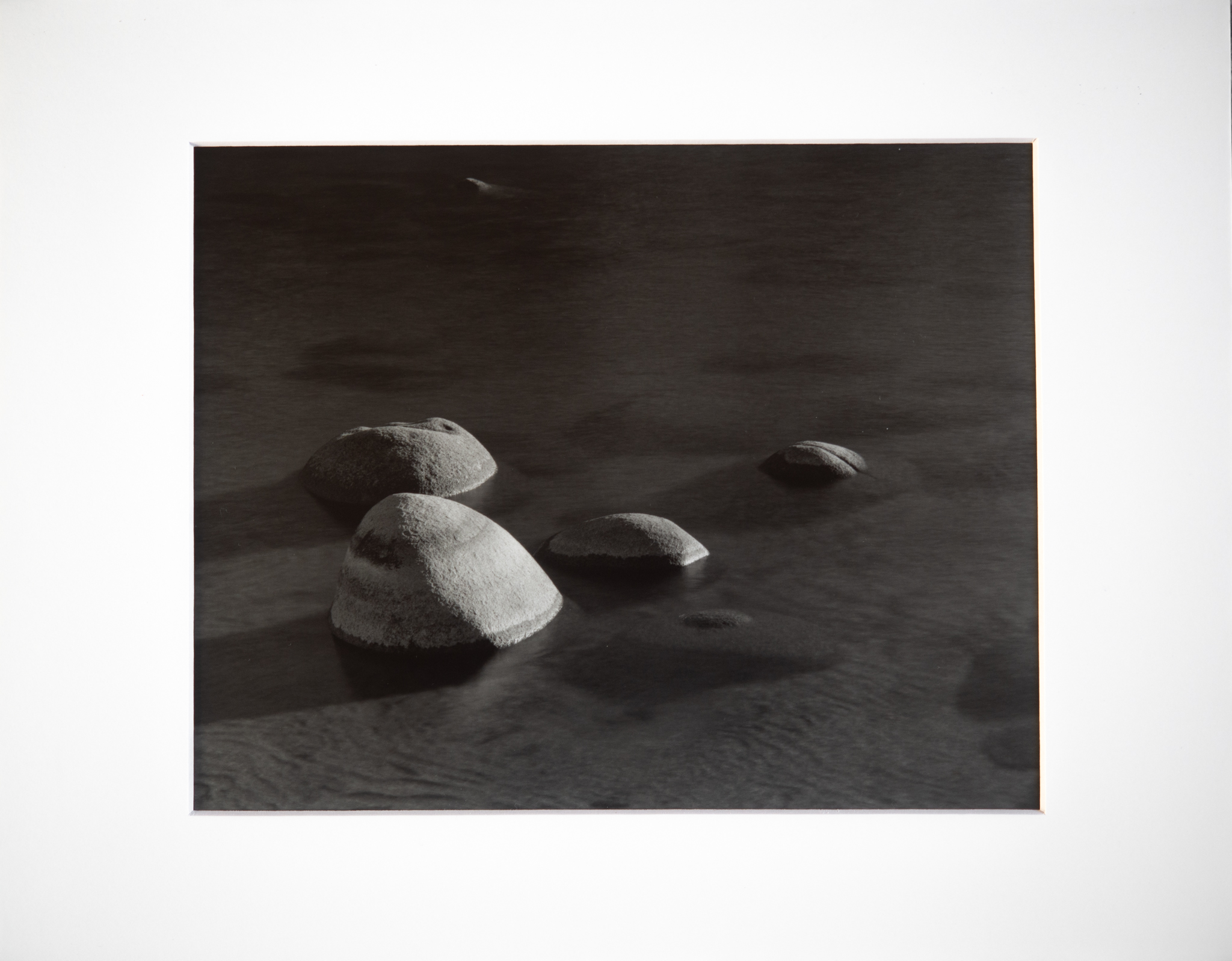

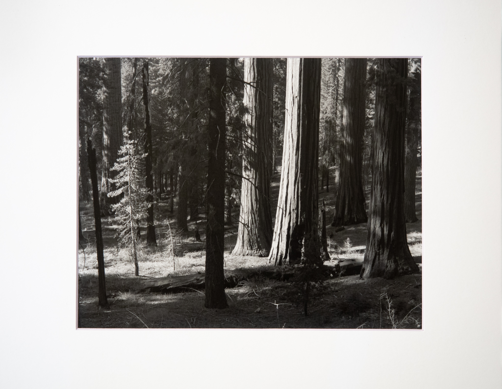

I thought I'd share my results with this new Ilford paper + Eco-Pro chemicals. I made a handful of 8x10 prints on the pearl paper. I used Eco-Pro's Paper Developer (1:9 mix) and developed the prints for 90 seconds, same time I give the MG IV paper. I also use their stop, and fixer. It does take longer for an image to start appearing but, overall time seems the same.
I've not done darkroom printing long enough to give you any inteligent insight into my results but, I like the results and will switch to using this once I run out of MG IV paper and I can get it in 11x14.
I photographed the matted prints, so some of the quality/detail is lost. I tried scanning the prints and couldn't get good results (I've never really scanned photos before, so it was probably user error).
View attachment 236540 View attachment 236541 View attachment 236542 View attachment 236544
Those prints look very nice! The new V is a great paper, as you said, it behaves quite differently to IV but I love it. I haven't really liked an RC paper since the last RC paper that Agfa made
