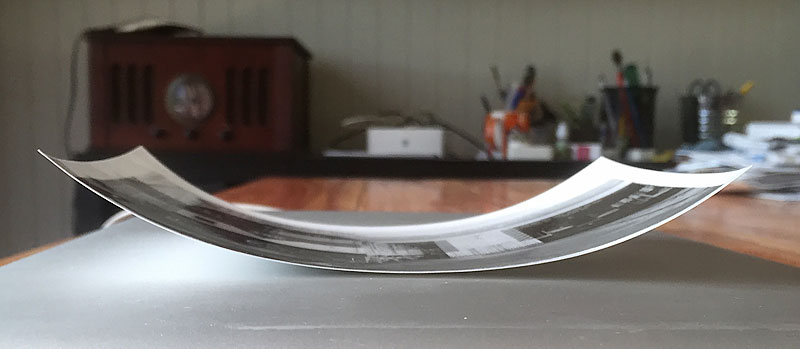

Printed some MG V 5x7's last night. Prints had a total wet time of approx 1 hour, were squeegeed and then air-dried on a towel. I never thought I'd have problems getting RC paper flat. On a positive note, it is a superb paper reaching a DMAX of 2.35 in Dektol.
One hour is really long for a wet time for RC.
One hour wet time with any other RC paper has never been an issue. Even out of the box, dry, this paper curls.
Harman is quite clear on this: Prolonged immersion in water can cause edge penetration and print curl with resin coated papers; for this reason, avoid wet times longer than 15 minutes.

I'm not washing them for one hour, I print, accumulate prints in an archival washer, which is turned on for about 5 mins in an hour, after I have about 6 prints I fish them out, squeegee them and lay them on a towel or print rack. I'm printing tomorrow, I will measure the RH and make sure they have no more than a 10 minute wet time and report back. Actually, I'll make sure I do one with a wet time of one hour and the others for no more than 10 minutes.
Same here, I posted about previously. I contacted Harman and they inspected the issue right away on their own papers and didn't notice anything. Provided them picture & video of curling on two different batches of paper. Curling on a paper that I opened from fresh batch. Got no answer. Replied again, they promised to answer again on "thursday". No response on thursday. I asked again. No response. Waiting for the "thursday".

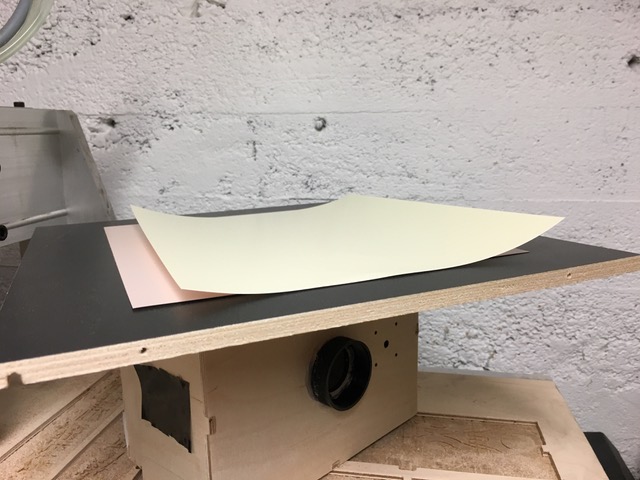

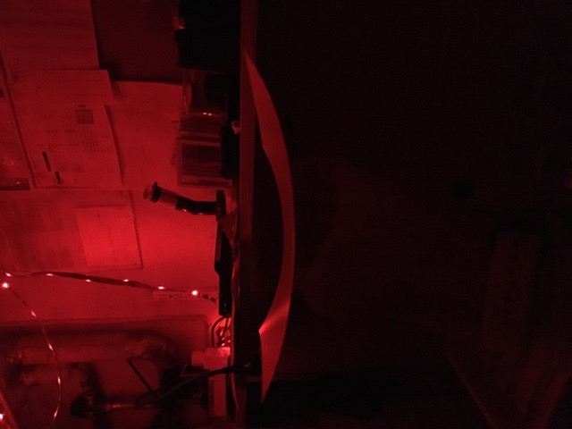

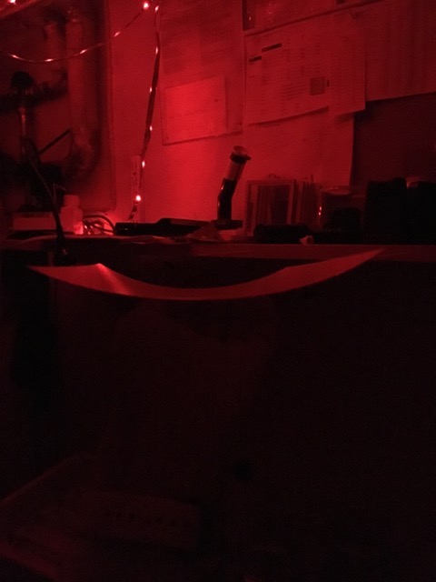

There is certainly some kind of problem with the curling.
Edit: these papers have not been developed and have not seen any kind of water at all. The darkroom photo is taken just after removing paper from a fresh box. I'm holding with my fingers from the center of the paper from so small area as I could.
