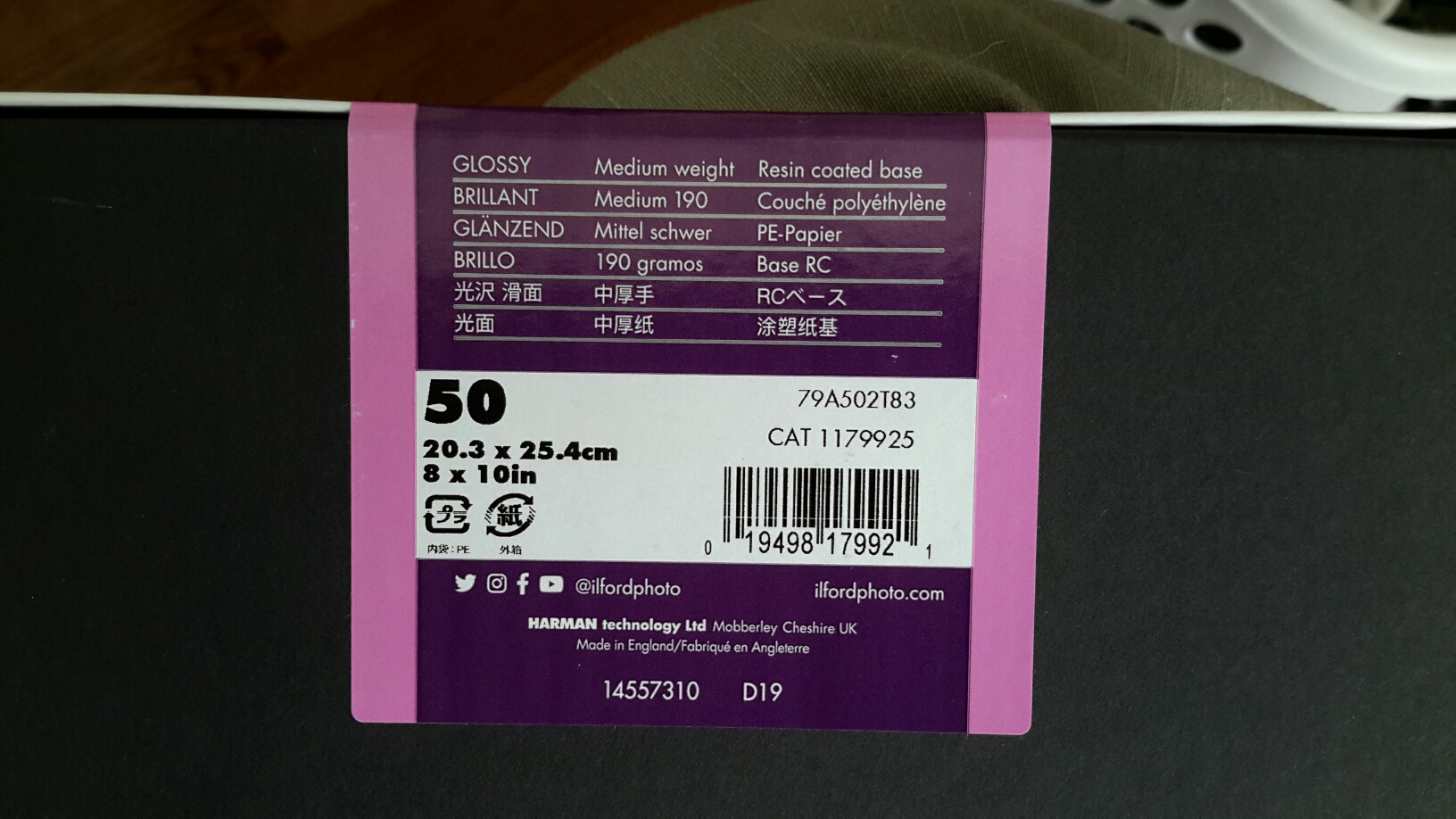

Yes - but the labels on the current and earlier versions of the paper put all the interesting stuff on the parts of the label that wrap over the end on to the back.
Things like "MG4RC44M"
No numbers or letters
