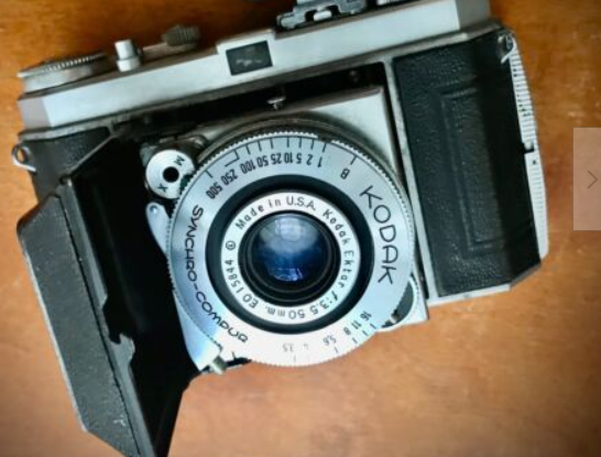

My all time favorite of the minimalist 35mm camera is the Retina I (type 010) with Ektar 50/3.5 lens.
The "true" Ektar f3.5 lens made by Kodak (Rochester) is the one shown in blee's post, with the CAMEROSITY serial number, which in the case of the Type 010 Retinas is always going to start with either EO (1946) or ES (1947). This is a Tessar (four element) design and exceptionally well executed. This was absolutely state of the art lens technology in 1946/47 and is still remarkably good for modern usage. This lens performs well from wide open to closed down. If you find yourself in a position to acquire one of the Type 010 Retinas with a USA made Ektar lens, don't hesitate to acquire it.

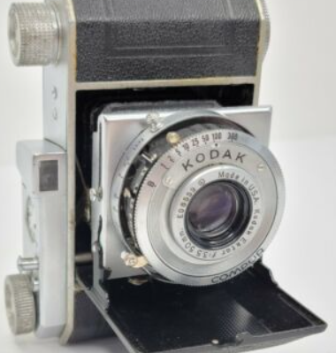

From your comments, I think the top picture is the re-badged and the lower picture is the true Ektar (although on a Retina 1). Is this how to tell the difference? Thanks.

Both of those are genuine Ektars, as evidenced by the EO or ES serial numbers. Only true Kodak Ektars use this serial code
And the "Made in U.S.A." engraving makes it even more obvious. 😉
