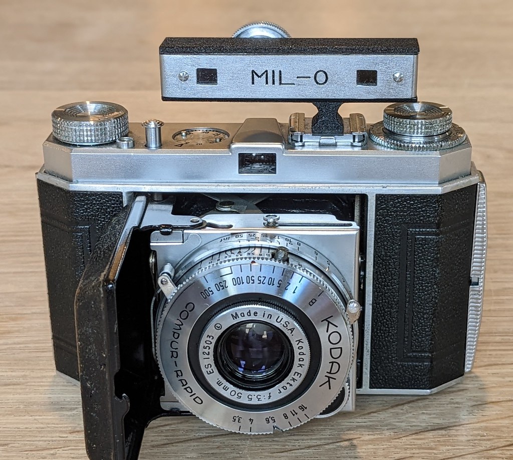

My all time favorite of the minimalist 35mm camera is the Retina I (type 010) with Ektar 50/3.5 lens. I like it more than the Rollei 35TE. The Retina is more precision built, and in my humble opinion, has better lens. The rangefinder is quite optional, since you probably already know how to guesstimate distance.
Kodak Retina I (Type 010) with Ektar 50/3.5 lens by Zheng, on Flickr

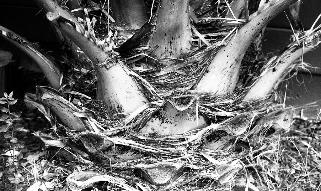

A sample photo showing the sharpness and resolution of the lens (nothing artistic, and handheld). And it was from a 2400 DPI quick scan from an Epson V700 flatbed. I'm sure it could yield even better results with a Nikon Coolscan or drum scan:
Palm tree trunk details - Retina_Ektar_Arista100_033 by Zheng, on Flickr
