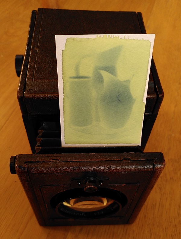

Quick ( 3+ hours 😀) cyanonegative top prove to myself that it works - well sort of so far.
Will load a 120 film at the weekend.

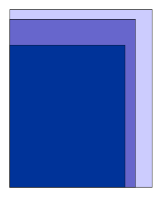

Also now realise it should properly be called a 4x5" rather than 'Quarter Plate'. Goodness knows how they ever arrived at all those plate and film sizes . . .
Ian Grant
Aug 2, 2004
23,419
West Midland
It's definitely Quarter plate, the differences in sizes between 5x4, 9x12, and Quarter plate are quite subtle. 9x12 is roughly the same length as 5x4 give a couple of mm, the Quarter plate is near the same width as 9x12 but shorter.

Whole Plate - 6.5" x 8.5" - is a really nice size.
It (and the related Half Plate and Quarter Plate) originated in an environment that was relatively independent from the environment where 8x10, 5x7 and 4x5 originated from.
Add the extra complication of metric sizes, and you realize that trying to move from paradigm to paradigm is always going to create potential confusion.
Ian Grant
Aug 2, 2004
23,419
West Midland
Matt, Whole or Full plate was still the common size used to glaze windows in Victorian times.
Wendy, this is the relative sizes of 5x4 film actually 127mm x 102mm, next is the Continental European 9x12, and finally Quarter plate.

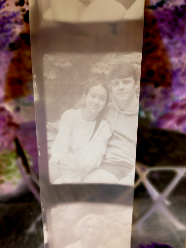

Progress report.
Camera captures lovely images. A bit 'theatrical' to use so all my subjects have big smiles!
Right now I'm using 120 film in a Graflex '51' Film roll holder and contact printing using cyanotype. Decidedly NOT a digital process so have not scanned any results. I've already given most of the prints away to my very patient sitters!

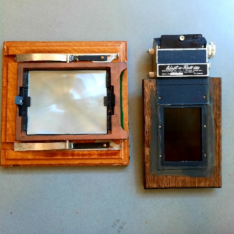

Have you tried taking the lenses out and using a hair dryer to heat up the barrel enough to free up the aperture blades?
Try some xray film and cut down to half plate size. Xray film is great for cyanotypes.
I made my own back to fit a 6x9 roll holder, was going to convert to 6x12, but decided best to just use and make a dedicated 6x12 camera.
Thank you for the encouragement - those look very effective. Can see you used an adapt-a-roll - I'll start watching for something similar.
Here in the UK we can still (sometimes) buy quarter plate sheet film, I'm just not quite ready to develop it yet.

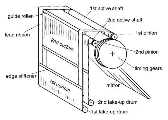

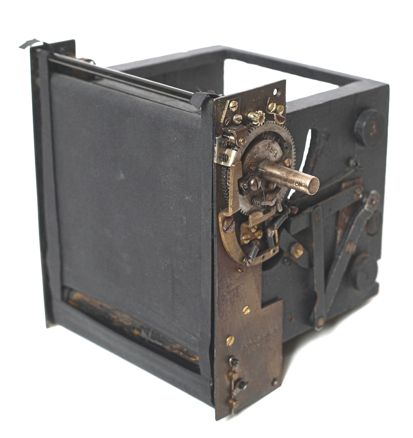

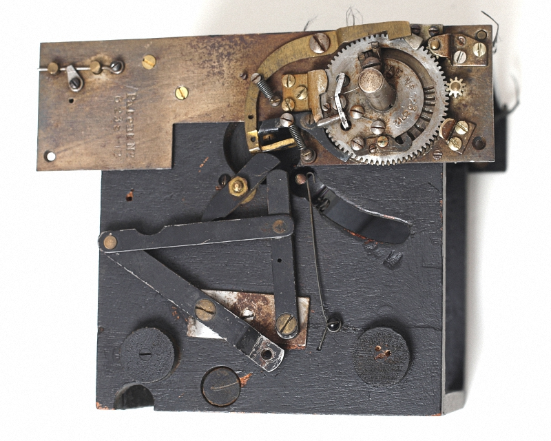

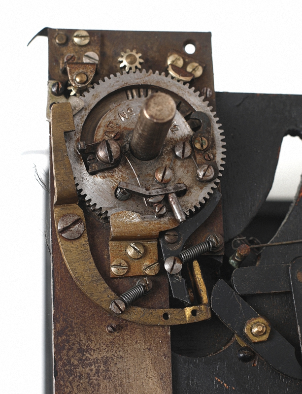

For reference:
Shutter detail of my g=first Ruby Reflex.
Mirror box & shutter.
There is a spring not sitting correctly, without a functioning shutter it was difficult to resolve. In this image the shutter is un-cocked, the two curtains should overlap by approx 1/4 of an inch as it's a self capping shutter. So I need to adjust the 2nd curtain.
I sent these via PM 3 days ago, but they may be useful to others.
The shutters stamped Patent no 6283-12 are essentially mechanically the same, the take-up drums are simpler than in the Patent drawing. The main differences are in the mirror fitting.
Ian

Right now mine is being used with a Lomograflok back for instant colour pictures. Hugely entertaining for everyone.
Once I have another camera for the Lomograflok I'll switch 'Ruby' back to film work.
Instagram link for Ruby in action with the Lomograflok back
