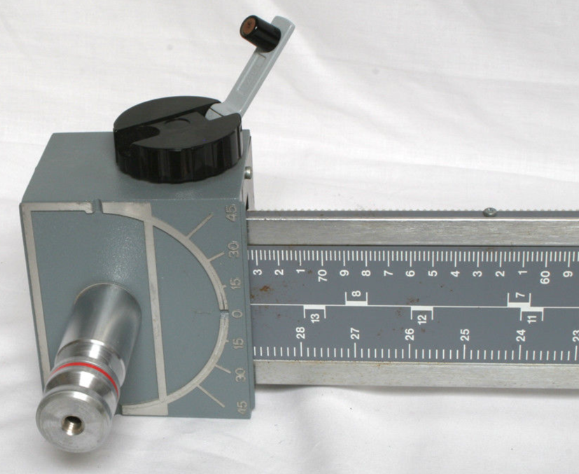

If you need a picture I could put mine back into copy stand mode. The M601 head slides onto a post that is fixed to the carriage. The M301 head is attached to the carriage with a 1/4-20 knob. I'm busy today but should be able to do tomorrow.

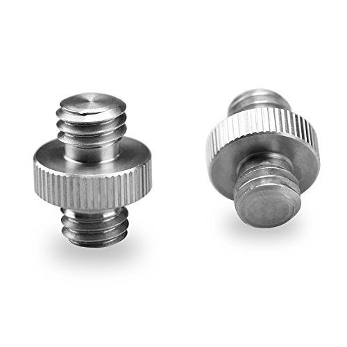

I just found a M601 on eBay and want to use the column with my Nikon PB-6 bellows. Will this stud work?
SmallRig Double Head Stud Adapter 3/8" Male to 3/8" Male Thread Screw
https://www.amazon.com/SmallRig-Double-Head-Stud-Adapter/dp/B006OTI2D8

Thanks. I found a photo or the bare M601 post so it is clear how to use it.

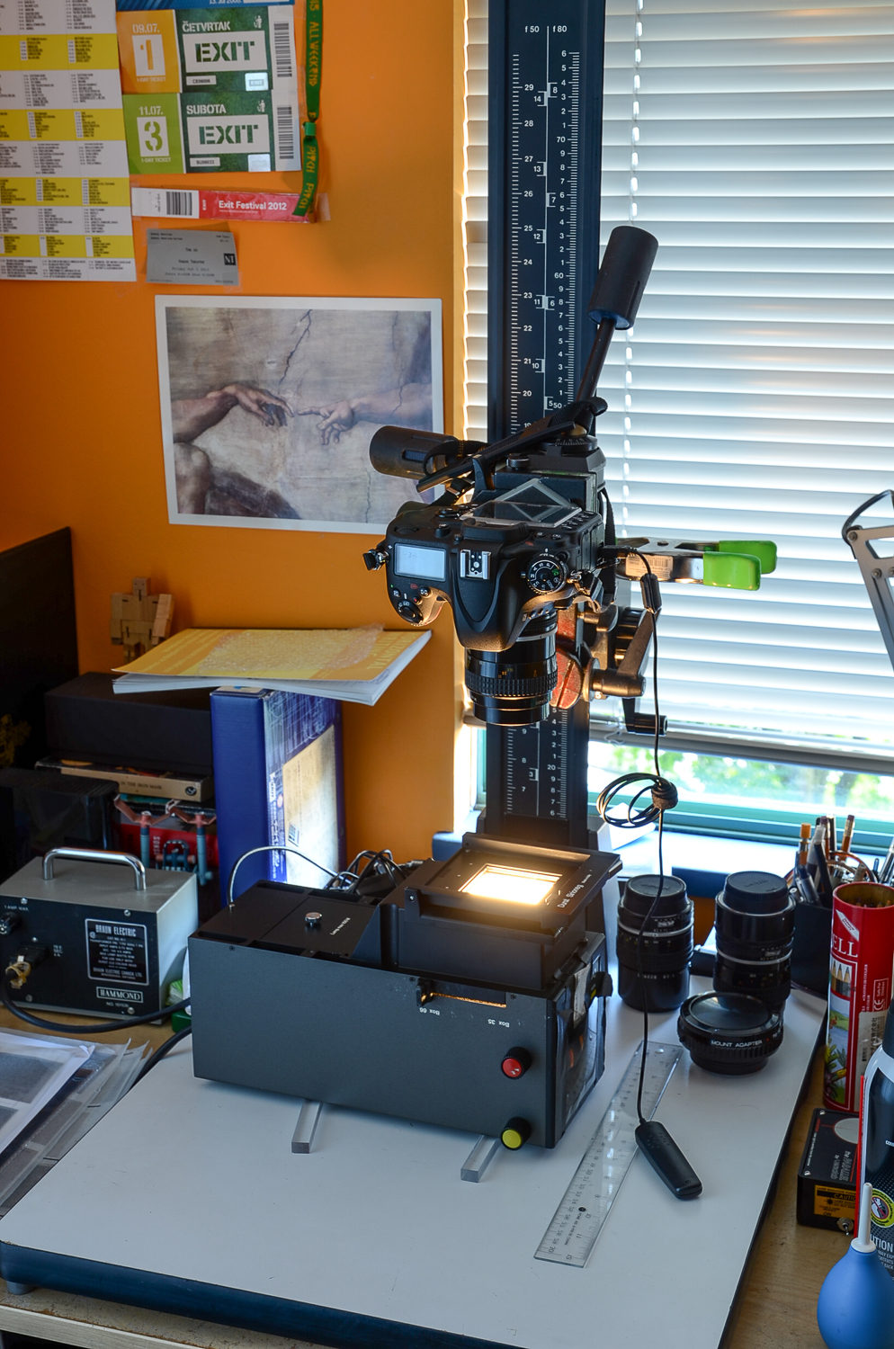

From my personal experience I found that using vertical set up (as enlarger column) for DSLR scanning is extremely painful for extended scanning sessions. I was looking down thru viewfinder to precisely position negative in negative carrier on the reversed enlarger head. Pain in my neck was unbearable after 30-45min. YMMV but I had to move to horizontal set up and difference in comfort is simply amazing. I can work for entire day with out any discomfort. If you are using Live view on your DSLR and connect camera to the monitor is maybe easier to position negatives but then you can not connect camera to Lightroom for tethered shooting. Now I'm using vertical set up only to copy entire pages of negative sleeves as kind of "digital contact sheet" but in that case I do not have to look thru DSLR viewfinder after first test run.
Here is column and colour head from my Durst M605 in action
Good luck!

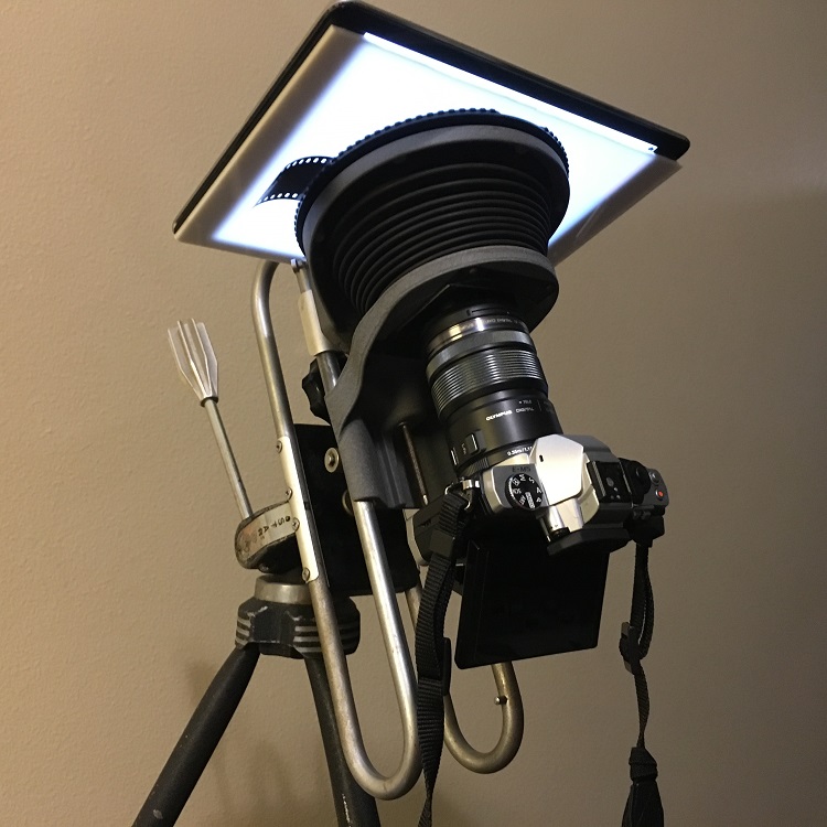

Thanks for the photo. I plan to use my stand with a bellows mounted camera to do some focus stacks. I am using a mirrorless camera with a flip up screen so that should help.

I am using a Fujifilm X-T2 with an adapter to a Nikon PB6 bellows with an EL-Nikkor 50mm F/2.8 enlarger lens or a 60mm Micro Nikkor. So those will not work. Years ago, when I had a Nikon camera the ControlMyNikon was pretty cool.
However, Fujifim cameras have a WiFi app that allows full control of the camera from my iPad or iPhone. So that works very well. The iPad gives you a nice size image to work with and no neck pains ;-)

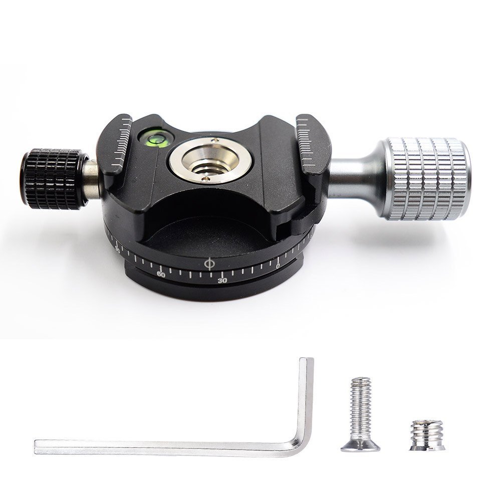

Lysander
Mar 6, 2018
11
Florida
Digital

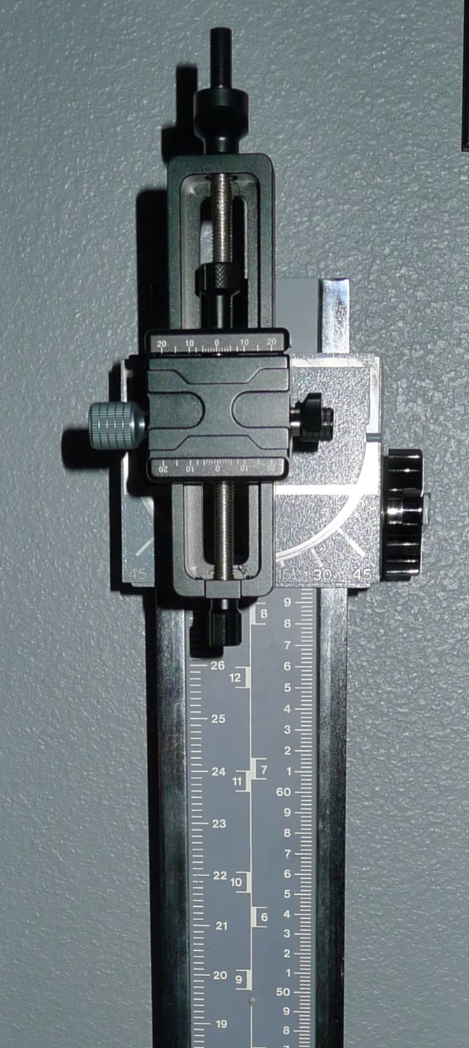

This is my final setup using a Sunwayfoto slider for stacking:

Cholentpot
Oct 26, 2015
6,922
I did this with a cheap enlarger.
Took off the enlarger head and got a cheap ball head. Camera is mounted to the ball head.
Lysander
Mar 6, 2018
11
Florida
Digital
The problem with a cheap ball head is it tends to drift when using a heavy camera rig. Using a macro rail seems more stable.
