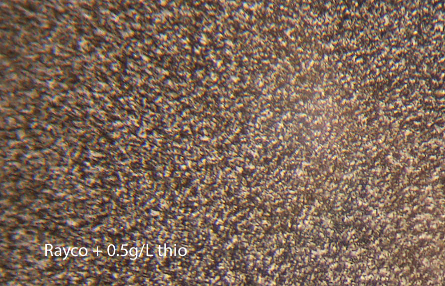

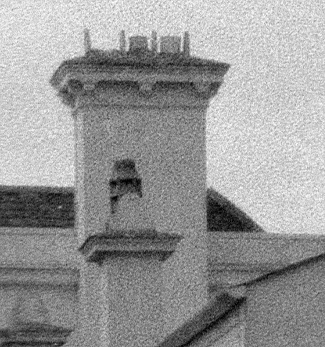

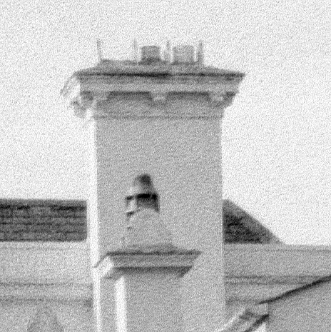

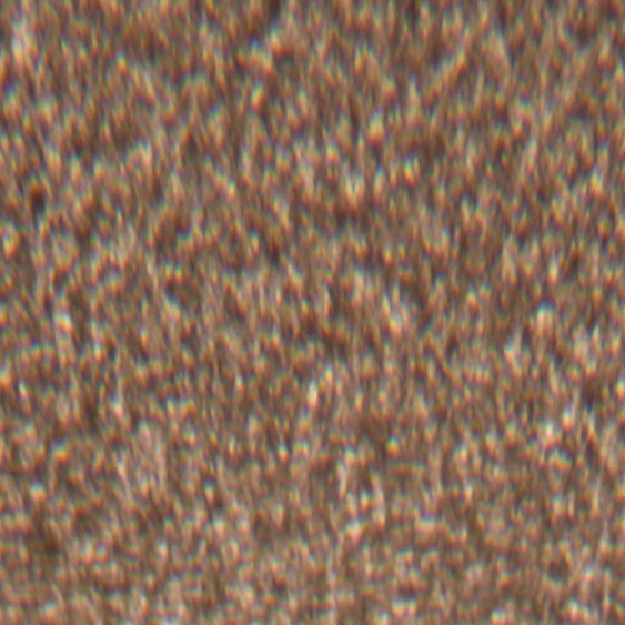

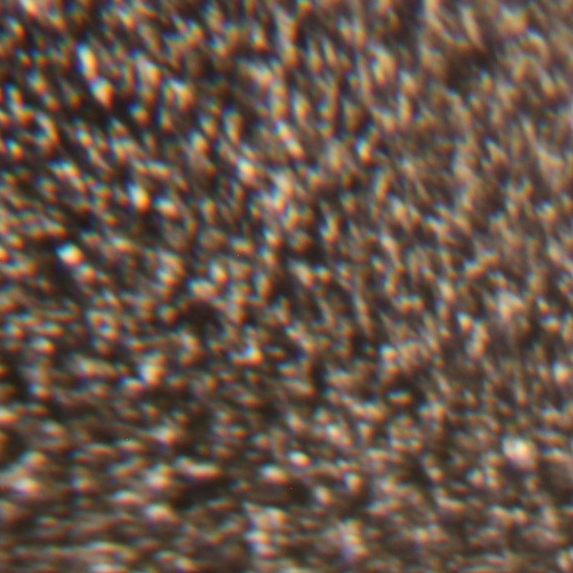

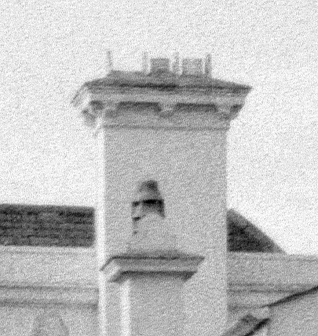

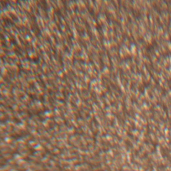

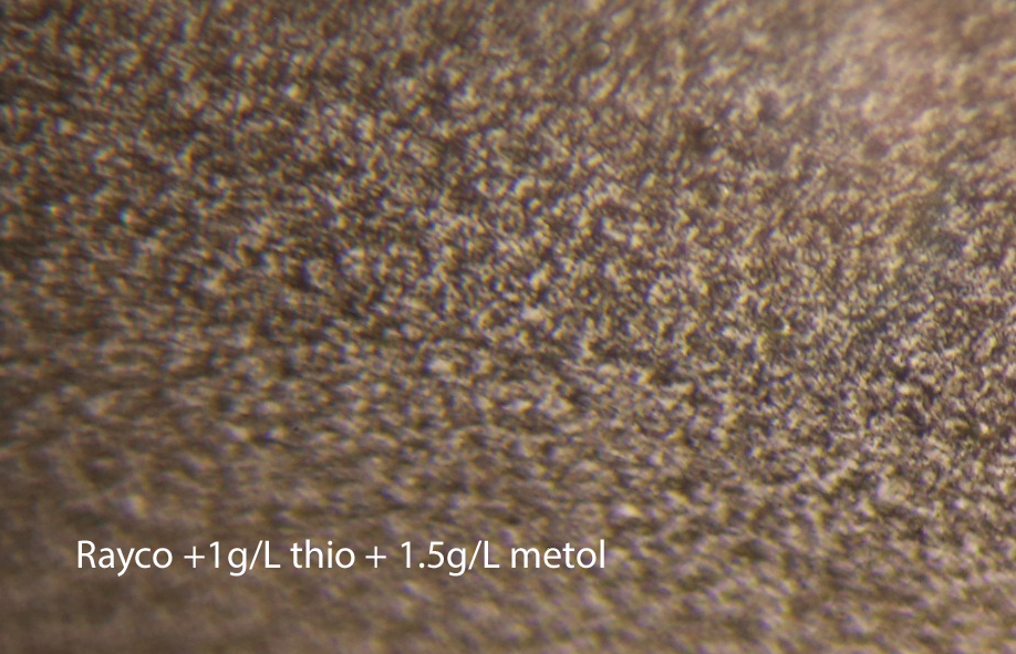

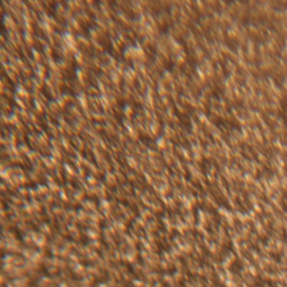

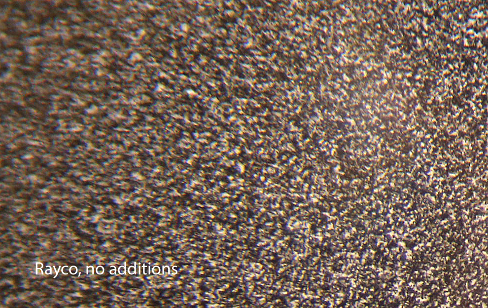

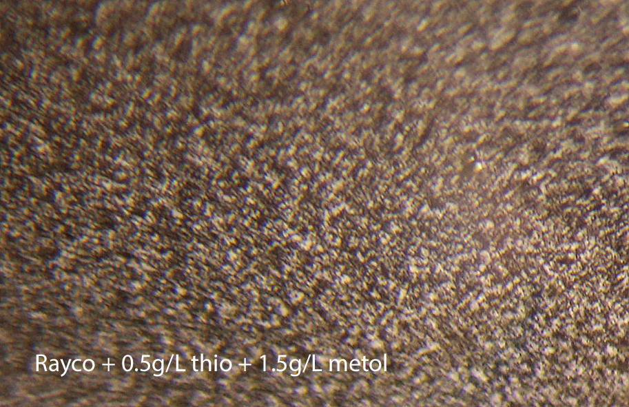

Since it appears that lack of solvency in Rayco UFG is the reason it does not provide finer grain I have done some preliminary work on adding a grain solvent.
Chlorides are/were used in some developers as solvents but I believe Kodak were working on thiocyanate when the labs closed and Spur have recently been using this substance as a solvent.
I added 0.5g/L ammonium thiocyanate to the Rayco developer, this produced a reduction in grain (figs 1,2).However there was a speed loss of about 1/3 stop.
To get round this I tried the method used by Crawley in FX-4, addition of metol . This in addition to the addition of ammonium thiocyanate.
This seems to work, the grain is still finer than Rayco alone (figs 1,3) and the speed seems to be restored .This formula I hope to test further ,call it Rayco-2.
Addition of yet more ammonium thiocyanate is counterproductive (fig 4) no detectable further improvement in grain and a speed loss of 2/3 stop.

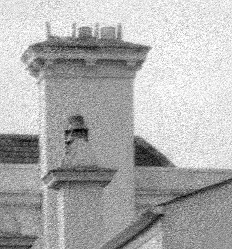

These two pics are 3600 dpi true scans of TMY negatives of the same scene developed in Pyrocat HD and in Rayco II
Hard to see much difference on a computer screen but on 15 in wide prints Pyrocat HD shows greater acutance , and Rayco II shows very slightly finer grain.
Both give about the same EI.
This CD-4 based developer is not really competitive with Pyrocat IMO.
