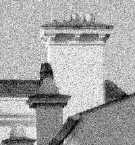

Sease No.1 with CD-4
CD-4..............................10g
Sodium Sulfite..................90g
Water to..........................1L
pH~7
Develop 100 T-max ~25m 68F
I did try this but it loses about 2/3 stop cf Xtol 1+0 and the grain is not as fine.
The crops are 2.5mm square sections of negative, sharpened identically.
Back to the drawing board.

This is an exceptionally low pH for using CD-4 or indeed any of the CD series. You should get better results than what I see here.
PE
