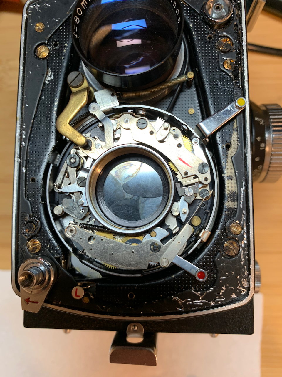

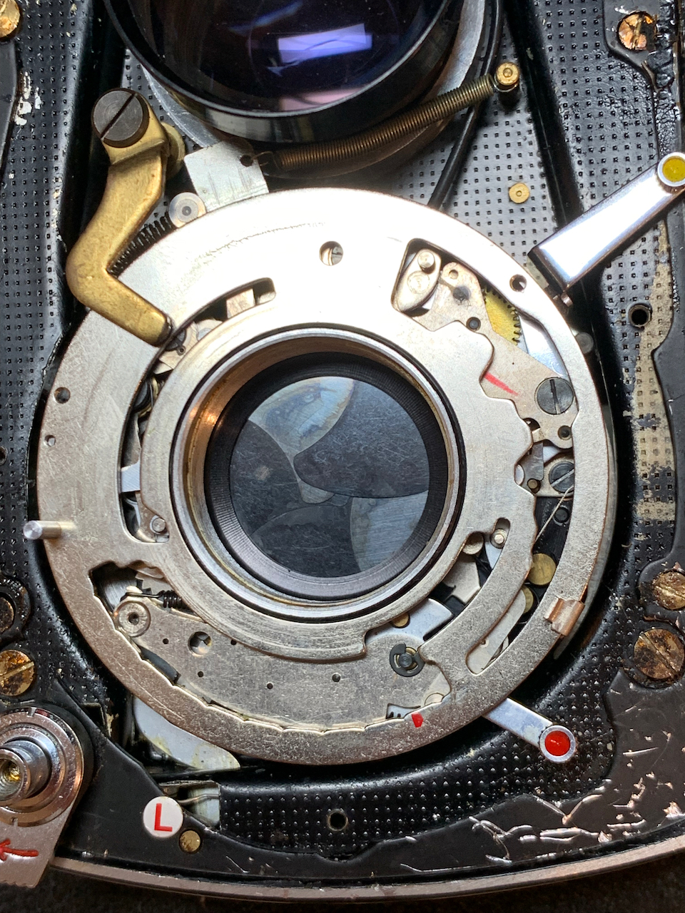

The delay timer is not running. Post a picture of the shutter with the front lens element and front cover removed. The delay timer can be removed as an assembly in most cases but can be complex to disassemble/reassemble.

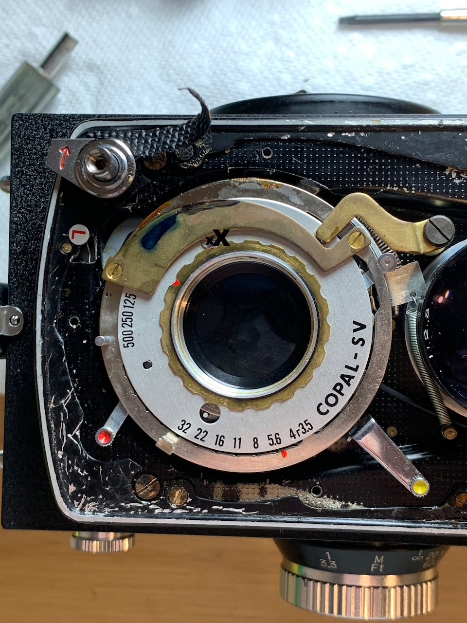

Here you go. Let me know if this is what you had in mind:
Remove brass levers at X a and X b. Remove screw at arrow 1 , its very small! Mark a starting point and unscrew brass ring at arrow 2 counting and recording the number of turns it takes for the ring to come off.
Remove plate with the speeds (larger X) then the speed ring (red dot, big X) then post a picture of the shutter.
hmmm I see a pin there, but no screw :unsure: You did mention it was small so I looked real hard... but I swear all I see is a pin! (Just want to take the opportunity to add how much I appreciate you taking the time to help me out with this!)

That center notched brass ring holds the face plate in place. The underside of the face plate has machined notches and slots in it. Too loose and levers slip out of their slots, too tight and they do not move.

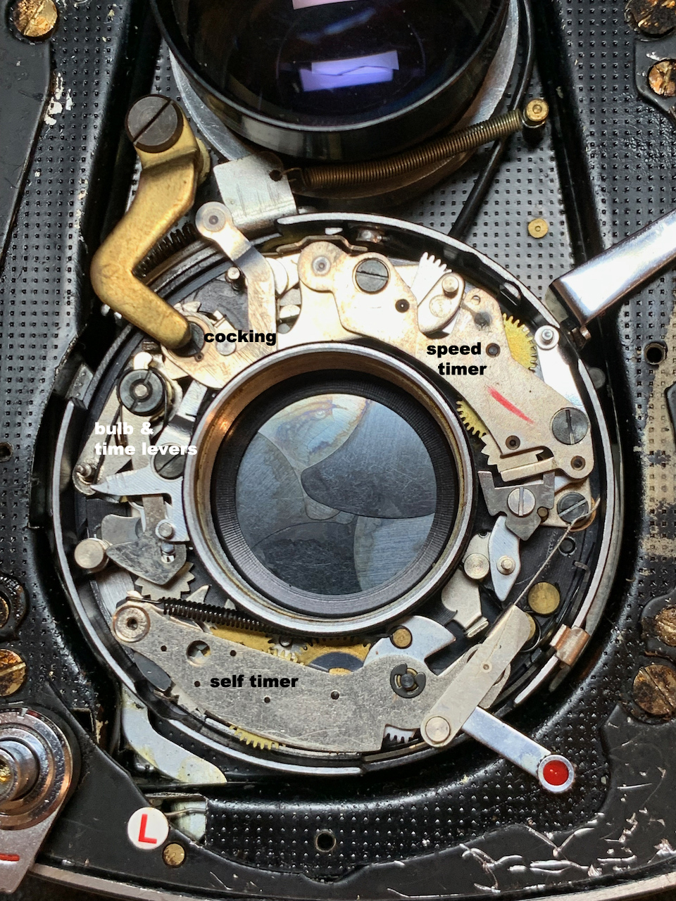

hmm ok so, this bulb & time lever seem to work as expected; if I place it on one side, and fire the shutter, it's in bulb mode, as expected, if I flip it to the other side, then it fires at 1/500... I'm not seeing the speed timer do anything :\

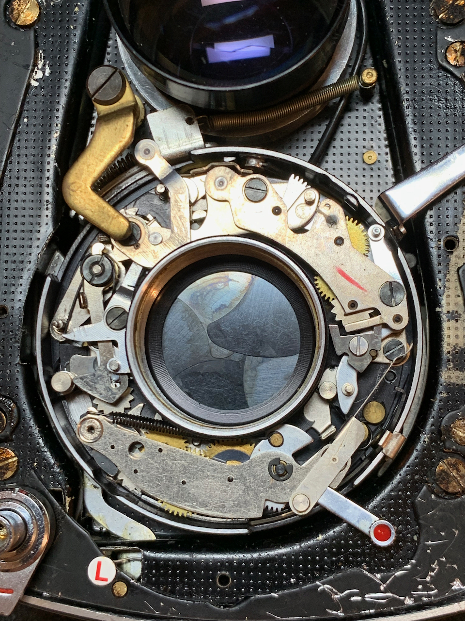

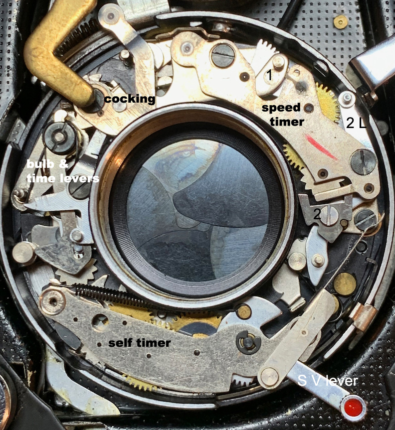

With the S V lever at S the shutter operates as set by the speed dial. With the S V lever set to V tripping the shutter starts the self timer running then after 7 to 10 seconds the shutter fires according to the selected speed.
1 is the speed delay gear engaging travel, 2 is the pallet, and 2L is the pallet tension. The gear travel coupled with the pallet tension regulates the delay speed.
Cocking the shutter applies spring tension to the mechanism and locks the shutter blades from moving.
Releasing the shutter frees the shutter blades and a weak spring flips them to full open in .00003 seconds; the delay timer (aka speed timer) blocks the shutter blades from closing for the selected time up to 1/125 then spring tension closes the shutter blades. Additional spring tension is applied for speeds above 1/125

Well, to my own amazement, I managed to fix it...all I did was add tiny drops of sewing machine oil to the speed delay gear, wherever it made sense, and move all the gears/levers a bit to distribute it. However, while the fast shutter speed (1/500 to 1/8) appear to be pretty accurate, as soon as the slow speed escapement kick in, they're all on average 2x too slow (i.e. 1/4 is 1/2, 1/2 is about a second, and 1s is close to 2 seconds). Still... progress!
Its simple, the delay timer is not running. The gear lever at 1 in the previous photo should fall to the bottom of the slot at 1 second, partway in at other speeds.

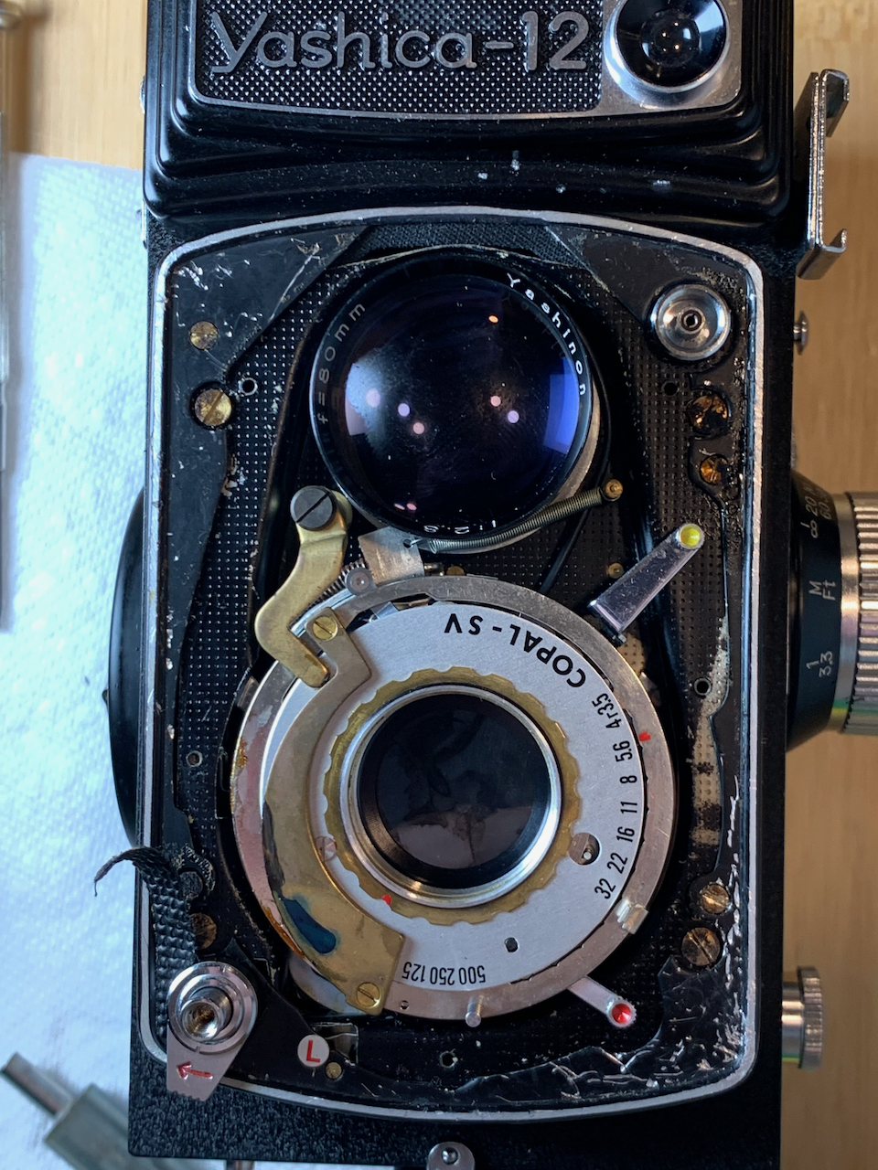

Hi, bumping this thread instead of starting a new one. I recently got a Yashica-12 that was in pretty good working condition, only apparent issue was a missing M/X lever (no big deal as long as I set it to X and leave it), and a non-cocking self-timer. The blocking lever that prevents setting the self-timer in M mode was stuck in the up position. Upon disassembly, I discovered that it was bent (maybe from someone trying to force it), carefully reestablishing the original shape got the lever and self-timer working properly again.
I measured the shutter speeds and found that they were quite good, some spot on and a couple with ~10% error, up to about 1/60 of a second. However they were running increasingly slow between1/60 and 1/500 (~1/50, 1/80, 1/125ms, 1/200). 1/60 error I can live with, but fastest two speeds being a full stop off is too much. After removing the escapement assembly, ultrasonic cleaning, and applying Horace Whitlock clock oil (with an oil pin), the results were basically the same.
I understand that at 1/125 and faster the pallet is disengaged, and from @shutterfinger's post above that spring tension sets the shutter speeds - it would certainly appear that the spring tension may be too low; any insight on increasing tension or any other way to improve the fastest shutter speed performance?
