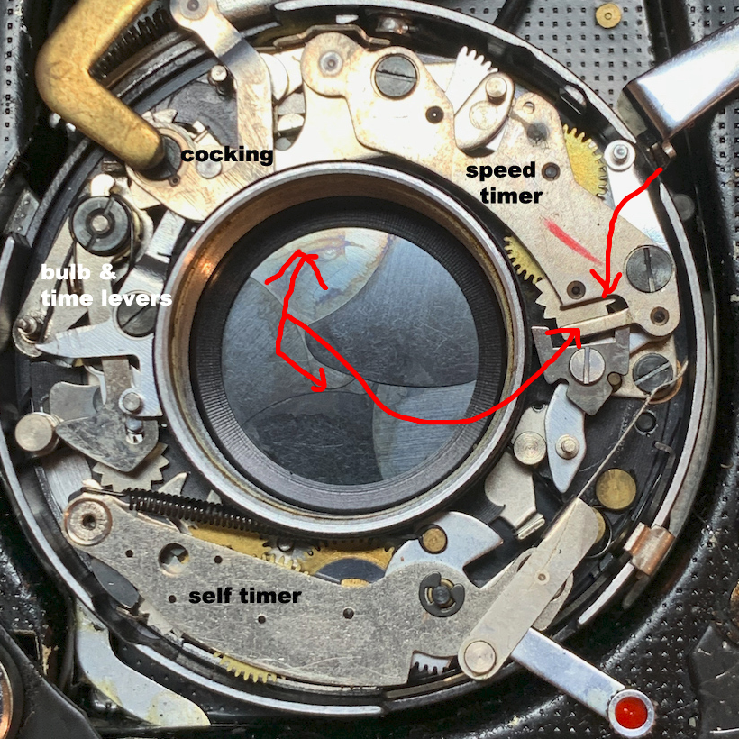

Dan Daniel
Jul 4, 2009
3,073
upstate New York
This image is stolen from post #12 in this thread. The slot and tab at the 'bottom' of the escapement affects the basic timing of slow speeds. You put a screwdriver in the slot to push the tab away from the slot. This will speed up the slow speeds. You push the tab towards the slot to slow down the slow speeds. Be gentle, patient. It won't take much bending.
The tab is the stop for the pallet as it interacts with the star gear. Moving the pallet away means less engagement and the star gear can wind down faster. Moving the pallet towards the star gear means more interaction, slower speeds.

OKAYYY I think I get it now. The spring on the
Ah excellent, thank you!
I realized last night that the spring on the cocking lever is what actually drives the escapement - the spring on the semi-circular gear inside the escapement assembly acts in the opposite direction in order to push the timing lever onto the cam during cocking.
The spring on the cocking lever appears to be adjustable but I am going to hold off on adjusting it unless it's absolutely needed. I may take another shot at cleaning shutter blades and cleaning and maybe lubricating the shutter ring.

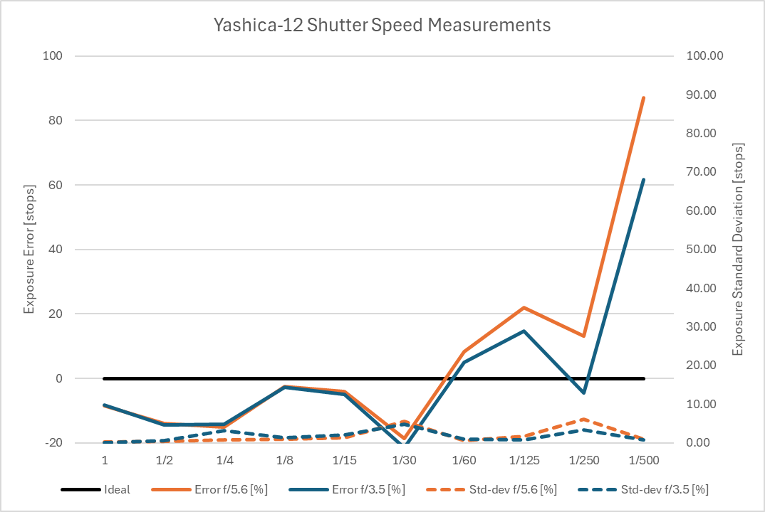

Bear in mind that "shutter efficiency" affects leaf shutters at the highest speeds. At the highest speed, the time it takes the blades to open is comparable to the overall speed. This means that the effective open time at a small aperture is longer than the effective open time at large aperture. Depending where you put the photoresistor to do your measurements, you might be measuring a narrow beam of light through the shutter and getting a slightly longer time than the effective open time for a large aperture. That's a mouthful, but basically, don't get too worried if you measure the fastest speed as a little slow.
Yup, that shows up quite clearly the way I'm measuring it - close the aperture and the same measurement points (very start of the rise in the signal and very start of the fall) get further apart (and the closing point is a lot easier to distinguish, since the shutter blades are moving quite quickly by the point they pass the mostly-closed aperture blades - same reason 2-stroke engines have such loud exhausts, but now I'm way off on a tangent).
If I cared a little more I could actually measure the change from smallest to largest aperture, which would give a good idea of how long it takes the blades to open and close, but it won't help me take better photos lol.

"Final" measurements for the shutter, 5 readings at each speed, at two aperture values, after replacing my photoresistor with a much faster response phototransistor, and with camera fully assembled.
Basically all speeds with pallet engaged are running a little fast - adjusting the pallet engagement was indeed very sensitive and I couldn't reliably get it running slower without stopping the mechanism intermittently. Still, within Compur spec for basically everything other than 1/500, and 1/30 is just barely out of spec. The consistency is also quite good. Plots are normalized to percentage (first plot) and "stops" (second plot).
