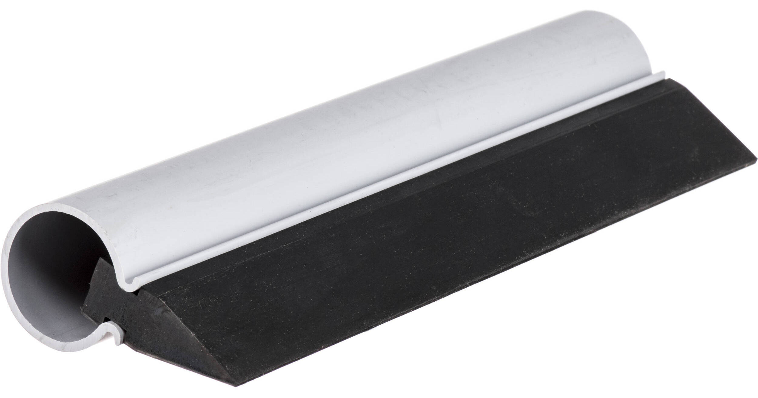

I use this squeegee:
You can save some money by going with the 9" version:
I wouldn't personally use a towel to dry prints, unless you're sure it's made from something that won't leave lint or other bits of material on the paper surface - even if you only wipe the non-emulsion side.
I have the 14 inch version, works equally well with FB or RC paper. Blotting prints with a towel? Last thing I want is fibers stuck to the face of something that I spent time making perfect, only to ruin it at the last moment.

Is it a good squeegee. That's what I'm going to buy if I keep getting different answers on ways to remove water from prints. I'm just nervous about scratching the paper.
I use a Paterson 9 inch squeegee and have done so for 17 years and if my experience is anything to go by then you have no need to worry about scratching. Simply wet your fingers, run them along the blades to both soften them and make sure there is no pieces of grit on them and you will be fine
I need to add that I have only ever used RC paper but I see no reason why if the blades are grit-free there should be any difference if it is FB paper
